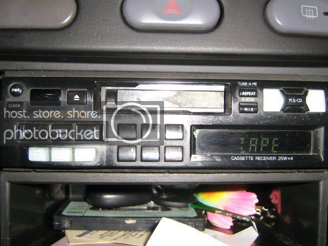

how about 4 mbus? which shoud i use? and i dunno how to set it to aux-in. this is my headunit. cmd-75xx
wow time for an upgrade there... I think your only option is a tape adapter for that old of a deck...
