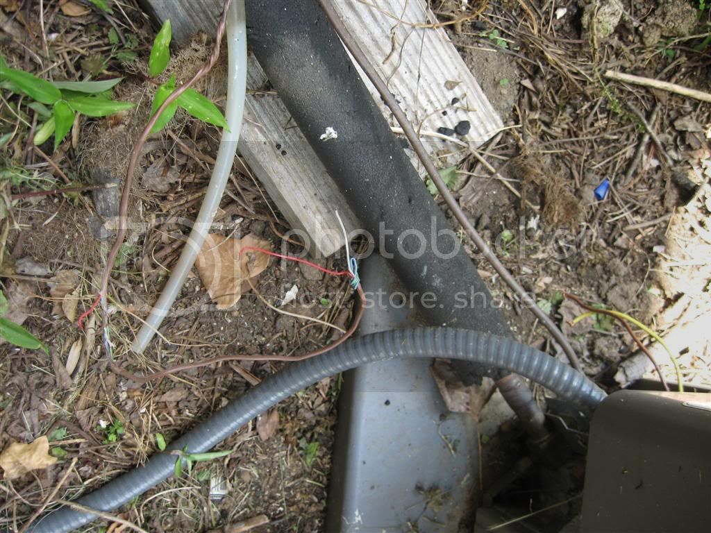

I went outside to check out the AC unit, and look what I found:
edit: It looks really ****ed up so I probably won't be touching it, but there has to be some electricians/elec engrs on here so I figure it wouldn't hurt to post it

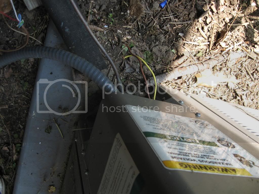

This is a picture of the whole ordeal, on the left (the big brown wire) are 4 different colored wires coming out of the house inside of the big brown one, on the right are 2 wires coming out of the AC unit (1 yellow 1 brown) that were apparently connected to SOMETHING at one point.

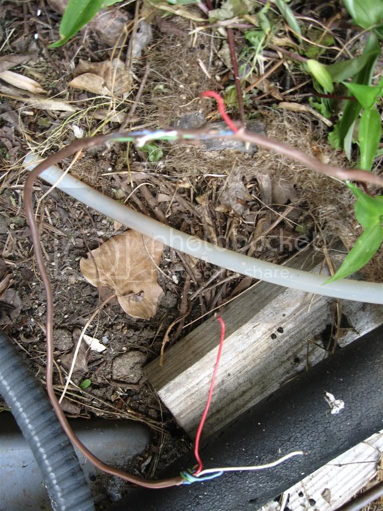

On the left side of the next picture, the red wire is frayed, and there are a couple of exposed wires (a white one, a blue one, and 1 or 2 more that arent exposed).
On the right side, there is a white and a red wire, the rest are bent back.
And here's a picture of the wires coming out of the AC unit again.
was there another unit or box that those wires connected to that's no longer there //content.invisioncic.com/y282845/emoticons/confused.gif.e820e0216602db4765798ac39d28caa9.gif
Some of the wires are bent back like they werent being used by whoever installed it, I assume kinda like a wiring harness for a cd player, but most likely no box. According to everyone at this house nothing was touched and it was working 4 or 5 days ago, so I dont see how something like that could just disappear.
