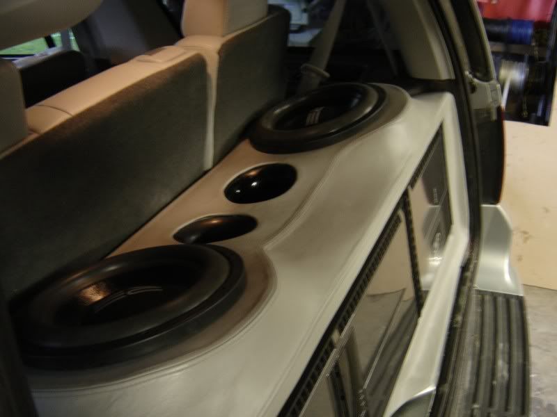

I have a single non flared 4" with a 12" and it makes alot of noise.
I would go with 6" flared for each box //content.invisioncic.com/y282845/emoticons/smile.gif.1ebc41e1811405b213edfc4622c41e27.gif
he should be more than fine with 1 4" per 12...2 is almost over kill imo..
Relatively speaking, one 4" port isn't much port area at all.
For a daily driver box, the minimum i would use for a basic 10" sub box (type-r, CVR, etc.) would be 20 sq. in. (or two 4" ports).
Not to say that one 4" wouldn't work, but i would think there would be some port noise and you wouldn't be extracting the full potential out of the sub.
My daily driver box is 1.5 cubes with 12 sq. in. of port, and i get shuffling from the port like no other.
