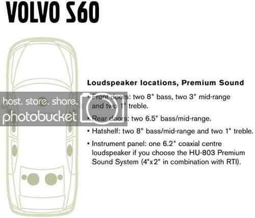

I will be eventually upgrading my speakers to the Premium speakers, but now my setup is
Center chanel 6.2" coaxial
Front doors 6.5" and 1" tweeters
Rear doors 6.5"
Rear shelf 8"
This is a pic of the Premium audio, mine doesnt have the 3" nor the rear shelf tweeters, but I'll get the front 3" eventually along with the 8" (they come together) I hope they are plug and play
Thanks a lot in advance

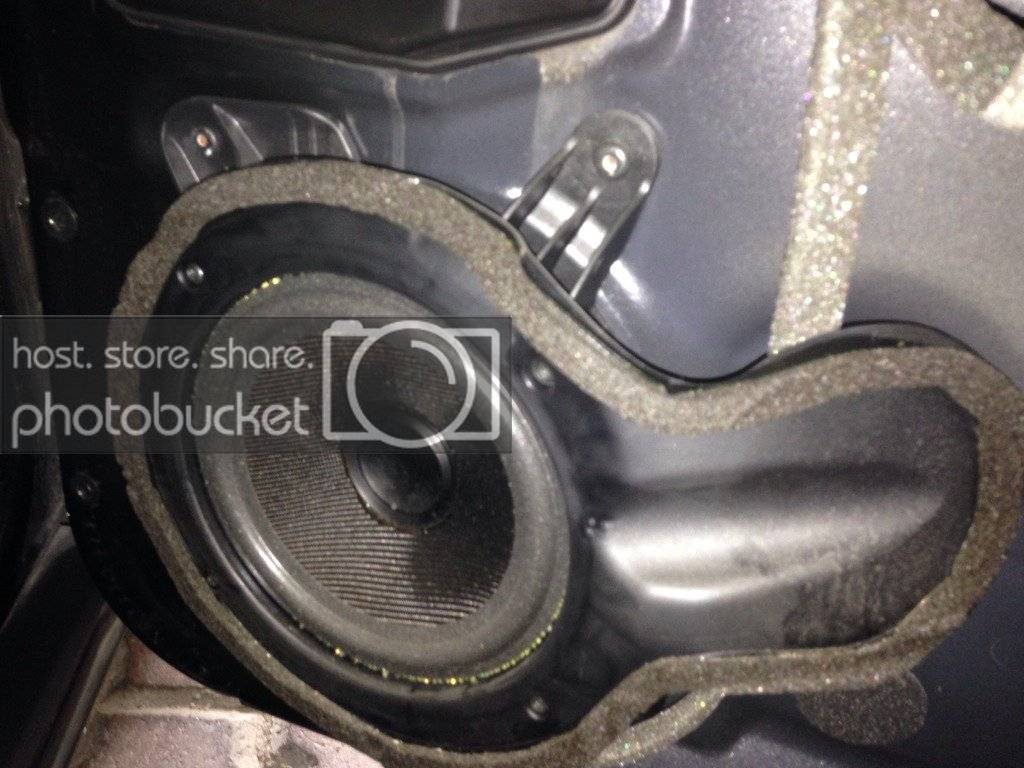

This are my front speakers, they are 6.5" and they certainly have powerful bass, but I think the 8" coupled to the 3" would perform better tan this. The 3" goes where that curvy plastic is

It is a nice setup indeed, but that is the premium audio. I just posted it as a reference.

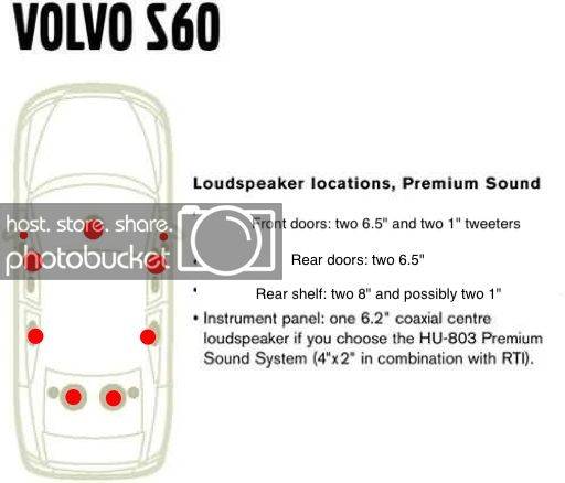

Here is a corrected version of mine, I have the high performance, which is a step below premium but quite good actually. It just needs balancing the eq but I'm not experienced xD
It doesn't seem to need a subwoofer with the two rear speakers. I can only imagine the quality of the premium setup. Anyway, here's mine
I'm gonna shine a light over the rear shelf speakers to see if there are tweeters on top of the woofers, I can't see them from below, only the woofers are visible.
I'll try tuning the HU now that I'm home. Ill tune the lower frequencies towards the rear. I'll tell you how it went using the chart and tuning the secret eq first.

By the way, the rear shelf speakers have tweeters on top of the woofers.
