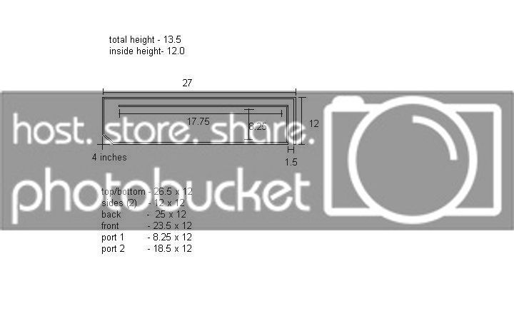

just making sure my initial plans are working out right. supposed to be 1.25 cubes tuned to 32hz. 18sq inches of port. planning for an FI BL 10 in my truck. still have to work on fitting amp racks, etc. the notch is due to the box getting fairly close to the jumper seat. doesn't touch it, but sitting in it would **** against a corner. sub displacement- .11, port displacement - .45, bracing - .20. and would it be better to lay the port out differently.
google sketchup isn't working right now for some reason. had to use paint.
thinking about increasing port area to 24 sq. inches, instead of the 18 in original design. opinions. too much port area? i usually don't stray too far from the 12-16 per sq. foot rule. wondering what would happen if i did a little over that.
