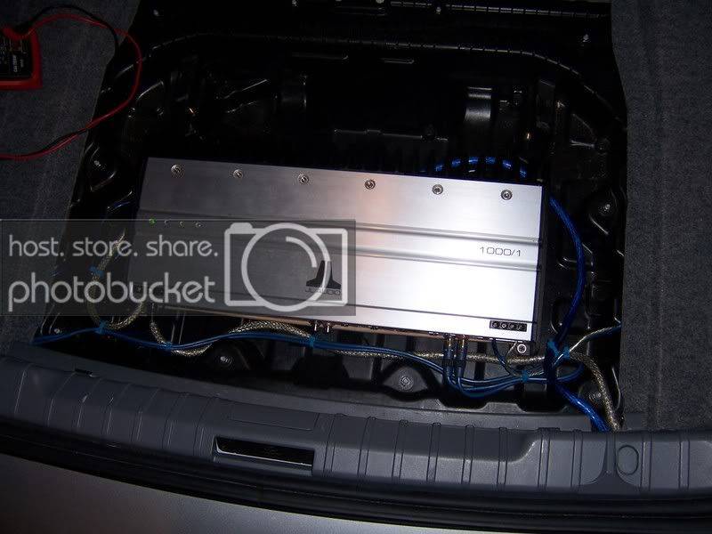

Heres a couple pics that might help, just do it like I did in this car...
Just make a false floor that outlines the entire floor of the trunk. Make a top panel for the floor, and a small bottom panel to screw the amp to. Then make sides around the bottom panel, attatch the bottom with the sides to the top, have hole cut in top for the amp, and throw it in there, toss the box on top of that.
The only thing that may kill this idea is space. If you dont have the height to work with then your sol, then you might have to get into the spare tire well or get into some glassing.
Hope that helps, lemme know if you need anything else.
