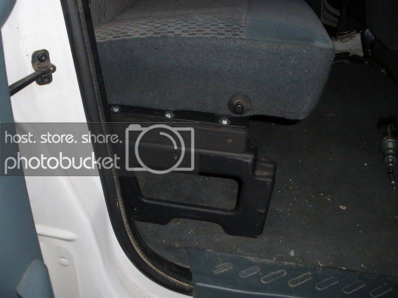

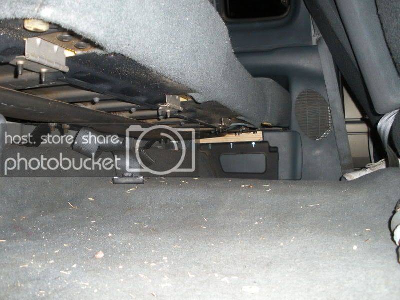

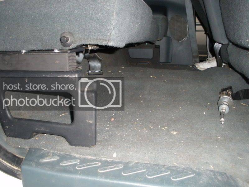

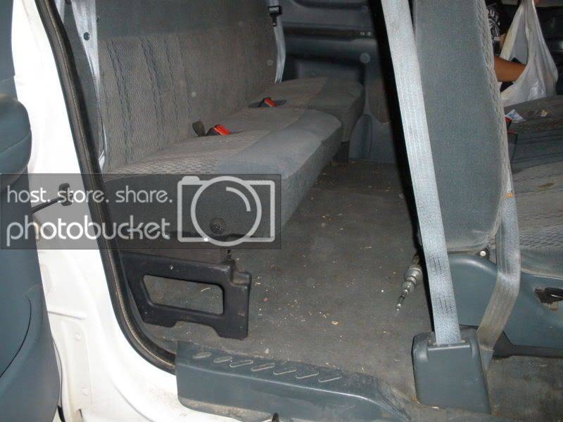

These pics are of the custom seat lift i made, it will hep accomodate a higher volume box without sacrificing the entire rear seating.
and YES IT WILL BE CLEANED!! lol
Yep, When i do installs i dont like to take any sort of Function away from a vehicle, i like to have the customer be able to use it the way they always have but have some extra "bump" at the same time //content.invisioncic.com/y282845/emoticons/smile.gif.1ebc41e1811405b213edfc4622c41e27.gif
how sturdy are them wood seat blocks??? dont get ny wobble or nything with it being bolted to the old seat bracket
Nope not at all, there is two bolts that hold the seat to the back of the cab under the rear window which helps prevent any wobble in the seat
