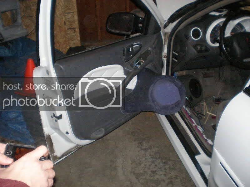

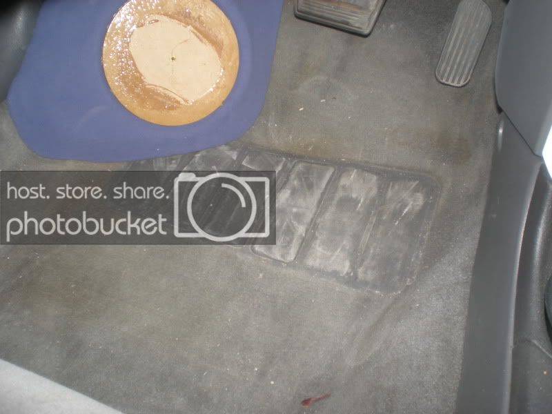

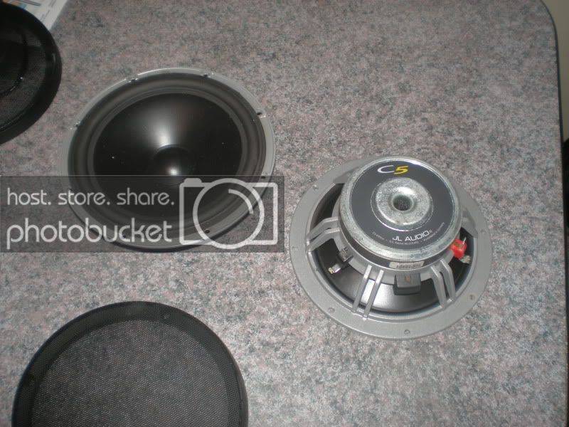

the reason i'm goin to run 8's with 6.5 comps...is because i already have the 6.5's...i realize 4" mids would be more ideal but i running with what i got...
the crossover pionts that im thinking is ,
sub 60hz
8's 60hz-300hz
6.5's passive with tweets 300hz up

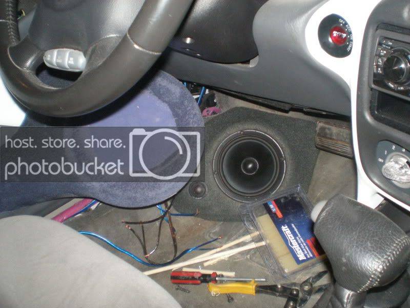

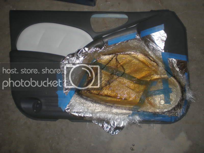

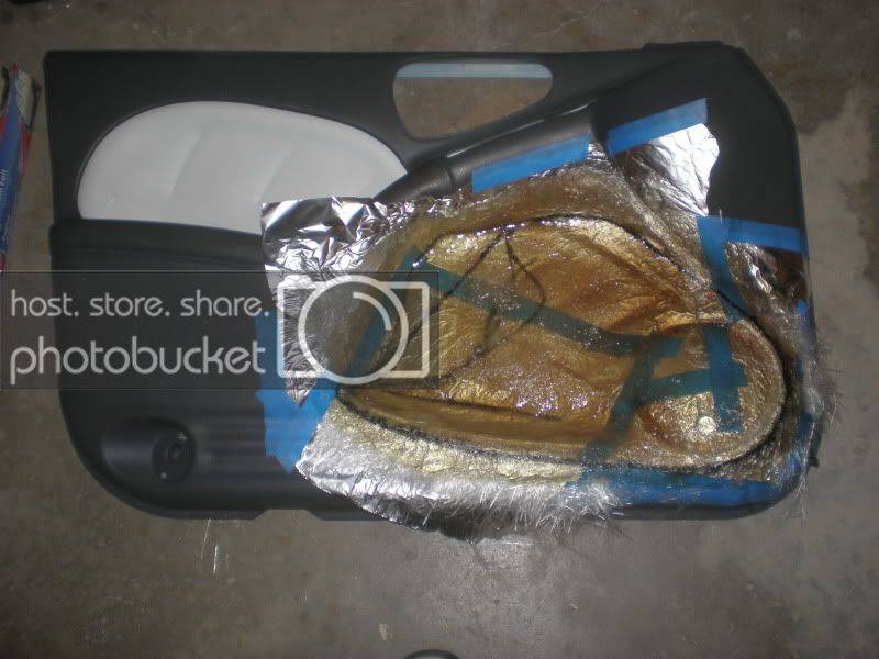

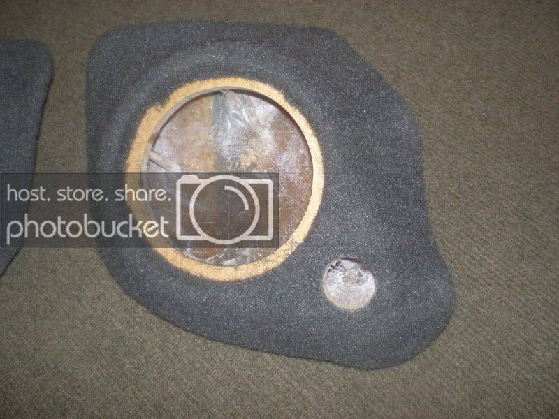

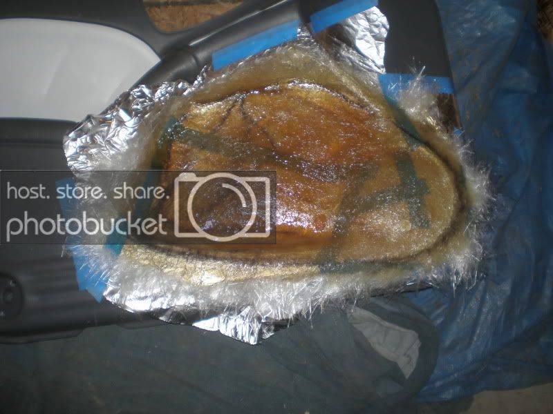

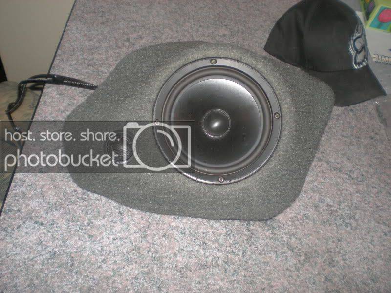

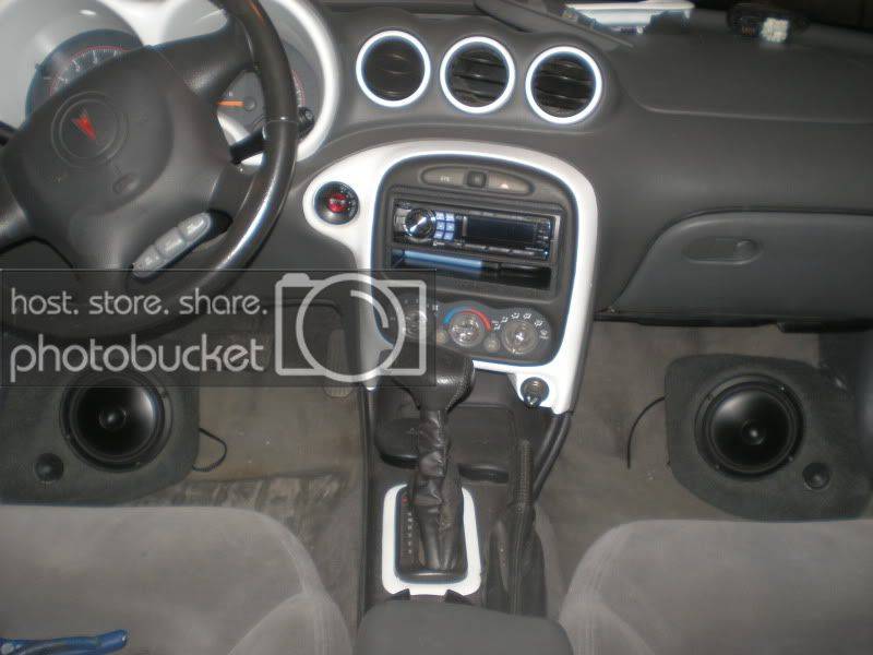

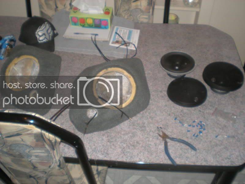

went grey all we had at work and i figured the rest of my interior is grey sooo... yeah..be taking the speakers outta the door tommorrow night and given the pods a listen., i hope they sound good

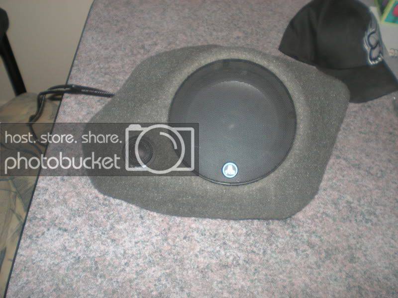

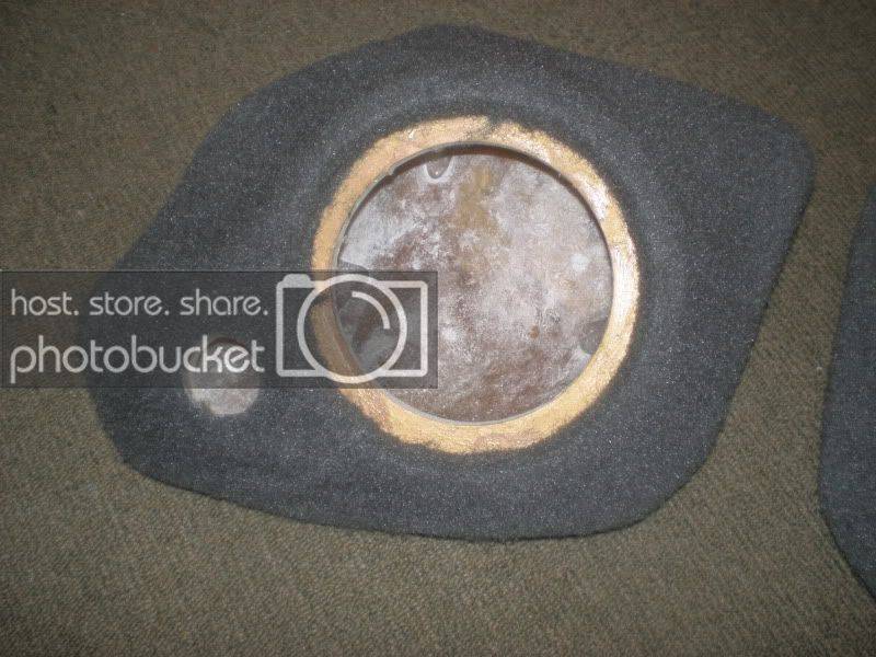

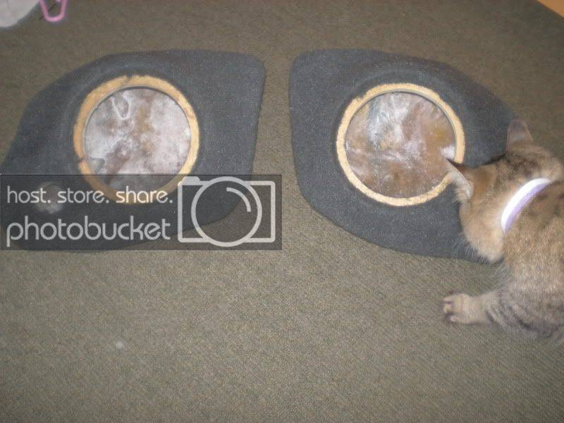

pods are now done... just slpaed them im there thats why the wires are showing, will be re-wiring another time...

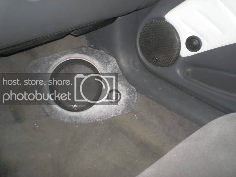

they sound awesome when high pass is set to 160 or 200. an lower and it's way to much mid bass, it end up make the speakers sound muddy...
guess thats why i planned for 8's lol....just goin to be a bi+ch figuring out how to do them.
