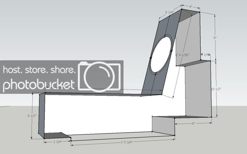

B bopo668 10+ year member JerryRig 225 0 tex Mar 23, 2009 #1 im looking hit the deep lows my box is around 1.2 cu ft and i dont know how or where to start as far as porting ill be putting about 500rms to them if that madders could some one help me out on the porting Click to read more...

thegreatestpenn 5,000+ posts lazy genius 9,487 40 columbus Mar 23, 2009 #2 u could put the port where that 6 1/2" wall is. a nice 3" aero would work nicely, maybe a 4" if you're ballsy.

dappa5 10+ year member DO WORK! (if u can) 1,858 0 S.W.FL Mar 23, 2009 #3 Penn is right port on the front wall use th port calc to determine length http://www.psp-inc.com/
OP B bopo668 10+ year member JerryRig 225 0 tex Mar 23, 2009 Thread Starter #4 yeah thats where i was planning on porting it would you suggetst 1 3" ,2 3" or a 4"
