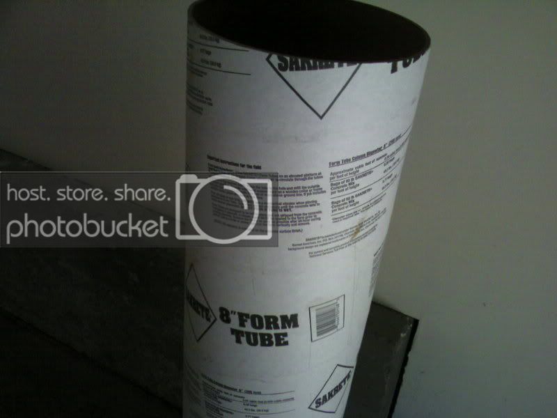

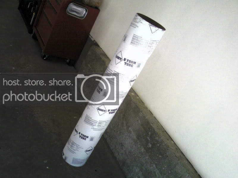

8" Cement Form Tubes
Just put mdf on each end and put the sub in one and an aeroport in the other.
