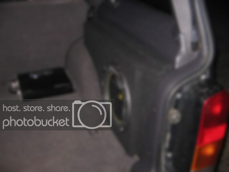

I am just limited on room. I really want a DD 8" or a E8 but I dont know much about ports and I dont think I have the box area to put one in. Here is my space saving build.
