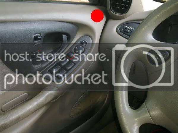

The trim covering the sideview mirror bolts are not big enough to put tweeters there. What about this location?
