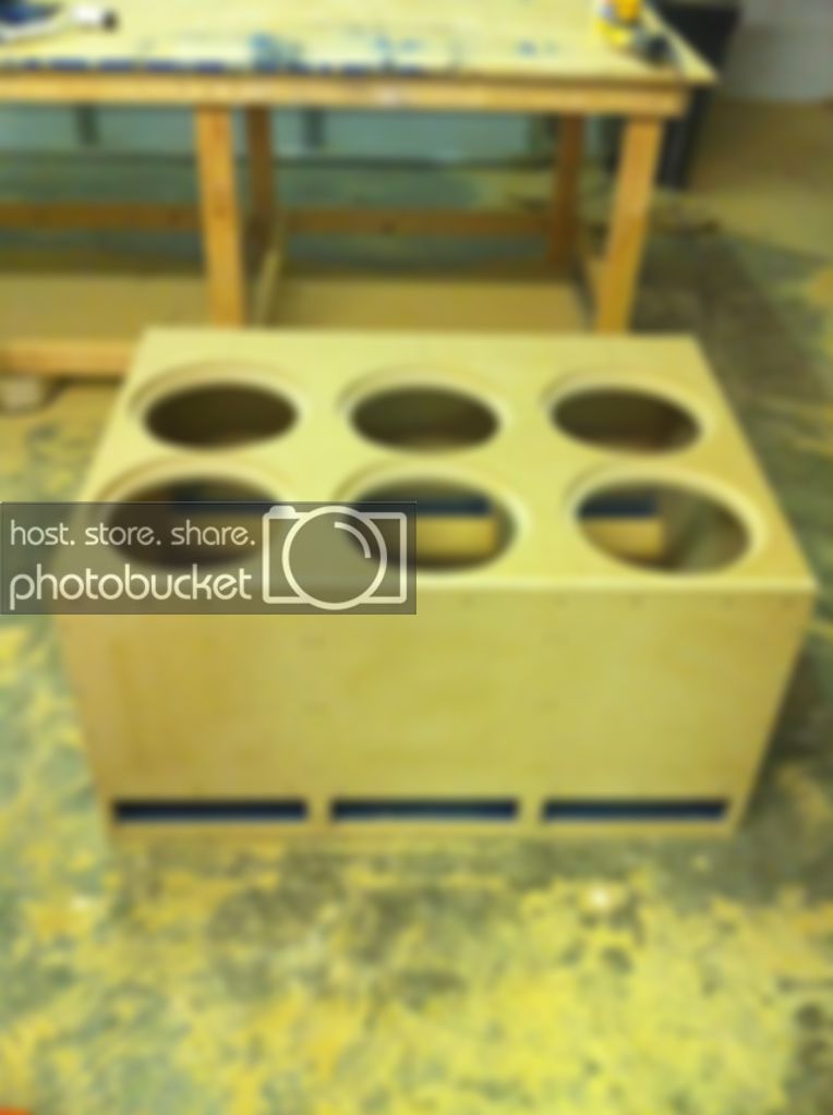

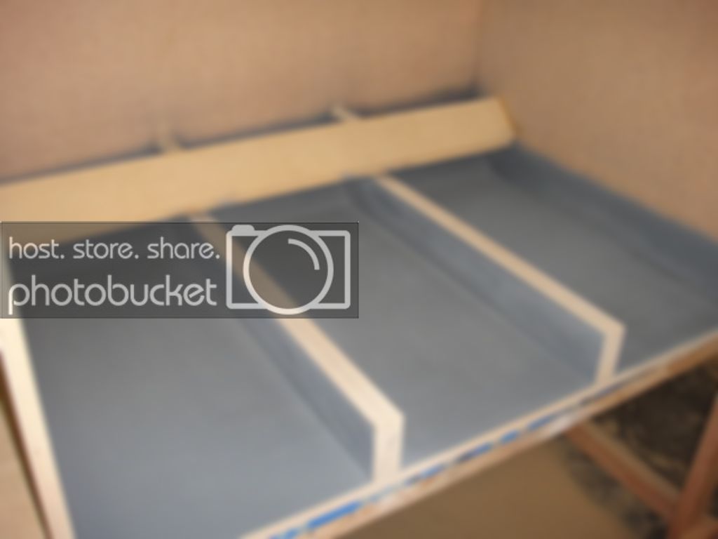

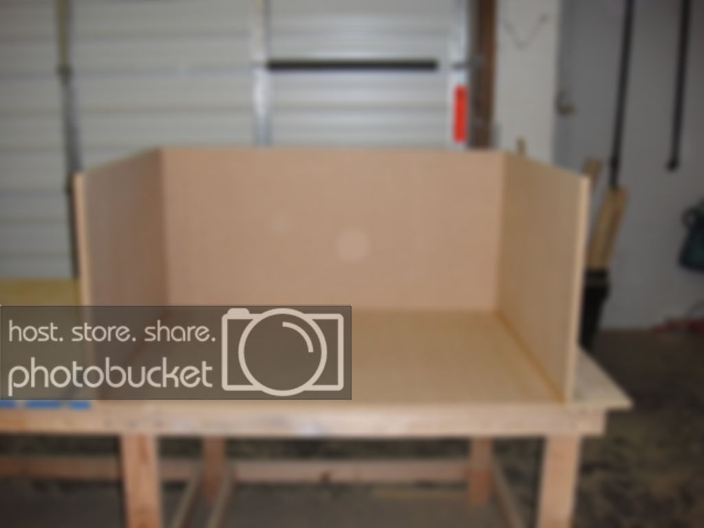

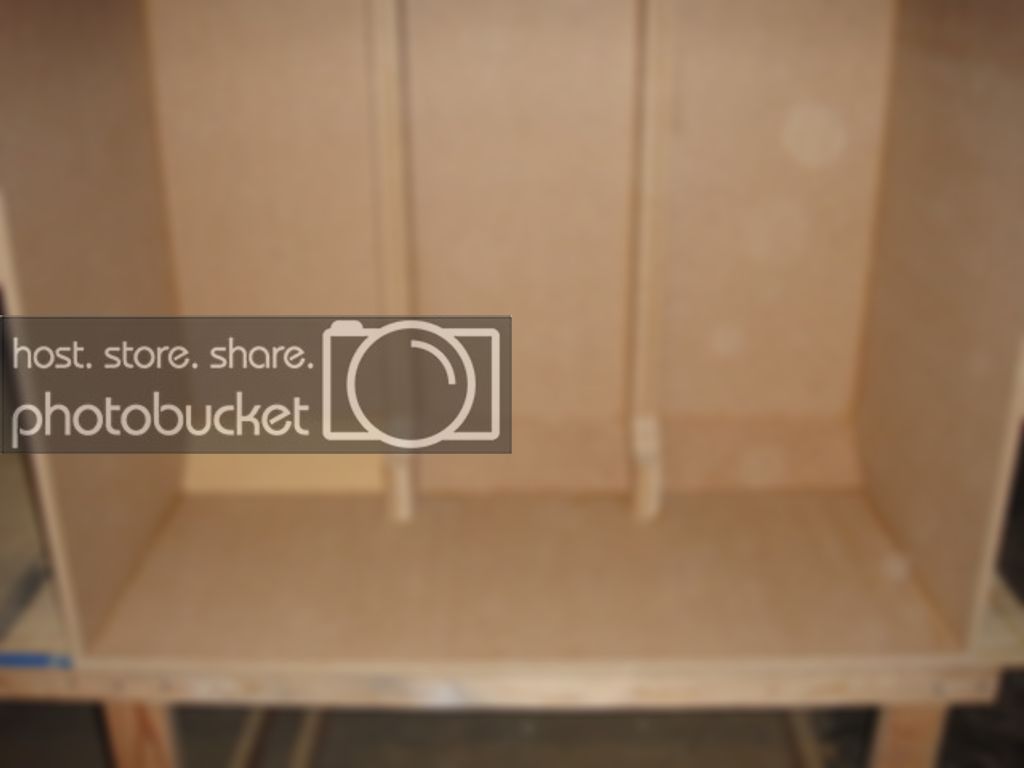

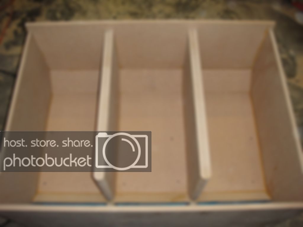

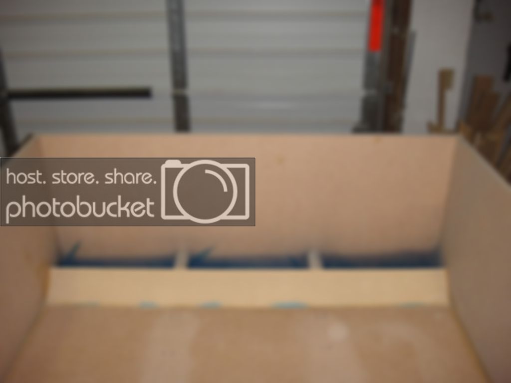

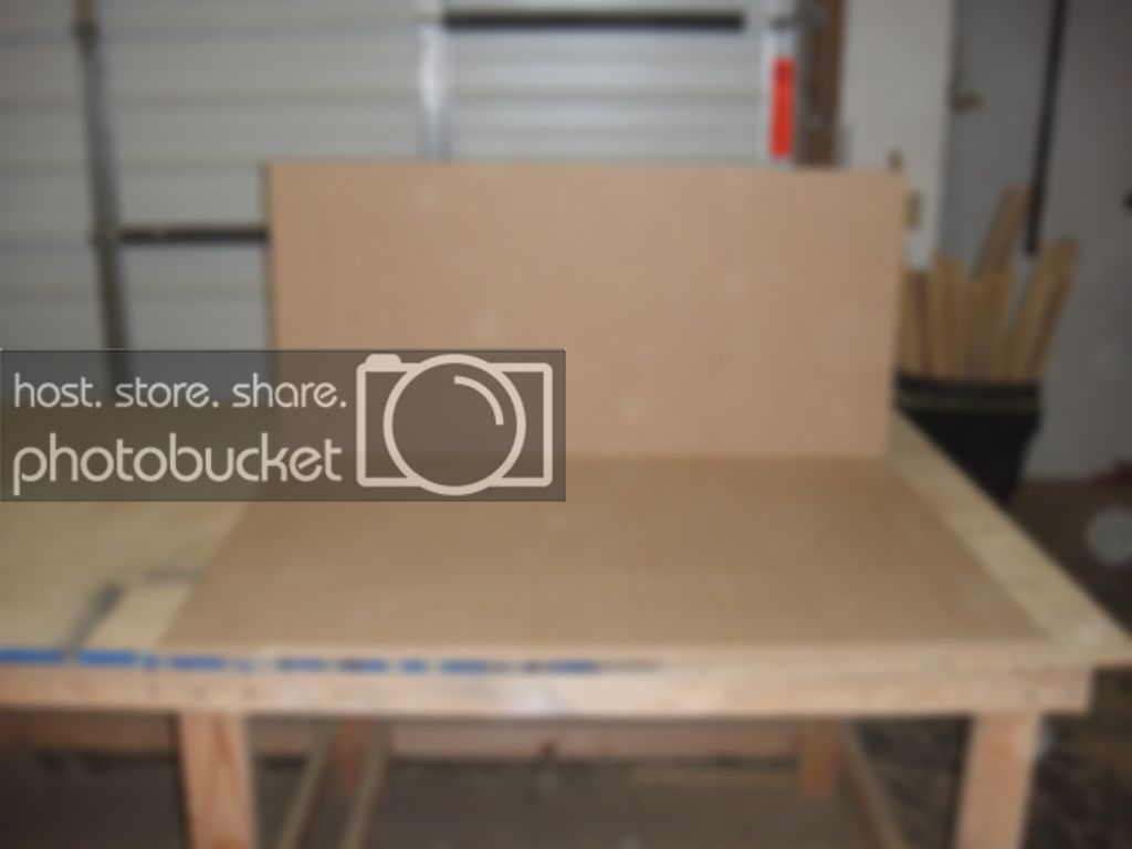

Ok everyone this box is for Scapelli21's 6 12" Sundown Audio SA-12's.
Box is 10.5 cubic feet after displacement with 140 square inches of port tuned to 30Hz.
