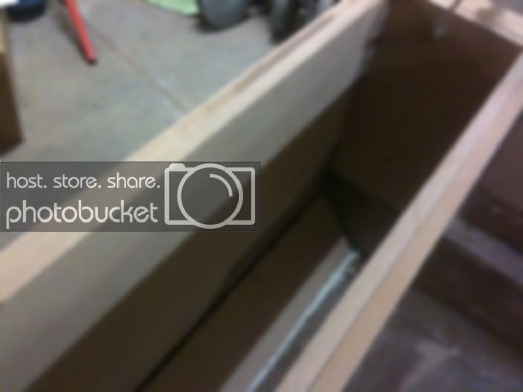

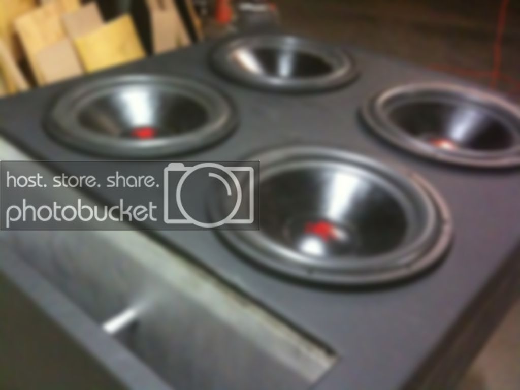

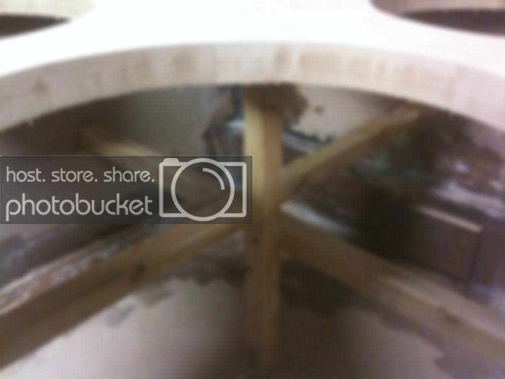

Well my last effort at getting loud. Box was designed by pioneer saturn. 22 cubes after displacement tuned to 32hz with 320" of port area. Equipment is in my sig.
Was going to do the BP with 3 but chickened out //content.invisioncic.com/y282845/emoticons/frown.gif.a3531fa0534503350665a1e957861287.gif so I grabbed a 4th sub and seen a few explorers with this type of setup that had good results so I went with that and hope I'm happy //content.invisioncic.com/y282845/emoticons/smile.gif.1ebc41e1811405b213edfc4622c41e27.gif

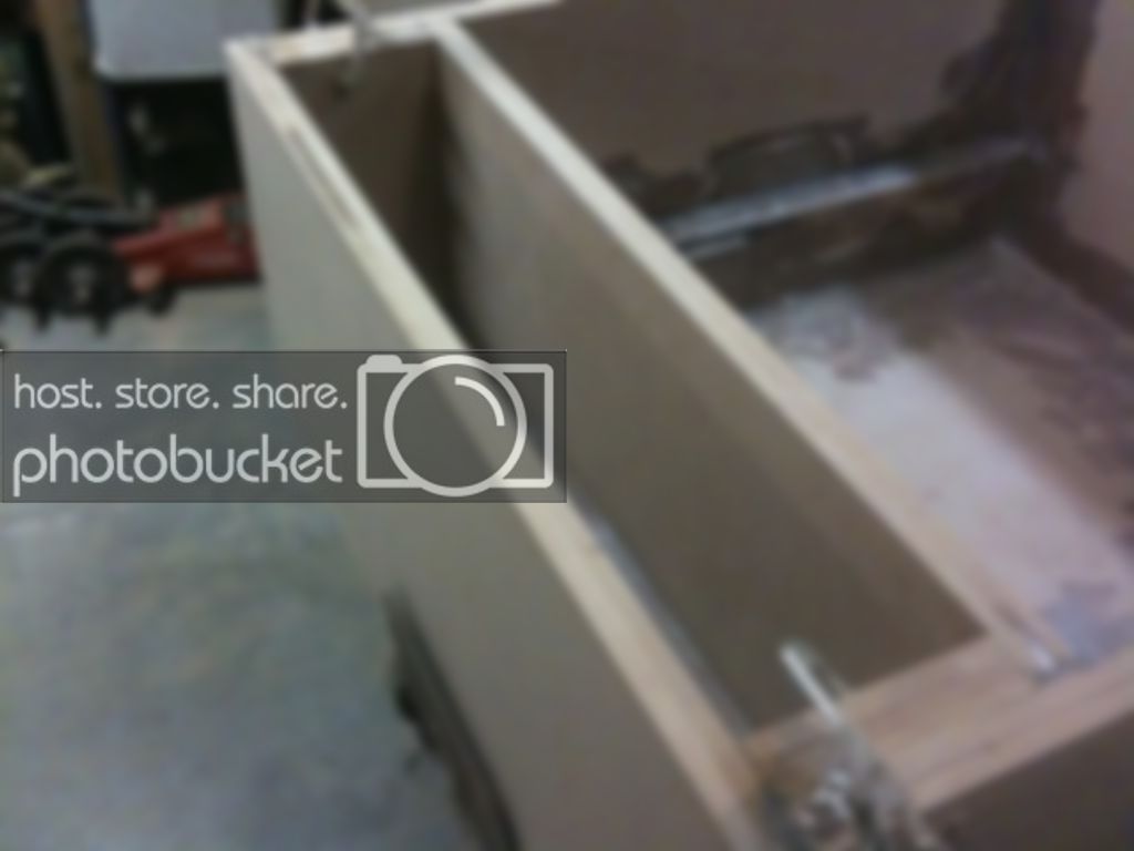

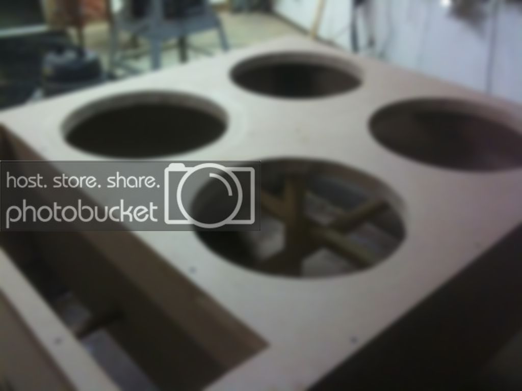

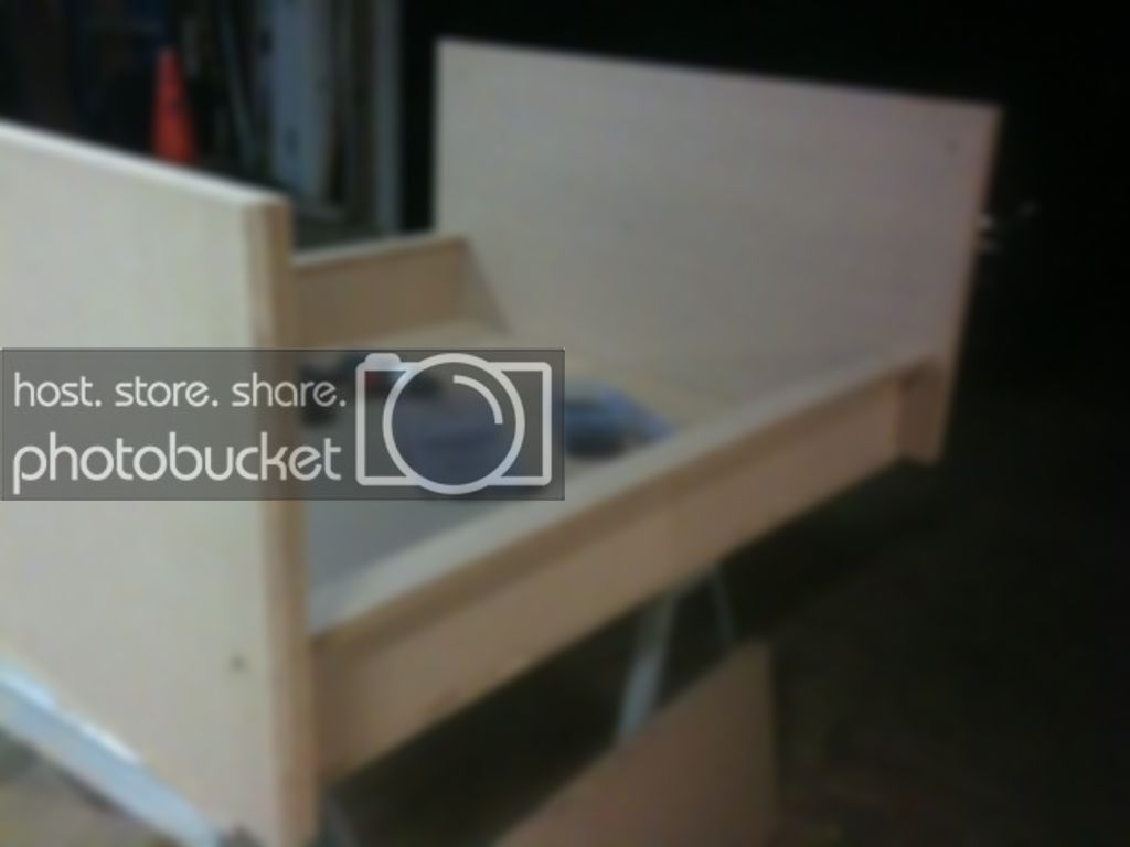

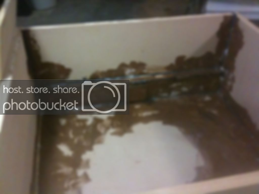

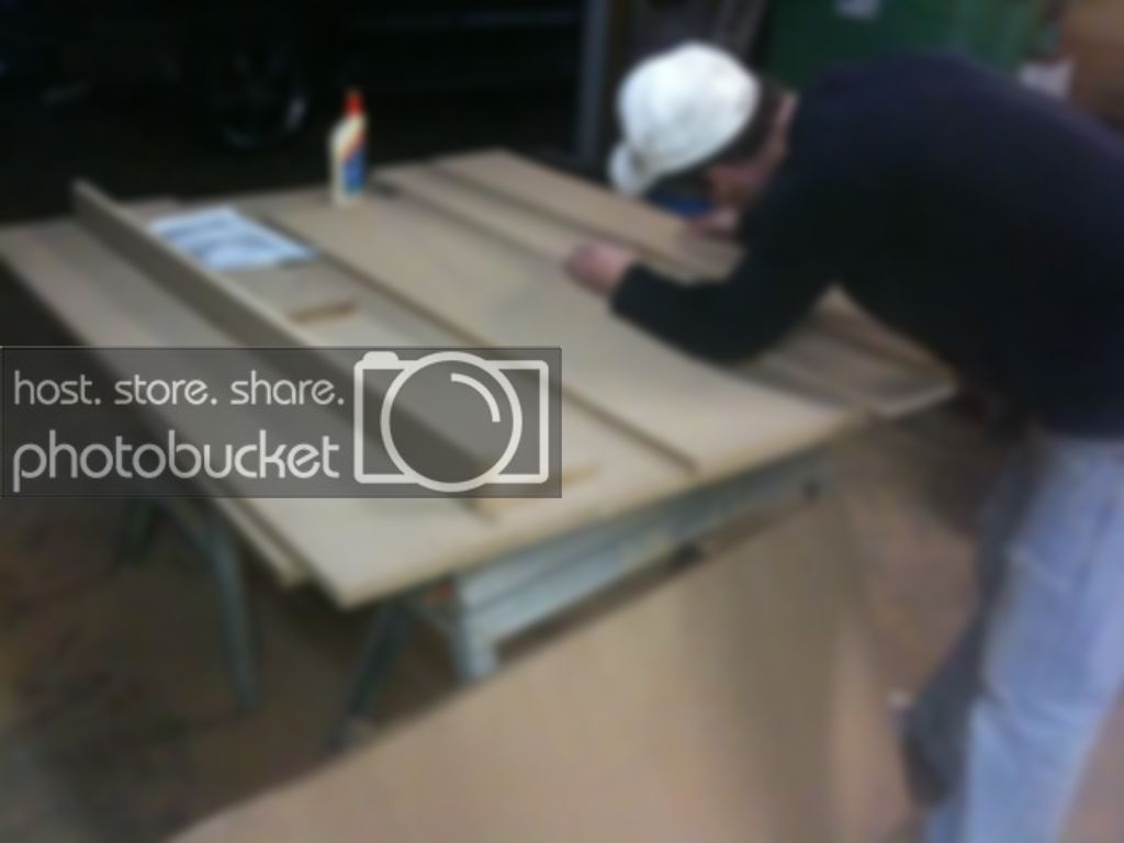

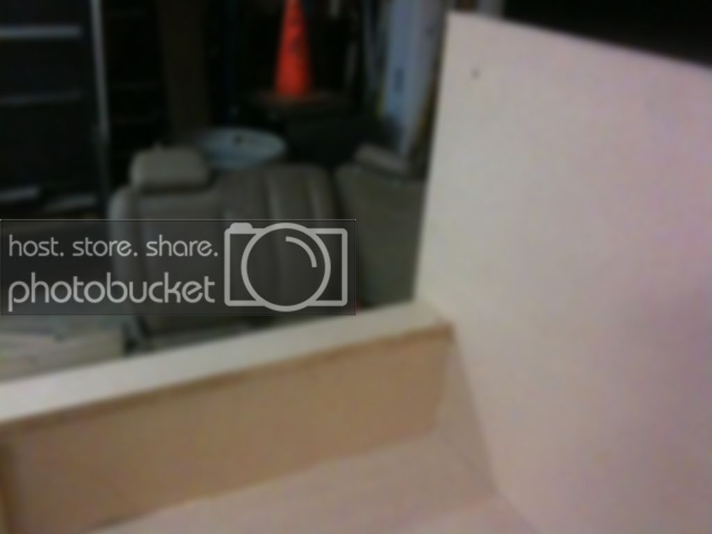

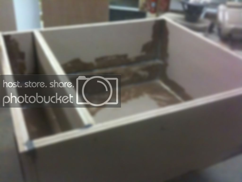

Cool, I'm excited. Got ALOT done today. Reconed a sub, took my backseats out, and got pretty much the whole box done other that putting the baffle on (it's cut) and sanding and finishing it.
Looking Good! Love seeing other Explorers with 4 18s //content.invisioncic.com/y282845/emoticons/smile.gif.1ebc41e1811405b213edfc4622c41e27.gif
Haha for sure //content.invisioncic.com/y282845/emoticons/smile.gif.1ebc41e1811405b213edfc4622c41e27.gif went with this design due to your setup. So hoping I'm atleast similar cuz I like yours alot.

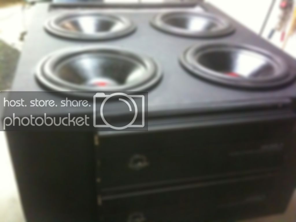

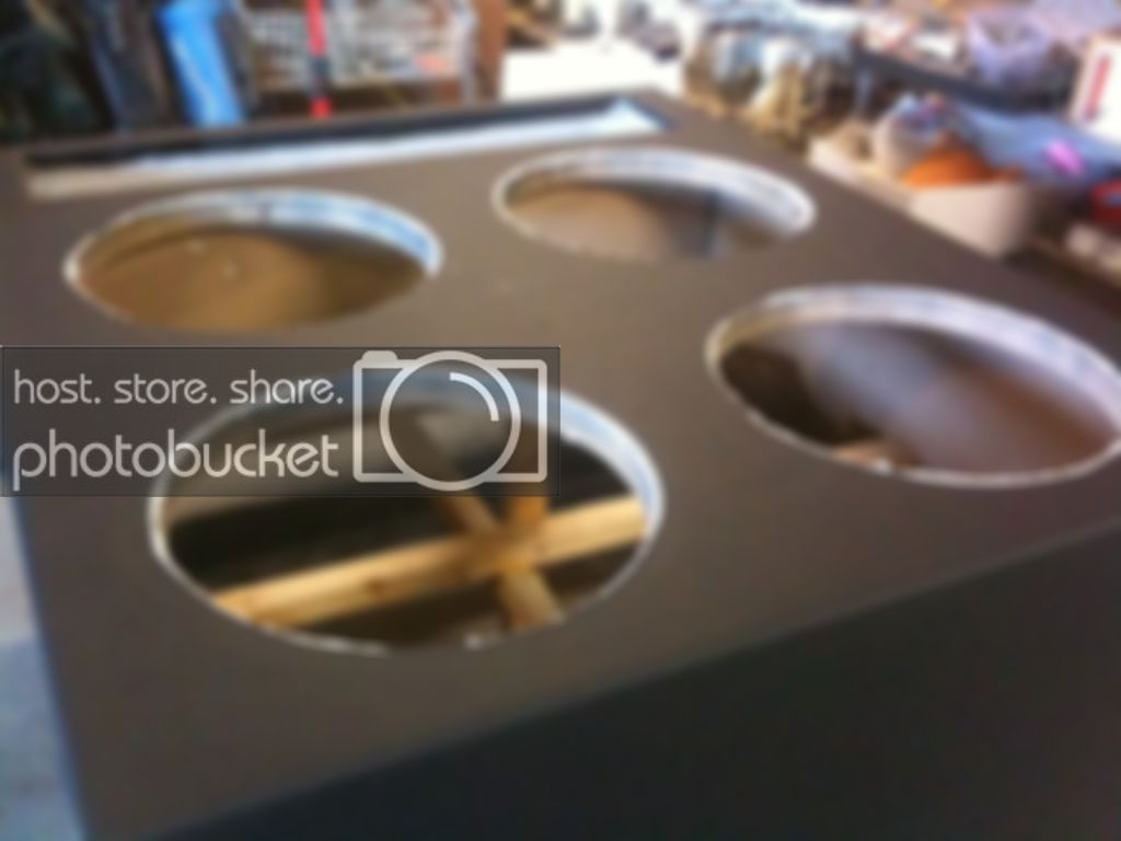

Almost done. Battery box done and they are wired up. The subs are wired up, just need to connect the amps to the batteries and hook up the mids to the amp. Box is in and was HEAVY!!!!!
