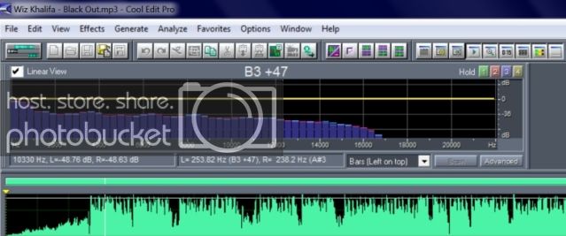

Not true, ALOT of music has the bass at 0dB or really close to it. I just picked a RANDOM track from his music and look at the frequencies....
