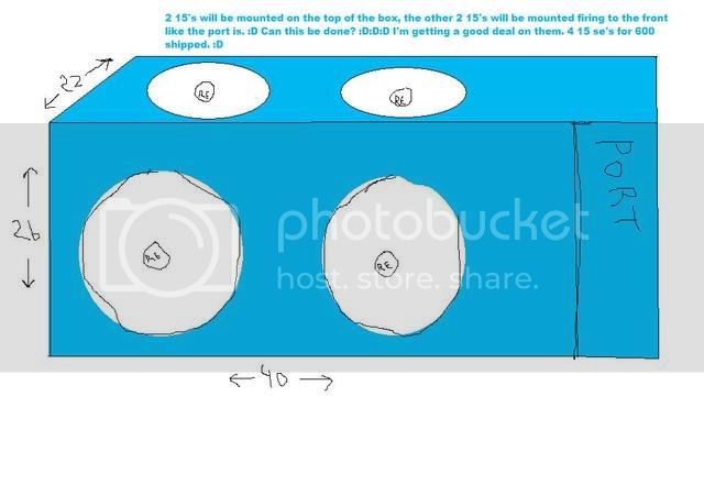

Can I do 4 of those on that much space like this.//content.invisioncic.com/y282845/emoticons/veryhappy.gif.fec4fed33b4a1279cf10bdd45a039dae.gif//content.invisioncic.com/y282845/emoticons/smile.gif.1ebc41e1811405b213edfc4622c41e27.gif//content.invisioncic.com/y282845/emoticons/biggrin.gif.d71a5d36fcbab170f2364c9f2e3946cb.gif;)//content.invisioncic.com/y282845/emoticons/veryhappy.gif.fec4fed33b4a1279cf10bdd45a039dae.gif
I got 40 wide, 26 tall and 22 depth
This is what im plannin to do.
Not enough for ported, not really enough for sealed. You would be better off running 2 15"s ported in that amount of airspace. After displacement, you would probably be around 3.2-3.5 cu. ft. per sub, perfect for each sub.
How about for 4 12's se.
Better choice. IMO
Would it be enough on that much space though? I will need to go with 4 aq 12 sd2.5's because the dude that gave me the deal doesnt have the se 12's in d4 coils, and the aq sd2.5's are d4.//content.invisioncic.com/y282845/emoticons/smile.gif.1ebc41e1811405b213edfc4622c41e27.gif would that work?
