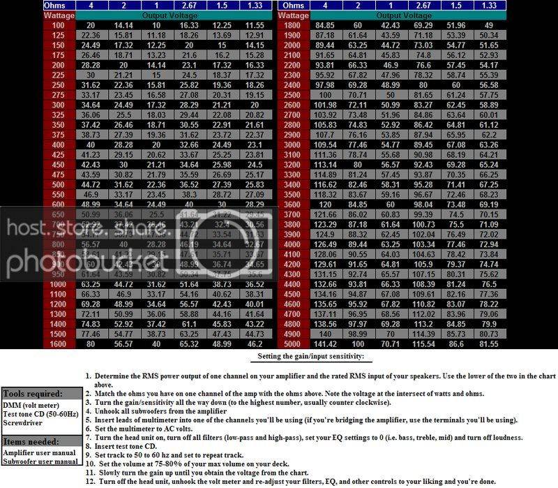

D) It would be advised to set your gain with a Digital Multi Meter to a 31.6v output voltage, which at 2 ohms translates to a 500 watt total output to ensure you do not harm your subs.

You will need a DMM and a 50hz, 0db gain test tone to set your gain.
setting the gain with a DMM is very effective in your situation
A) Disconnect the subs' wires from the amps' outputs
B) turn the system on and turn the amp gain all the way down or, counterclockwise.
C) play the 50hz test tone
D) turn your head unit up to 75% of full volume control.
E)with the DMM set to ACVolts, place the pos & neg probes to the amps' + & - outputs then slowly turn up the gain clockwise until you see 31.6v on the DMM readout..this might be fluctuating some, but you see the idea..you are getting it close.
F) Re-connect the sub wiring and have a good day....
You can research this procedure here or look at this, feel free to save and print it.
