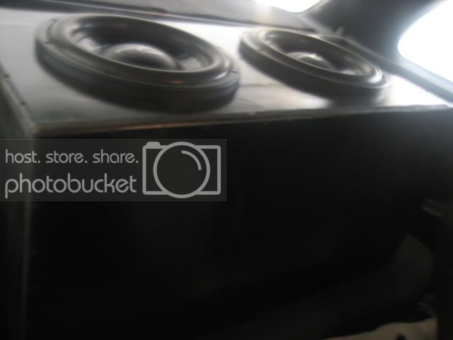

I'm planning on doing 4 FI SSD's. As of right now I have two. I was wondering If its possible to do 2 more holes for the other 2 in the same box.
The box how its in the picture is 38 long, 17 width, and stands 19 height. I'm planning on mounting the other two on the front of the box facing forward, towards the seats.
I would build a new box so they are all on one side. Air space per sub will change also if that box is already ported it won't have enough port area for 2 more subs.
That's the first thought that came in to mind when I thought of doing two more. I'm better of building a new box then. //content.invisioncic.com/y282845/emoticons/smile.gif.1ebc41e1811405b213edfc4622c41e27.gif
I have a second amp but it's a mmats d2000.05 that runs @ .5 ohms, my other amp is a mmats d2100.2. Both of them are the same, same power output etc. The only diference is that one is stable @ .5 ohms and the other one is stable @ 2 ohms. Would this diference cause any issues? etc.
if your going to drop the money why don't you do this the right way, it sounds like you just want to slam 2 more subs in your car somehow, first you ask if you can just stick them in the same box, and then you want to run 4 of them with the same power you ran 2 of them with. take the time to do it right, i don't see where you have room for 2 more unless you do a wall or unless im missing something, what kind of car is this in anyways?, sell both of your amps and buy a saz3000 or the new aq 3500 or an ia 40.1, basically something with 3-4k watts (preferably closer to 4k) and build yourself a box thats actually big enough for 4 of them, do a wall if you wanna really impress your buddies who apparently don't know shit down at the shop again, either way make sure you do it right.
depends what you're riding in. If its a sedan or something, you could build a box to house all 4, put the box in between the trunk and the rear seats, so two in the trunk, two in the back.
you will need a new box though if you plan on going higher

Yeah i think i should sell both amps and buy one that does 3 or 4k, i was thinking of the mmats d3100.5 or d3100.1.
im most likely going to wall it but i have no idea on how to do that, a big enough box will fit in though

your lucky, btw unless i missed it somewhere what side SSD's are these, 12's or 15's?
walls are cool and not THAT hard best way to learn about walls is do a search and read some builds logs from begginning to end.
as far as amps go, your going to need .5 ohm stable so the mmats are cool in that sense, but a saz3000 is good on .5 ohm, so is the 40.1, **** it there was a guy in miami selling a mmats d3000.1 for 250$ and another selling a d3500.1 for 400$

there 12's so im going with a big enough box better :]
fuc'k that cheap? wow //content.invisioncic.com/y282845/emoticons/crap.gif.7f4dd41e3e9b23fbd170a1ee6f65cecc.gif hook me up with some deals on those
all of the subs are going to be dual 2 ohms so i could either do 4 ohms or 1 ohms with 4
