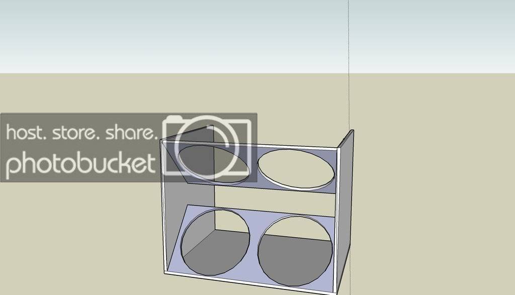

I'm trying to stuff 4 18's in a '88 Bronco II and I can't fit them flat faced, so, only option is a clam shell, and I don't want to do it sealed.
Here's is what I have so far.

will the motor hit the box with the holes for the subs so close to the edge?
Don't know, and that's why I'm in Skethcup. //content.invisioncic.com/y282845/emoticons/biggrin.gif.d71a5d36fcbab170f2364c9f2e3946cb.gif
EDIT: Actually, no. //content.invisioncic.com/y282845/emoticons/smile.gif.1ebc41e1811405b213edfc4622c41e27.gif
But, I would invert them if need be.
well how much height/width/depth do u have for the actual square enclosure? so u can figure out what angle the sub will be at aposed to how much port area u are going to need.
If that sketch is using your max dimensions, I would scrap the 18's idea and go with 4x15's. Those baffles look like they'll fold.
The holes count the outer dimensions of the woofer, so I couls see if they would fit width wise.
I have for dimensions:
34 Tall
42 Wide
And between 40-32 Deep.
I didn't want the wall all the way up to behind the seats, but If i need to I will.
Bracing is planed for the baffle's.
2x2, All thread and double layered.
