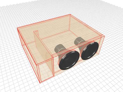

Thinking a normal enclosure facing cabin with two 12s. Should I consider 4th order? I'll have enough electrical to support like 8k RMS.
I am having trouble deciding between an aeroport facing the wheel well in the trunk or slot port facing in the cabin.
Looking for subs, amp, and box options. Biggest enclosure I can fit is about 5cf net (38W x 13.75H x 30D). Willing to give up the small back seat for amps/bat. 2010 Mazda 6.

My MAX dimensions are 40W x 13.75H x 33D this is without including the speaker surround sticking out or terminal cup.
I will have a Singer 390A and CES 40AH of LTO (80 if needed). So I should be totally space limited not power or money limited.
Aiming for highest SPL between 28-40hz peaking at ~32hz. Really want to be able to hair trick.
My current plan:
2x Sundown Zv6 12" DVC 1 (Would love to go with Fi Neo series but I don't know if they would be louder)
Sundown SFB-13500D
37.75W x 13.75H x 31.39D (Would like to stick to similar dimensions to this)
Port: 6.5x12.5", 81.5in2, 33" long, 32hz
~5.25ft3 net after all displacements (Thinking maybe I should step down to 5ft3)
