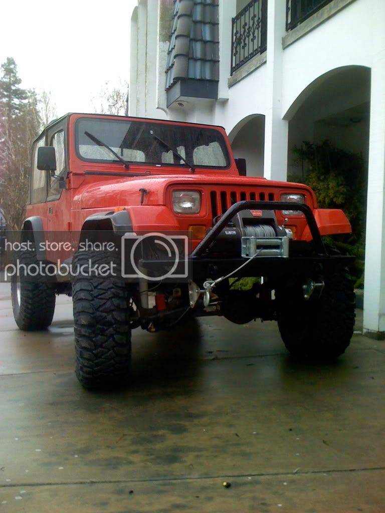

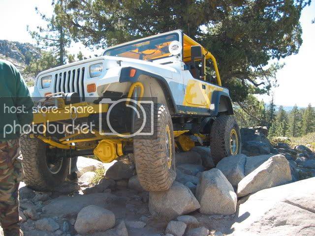

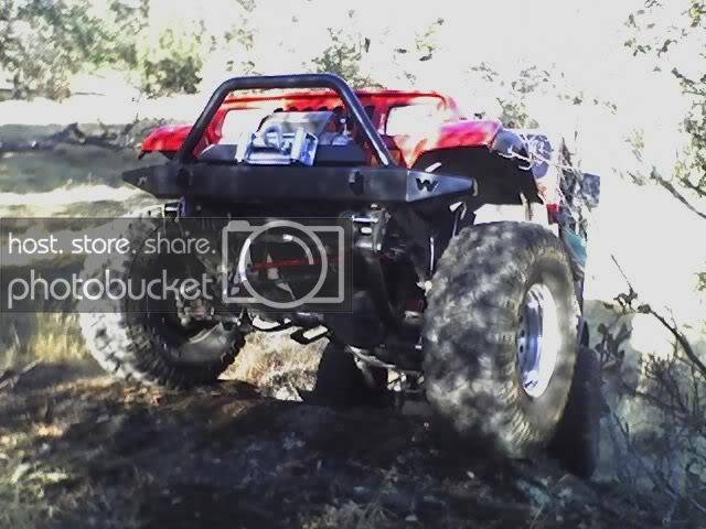

here is mine, below is my gf's dad's, but thats a whole different story. and this isnt the everyday car, if you are wondering why i spent money on a stereo for it. it has no stereo at all. no carpet, just two seats, two sticks, and a dash.
