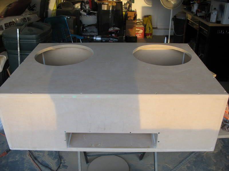

heres the back of my single 15 box
You really aint gonna see much differance between 2 and 3, all your gonna do is give up more room and need more power for the third one. Really aint worth all the work and sacrafice...
+1
his box is like 7.5cuft SEALED hitting 148-150db
Hmmm...... 148-150 sealed with 3 or 150-155 with 2 ported........Hmmm. You might as well fold down your back seat to keep them under the window.

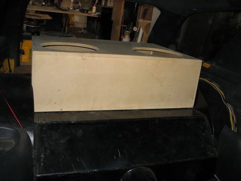

From this angle it doesn't look like it, but it is right at the window line. 153.9 with 2 RL-p 15"s.
