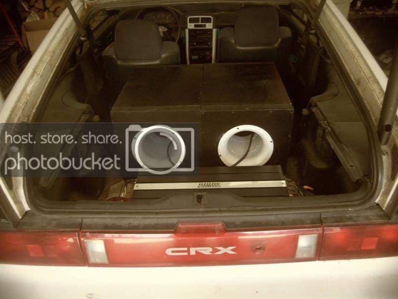

port view, one sub per box firing forward

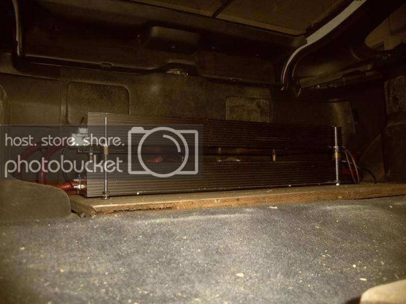

amp stackin'

Whoa, that will be one skinny port. The width of the back wall ports will be 1.08" wide (27.5mm), but the front port will be shared by 2 subs so...

Assuming the box is made of .75" MDF the 12"x20"x15" box is 1.5 Cu Feet. The 33"x19"x15" is 4.3 cubic feet, something is not right here. JL has...
