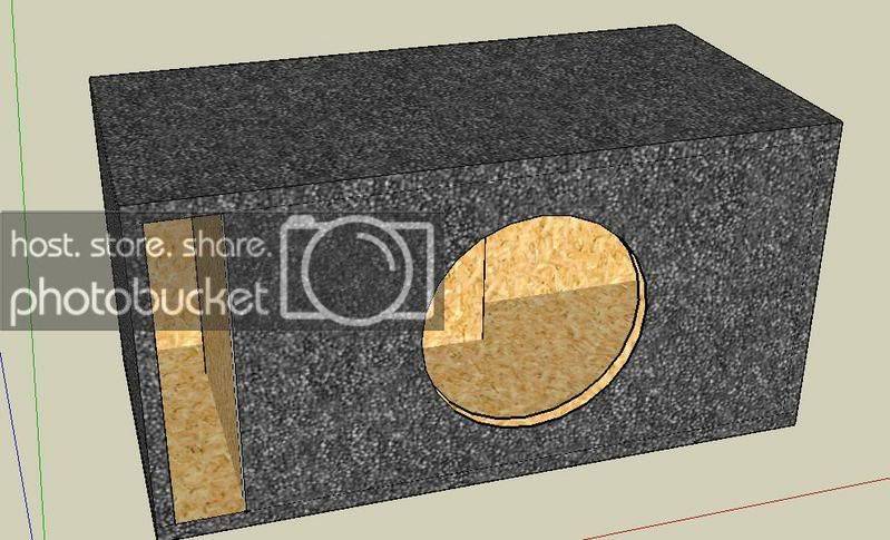

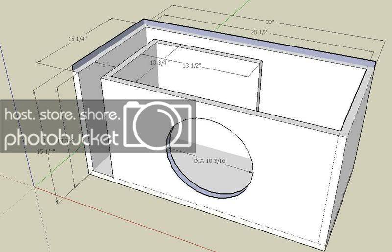

alright guys thanks alot...i ended up sketching up the design for the 2.25 @ 40hz
here's what it'll look like finished...im hoping to do it this weekend if i can walk a lil better....stupid dirtbike wheelies haha...got my leg all casted up but that isn't stopping me from hearing my bass lol
