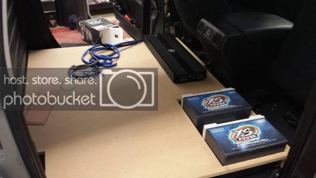

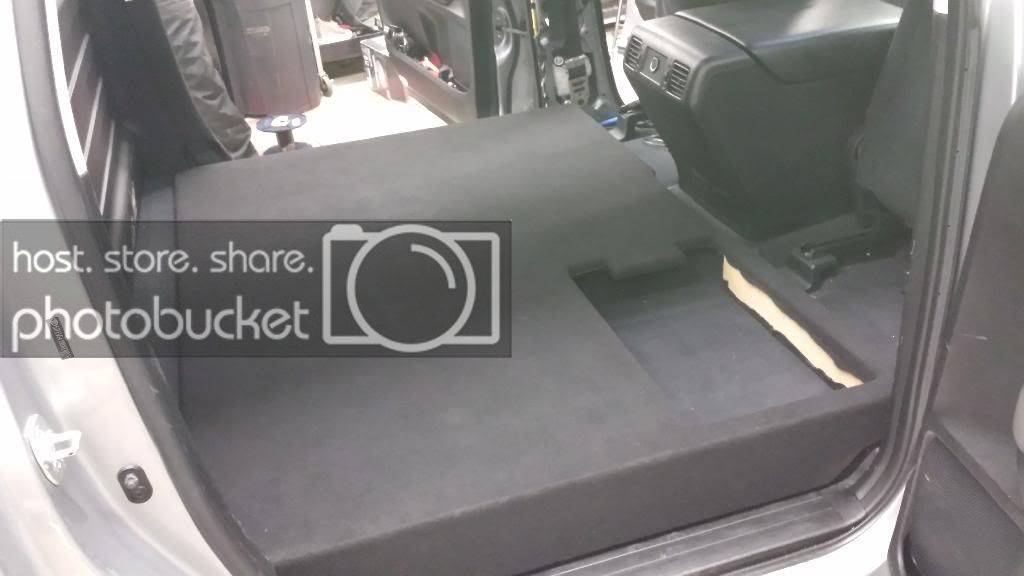

First, the false floor layout and test fit.
Rounded over, braced and wrapped black.

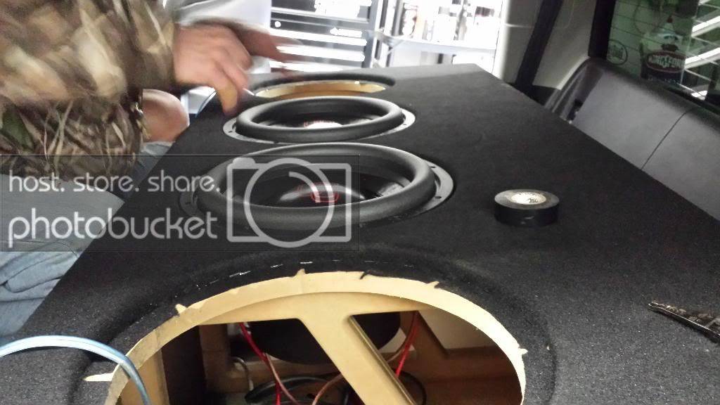

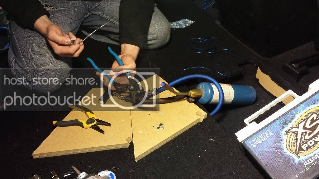

Nick and Jay got on wiring everything up. All power connections are solder/heat shrinked.

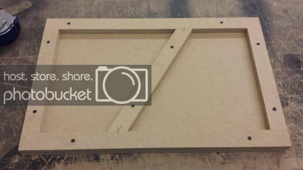

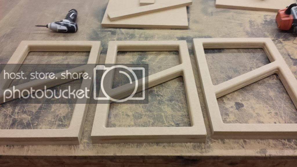

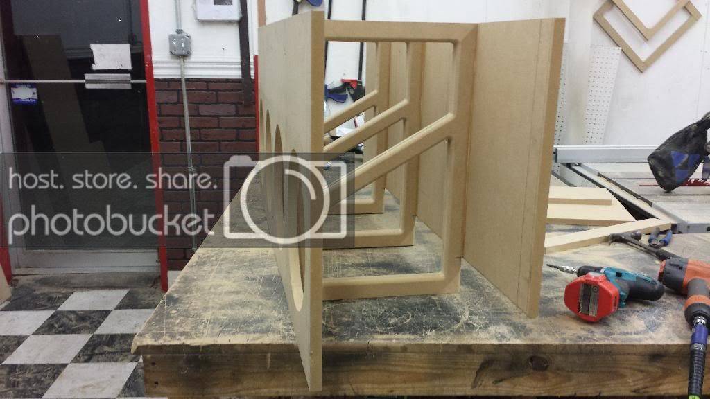

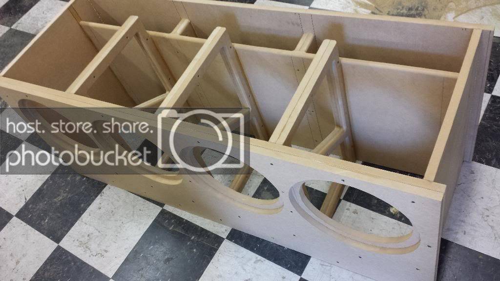

I went on to build the box. Here is a jig built for internal bracing.

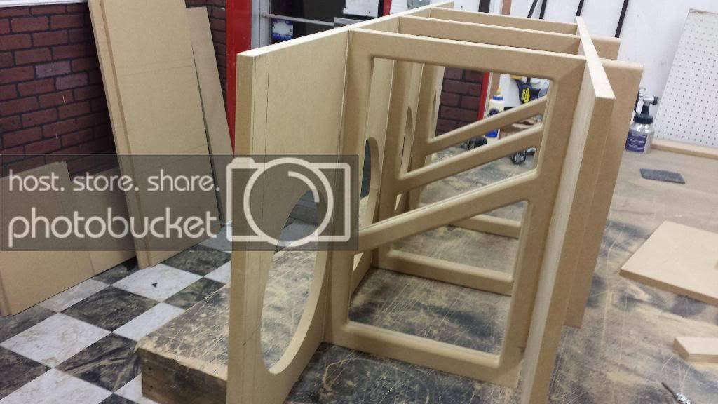

The internal braces after a little router work.

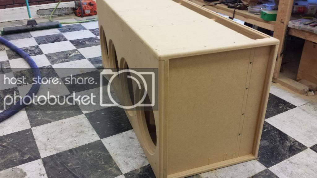

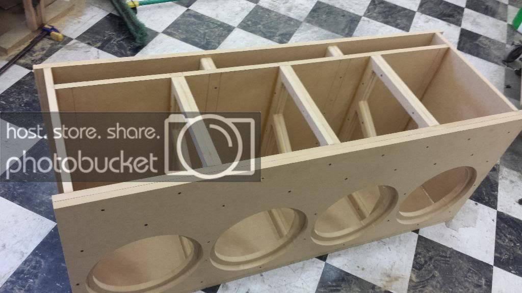

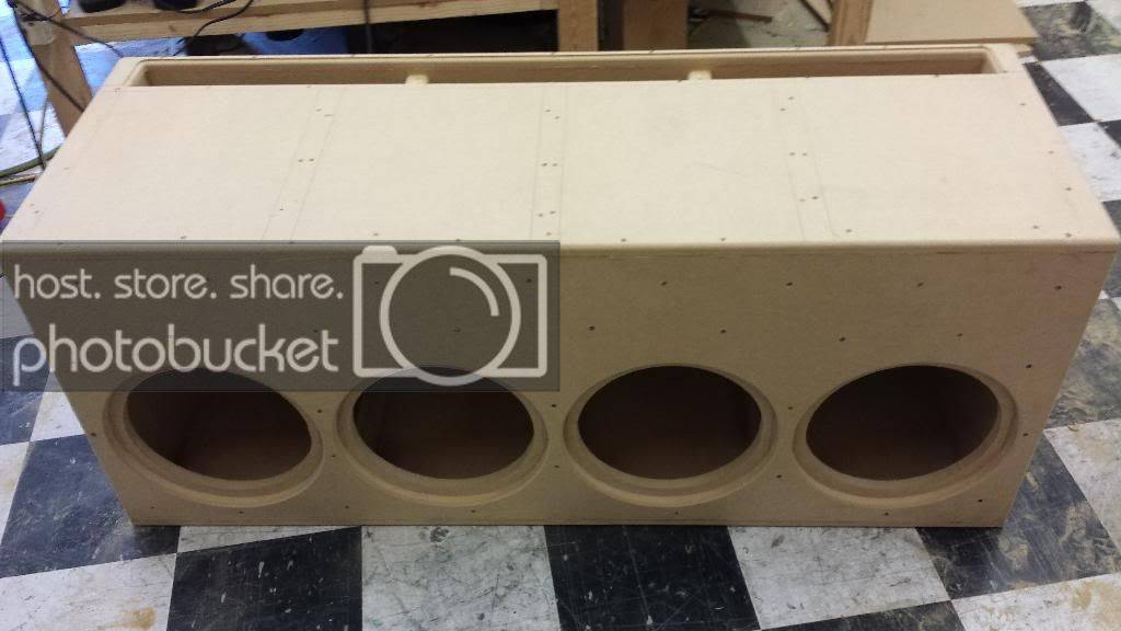

Beginning of the box.

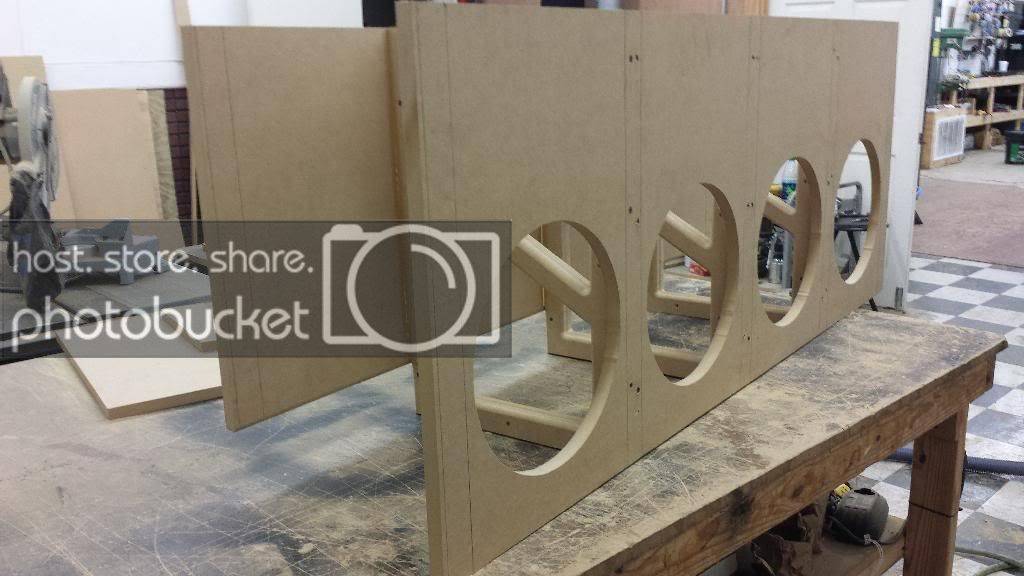

Braced heavily and all rounded over.
More bracing.

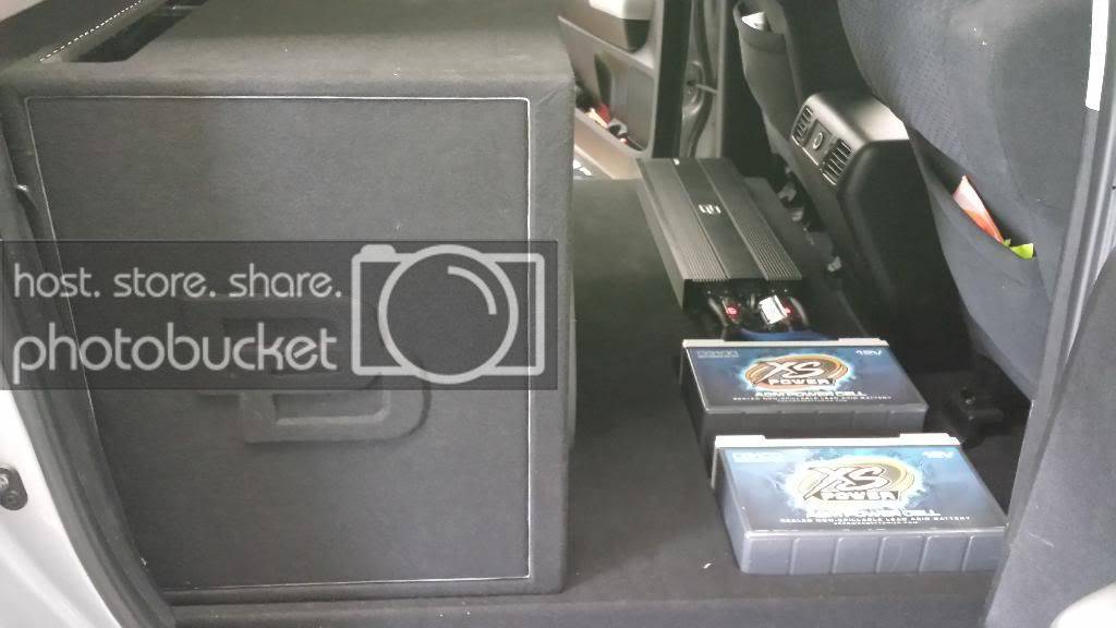

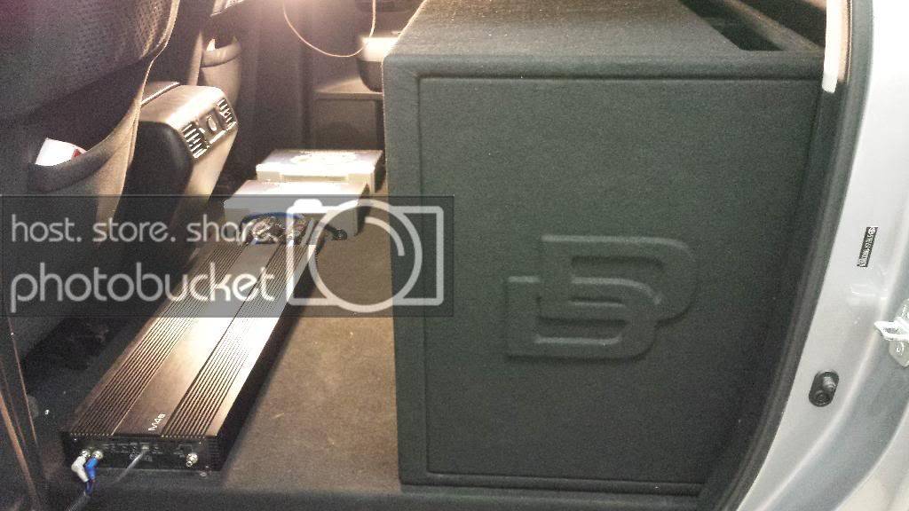

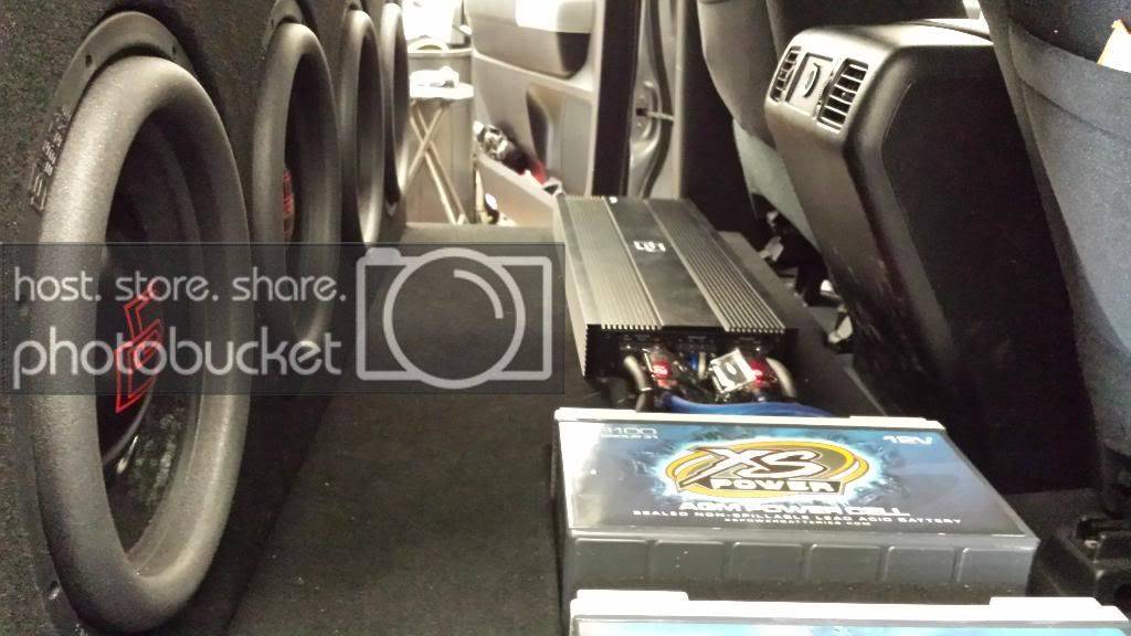

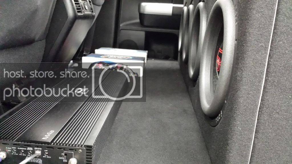

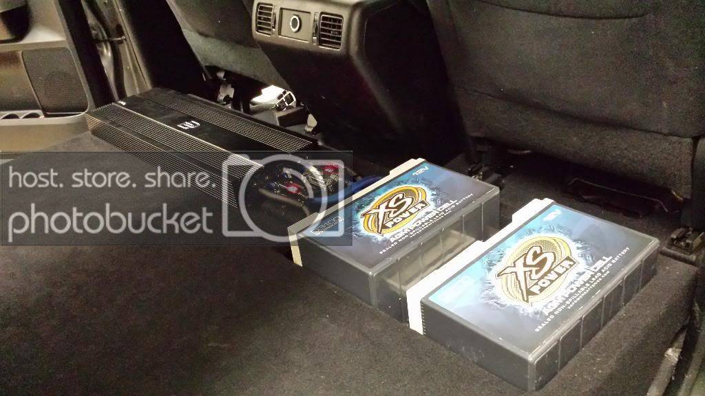

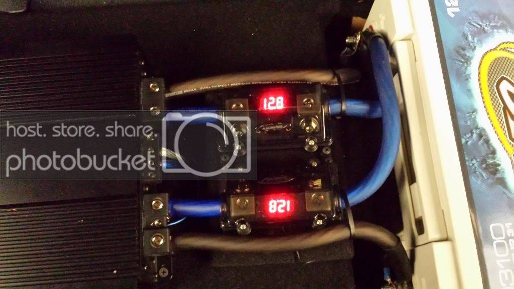

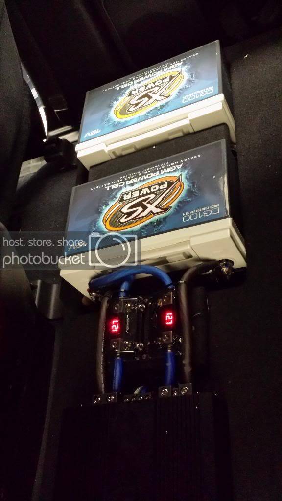

Amp and batts wired up and mounted.
Volt meters on the fuse-holders. Kept the wire lengths between the batts and amp pretty short...lol.

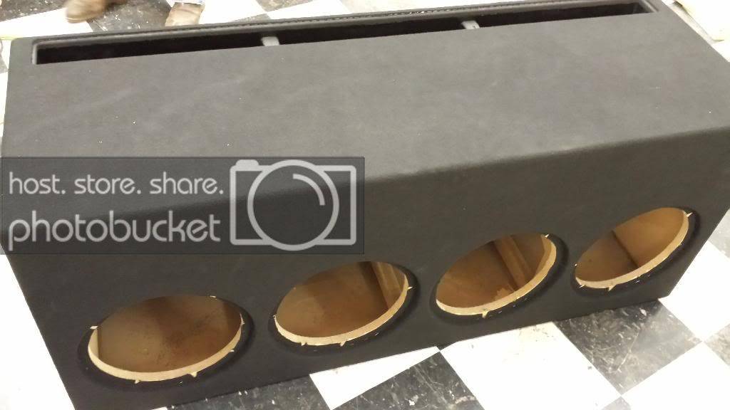

Box carpeted and ready to go in.
Box dropped in the truck. DD-Logo on both sides.
