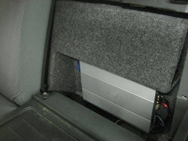

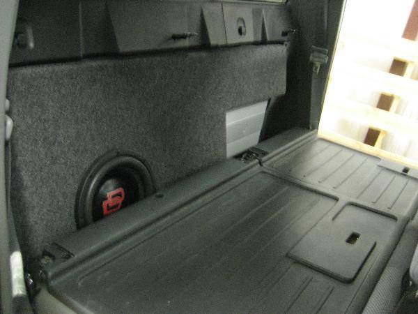

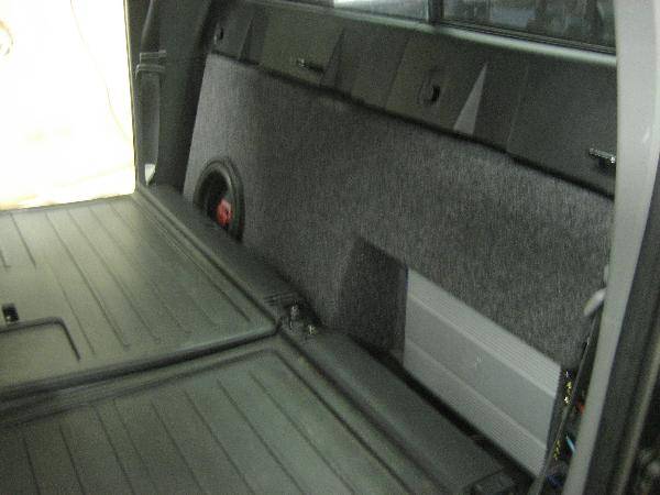

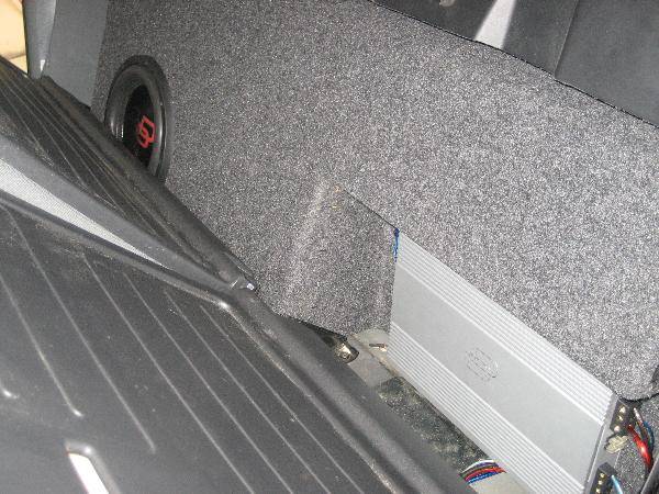

Not sure on how it looks in the Tundra, but this is what I in a customer's '07 Tacoma 2weeks ago.
1 DD1510T D4, DD C2b @ 2ohm. 1.35cuft, 38hz, w/ amp-rack as part of box.
You may be able to do something similar.
Sounded very nice and got LOW in that truck, plays Late Night Tip like a champ.
The other local place tried to get him in 2 CVT 12's....they sounded like crap though.
I had to drill out all the spot welds for the brackets on the back wall though.
Always a nice job Canaan.
