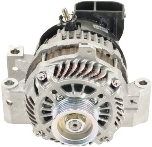

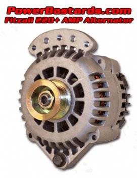

Edit: The stock alternator is a 100 amp unit this mounts differently than the normal units I've seen. The stock unit is a ACDELCO 3342699, BOSCH AL4239X, or equivalent.
Whereas aftermarket (and most other alternators I've seen have the bolt holes 90° rotated. Such as the "universal" upgrade Fitzall-220.
I don't know how I could get this to work, sure I could make my own custom adapter to run a upgraded gm alternator and run my own belt configuration, but thats over what I want to do. Anybody know how much more power I could get from sending in a core unit and having it rewound with an overdrive pulley?

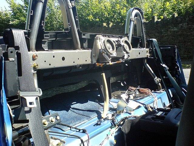

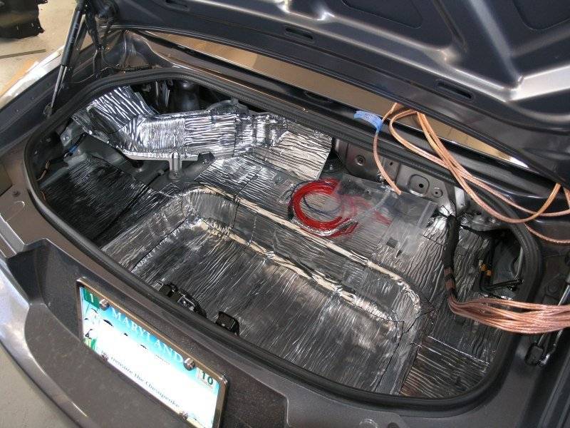

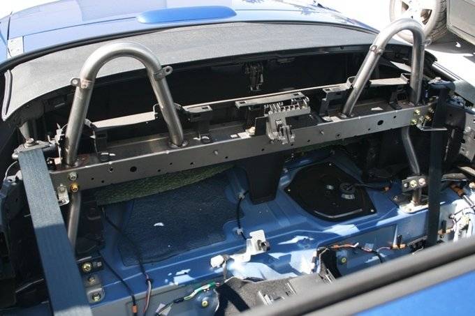

I'm not exactly sure how its setup as I haven't striped mine down yet. I do know that the top folds up infront of the trunk, and that there is a lot of wasted space between the trunk and the seats. I think the trunk is almost completely sealed from the cabin with a firewall though.. I found a few pics that might help spark some ideas.
I wish I had dimensions of this indent. but I can't find any.

Ah thats a bummer that the top wastes so much space and there is a firewall. I've been looking at 12-15 miatas with the hardtop but the lack of space for copious amounts of bass is a big turn off. Maybe look into bass shakers under the seats.
Those photos are with the top down, the factory places glove boxes in a big plastic shroud in that space above the fuel pump access and the space besides it. It should be plenty of space for something modest. (Although I've heard the hardtops have less room) I've heard of people drilling a hole to run wires into the trunk, but its very debated how well it sounds to place a subwoofer back there.
