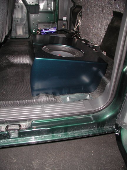

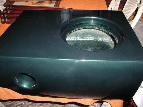

Heres what I came up with. No room to down fire the 10" Type R , to tall. Its sitting about 1/2" off the bottom of the enclosure. Bottom and back is fiberglass moulded to the floor. Sides are 3/4" MDF, front and top are 1 1/2" MDF, two pieces glued together. Rounded the face freehand with a belt sander. 4" port firing foreward, can feel the air thru the cracks in the front seat when the sub hits. The back seat sits about 1" off the top of the box when its down. Havent had any problems yet with people sitting on it.
