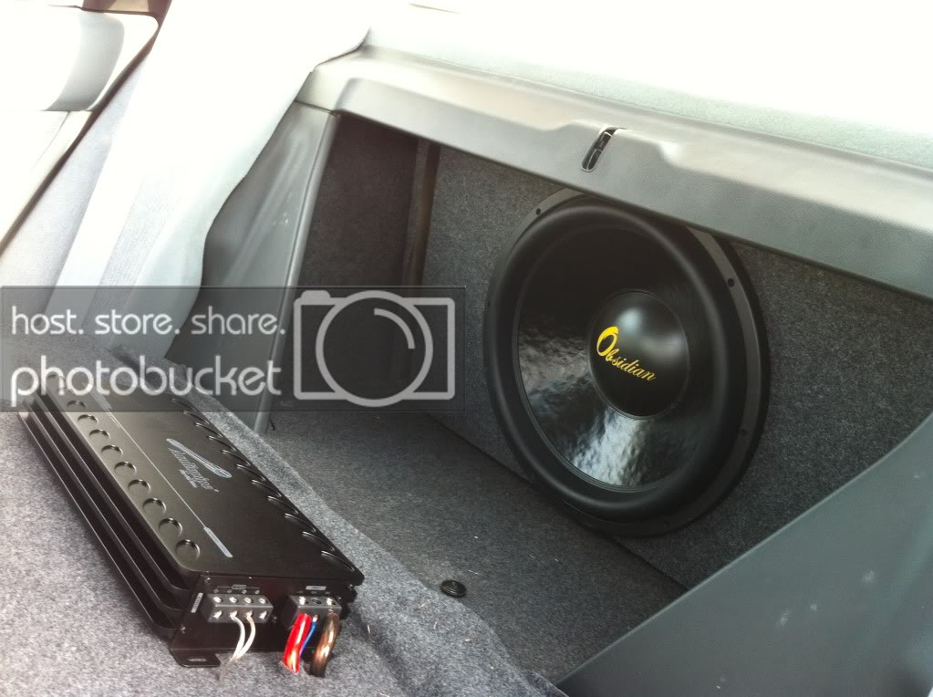

Also as others have said, having your gain at 60% means nothing. You could have a deck with 8v preouts and an amp that starts with 9v (as on an amp, all the way to the left is a higher number, as you turn it to the right the number decreases) and you would just barely turn it and you'd have your gain set; turning it a quarter of the way would cause you to be clipping.

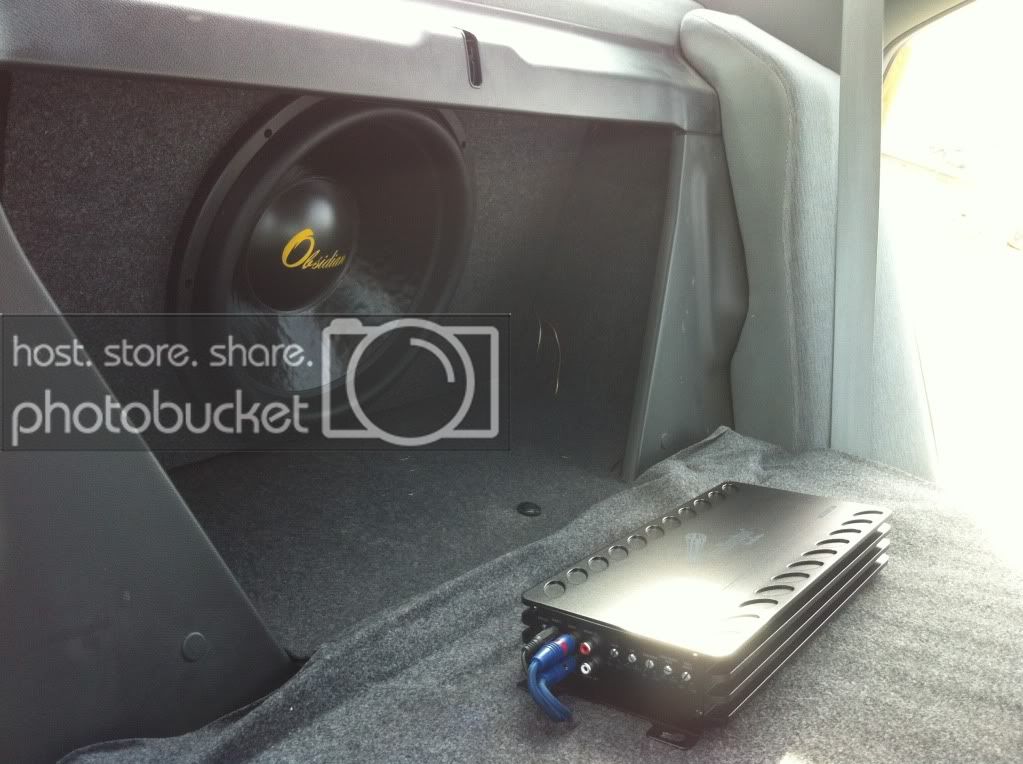

Hard to tell much about an amp's setup from a pic, OP...especially wrt the gain setting. Like has already been remarked, whether or not it is really set correctly depends on more things than just being at 60% of max on amp's gain pot.
Turn that LPF down son.
Looks like he might have the LPF currently set to 80-100Hz, which is not awful. Turning it on to 180Hz like he was talking about doing would be very noob-like, tho!

And If he's got 2 volt pre-outs, he's probably fine. But he could just as likely have 4 volt pre-outs, it's not like they're unheard of these days or something. Even some of the most basic decks have 'em.
EDIT: Strike that last bit about it being more than 2v pre-outs... he's got a boss, he's lucky if he's seeing 2v. Gain is more than likely fine haha.
What I was going to say, looks like it's in that range.
