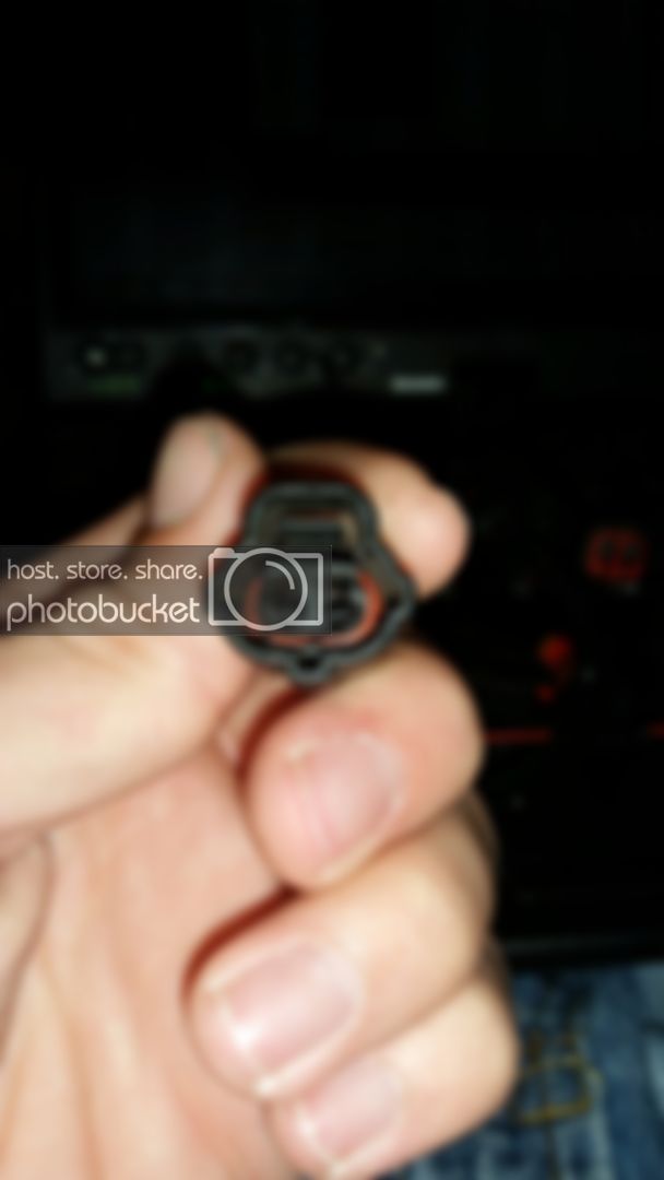

x2. I almost s**t a brick when my voltage dropped to 13.1v. I lost sleep over the s**t, but I figured it out when the field connector fell the f**k apart.
