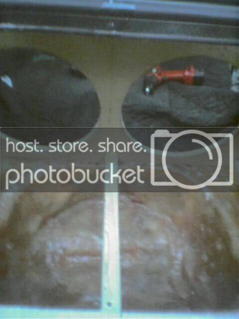

well well well. its a beautiful thing to see this because i was jsut like u a couple months ago but with a grand am instead. heres what i did when i started out. i dont have recent pictures but i decided to go with aero ports and fire them into the cabin and the rest is history. heres what i did...
had to fiberglass the wheel well....

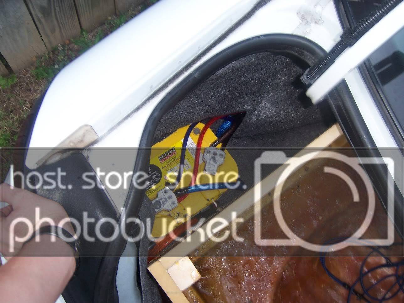

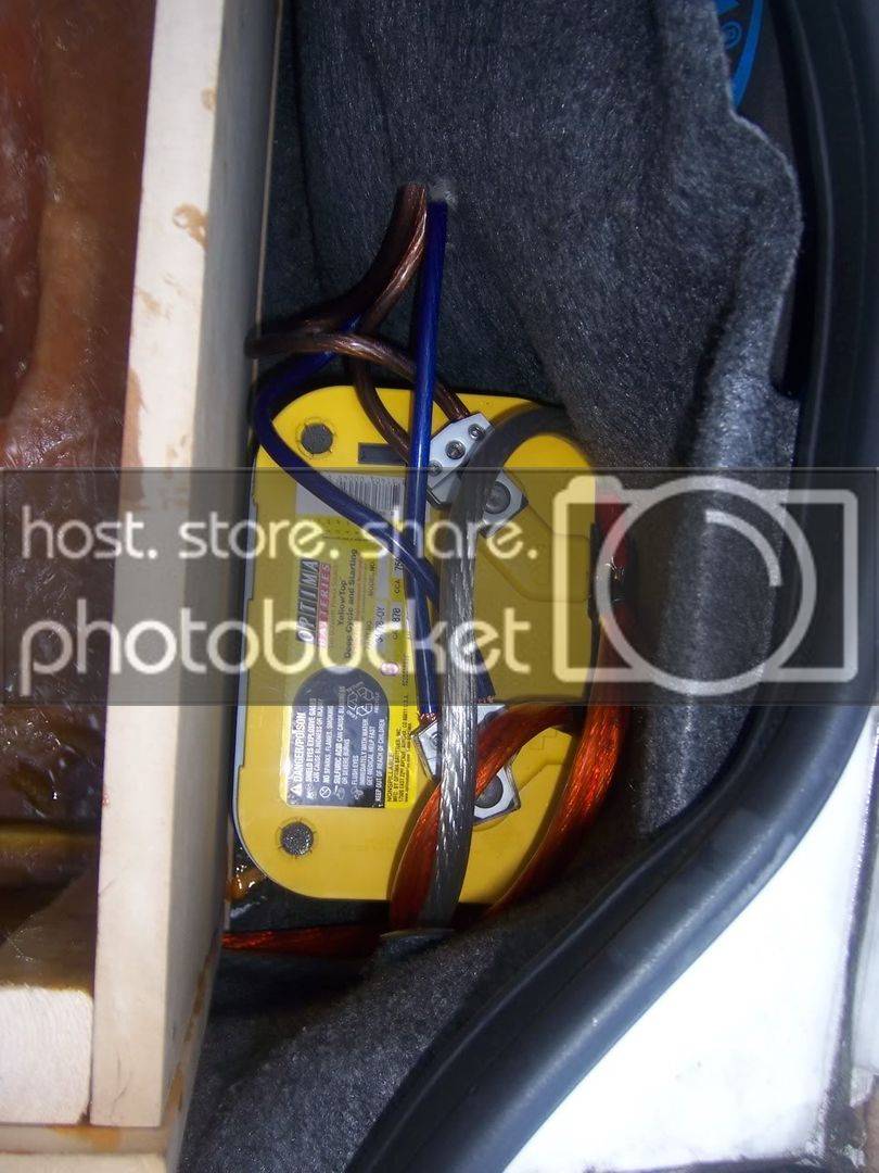

Optimas on both sides....

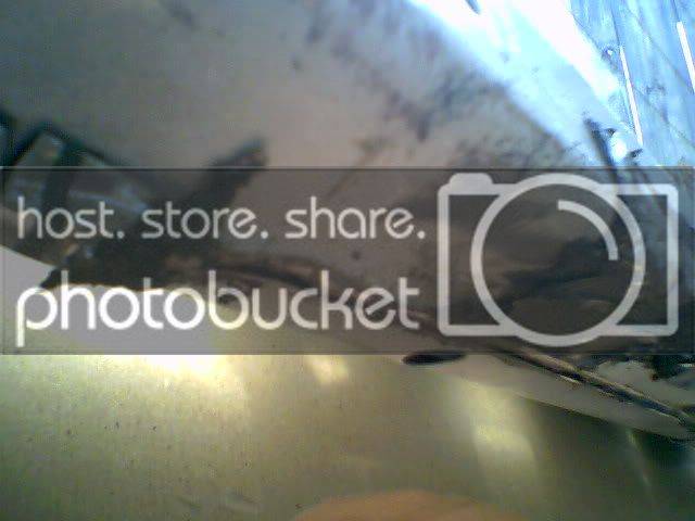

Even had to alter the car SLIGHTLY lol....

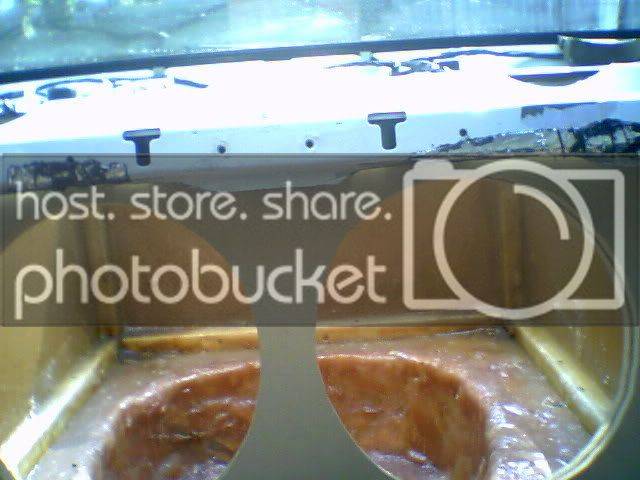

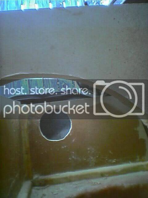

heres the original idea i had for the ports 2 6", 6" deep PVC ports....what a fool i was... they are ported in the trunk, not inside the cabin....o well. heres the holes....
and heres a sloppy picutre of how the front fits in there with some bracing from a 2x2 (there is also another 2x2 on the top) (PS: THIS IS NOT ENUFF BRACING)....

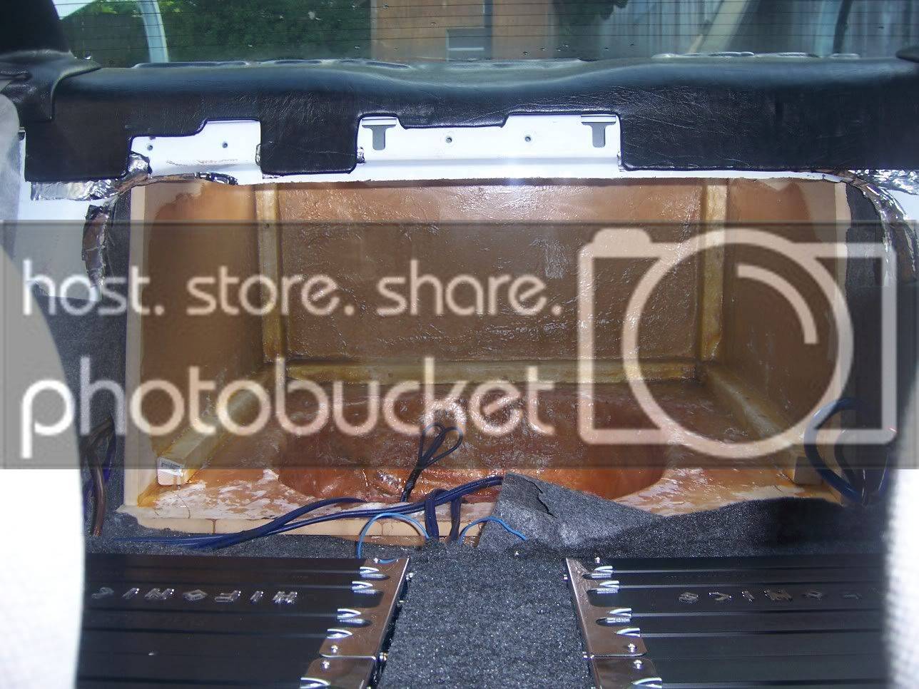

where do the amps go, might u ask....
i really wanted to keep this a CAR and not a real project, i guess, so i kept the back seats fully functional by taking them out, taking the cushioning out and puting a piece of mdf with some kind of cushion from the local hobby lobby)
heres the face of it. had to cut it at a slant to fit it in there... wayyy more work than i bargained for.....
i never ran out of uses for fiberglass thru this whole expedition....
if i find some more pictures, ill put em up but this is just what i found. any questions PM me....

P.S. inapontiac, the picture that says "Even had to alter the car SLIGHTLY lol...." what is that a picture of?
