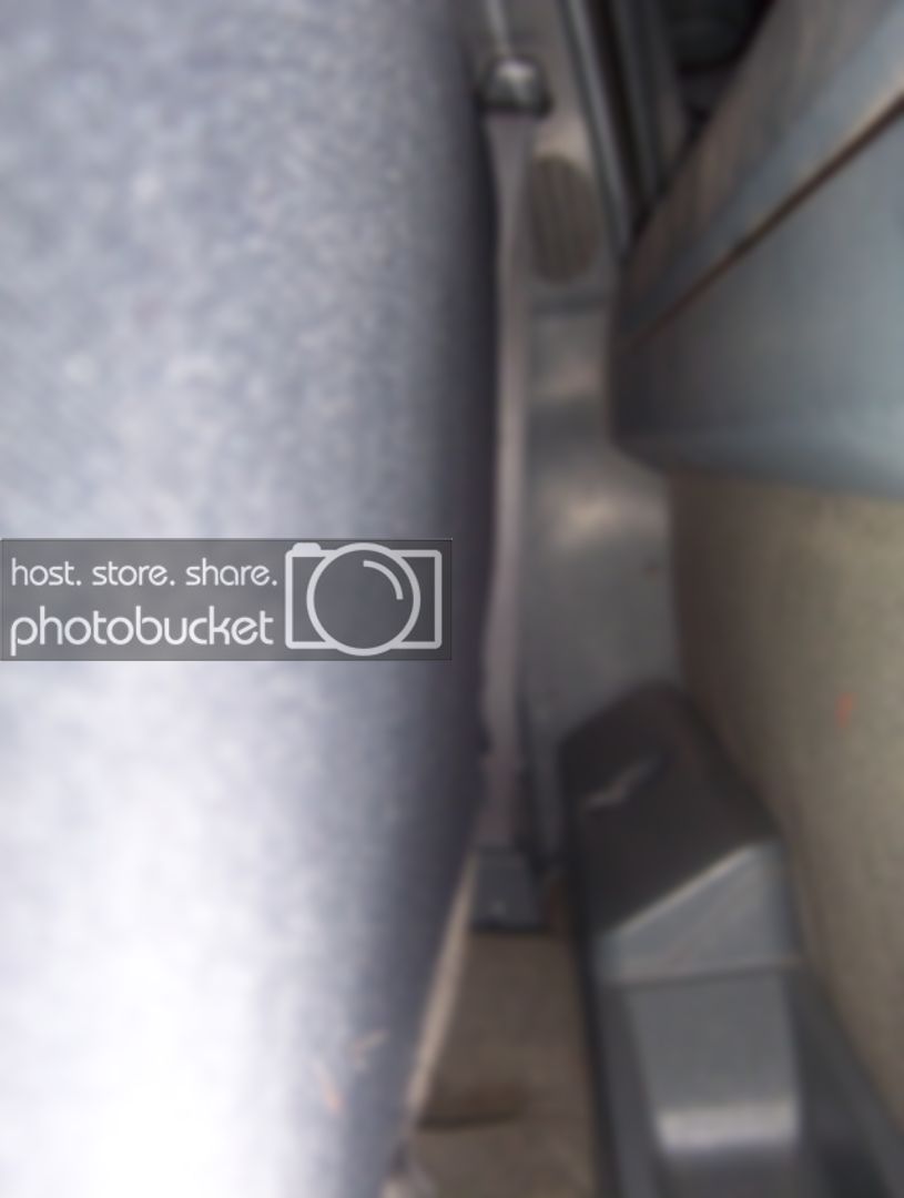

ahh, i belive i can go longer? i got an old pic of where the box will go.
i think 14" might be my max because of that dang plastic piece.
i think i can go about 50"-55" i just wanted to make a beauty panel on the side for the amp mounting.
