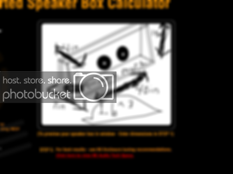

need someone to figure out port length, reward will be $2 paypal.
PM me answers, no fucking guessing assholes //content.invisioncic.com/y282845/emoticons/smile.gif.1ebc41e1811405b213edfc4622c41e27.gif
putting (2) 2" port (pvc pipe) on the bottom passenger side.
the box is 1.6^3 after displacements (other than the port obviously)
how long in inches will the pvc pipe need to be in the box?
Tuned to ~35hz
im slightly confused on how you got the ft^3 number. is that a 4" top and 7" bottom depth? here are my numbers based on 0.75 enclosure thickness:
gross volume: 1.114 ft^3
net volume (not including sub displacement but accounting for the port): 1.073 ft^3
port area (2" ports time 2): 6.283 in^2
port length: 11.387"
assuming that you had wwo of these enclosures with one 2" port per enclosure, then the port length would be 4.753"
