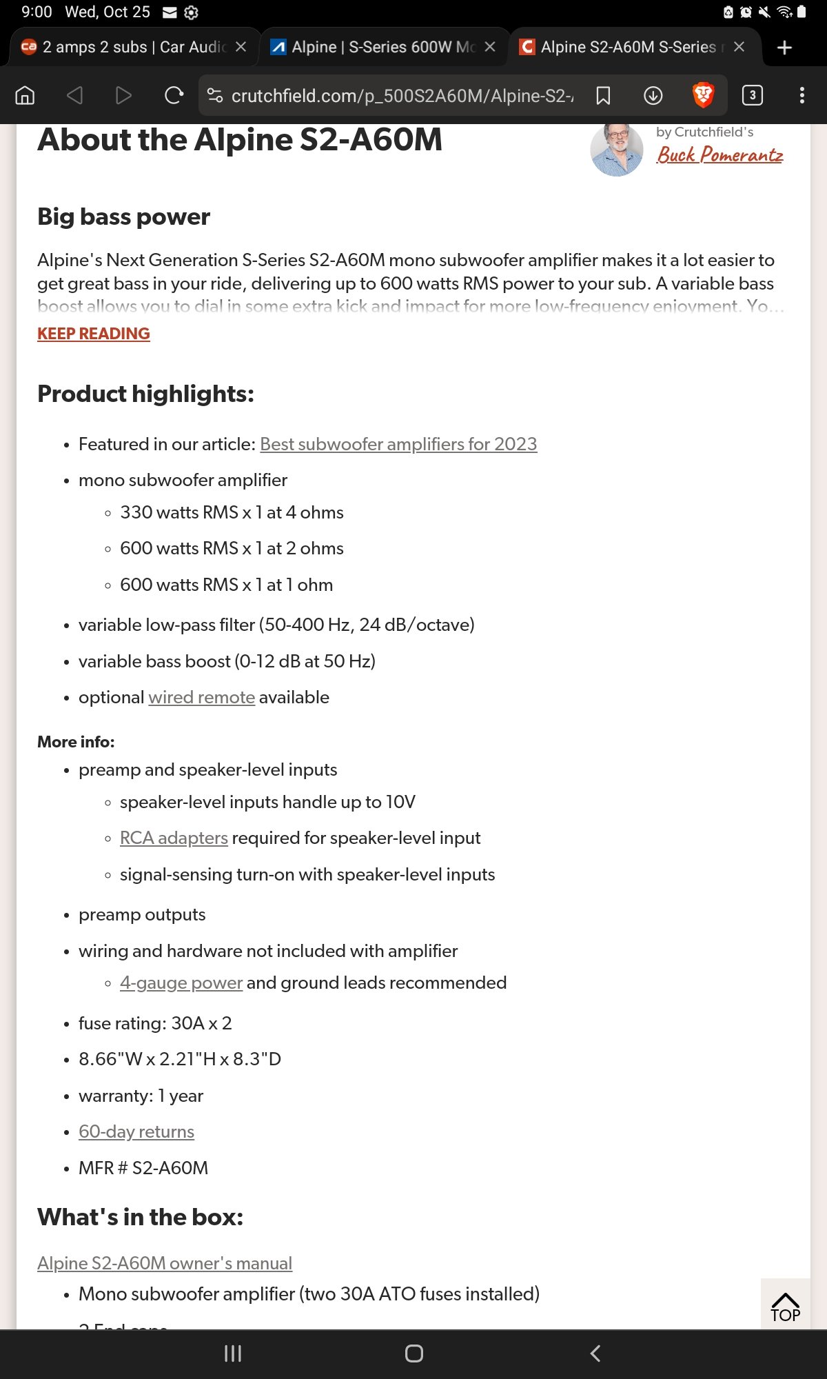

Crutchfield and the Alpine website both say that amp is 1 ohm stable
