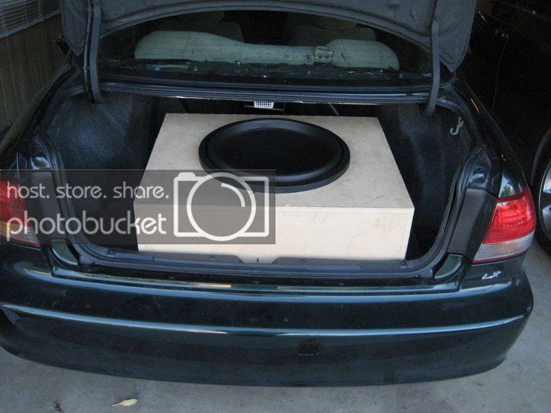

Tis a crappy pic, but why not somethin like this for lows? //content.invisioncic.com/y282845/emoticons/wink.gif.608e3ea05f1a9f98611af0861652f8fb.gif (keep in mind the enclosure can be half that size //content.invisioncic.com/y282845/emoticons/biggrin.gif.d71a5d36fcbab170f2364c9f2e3946cb.gif). Though cvjoint's setup with theose MAX's are incredible awesome. Haven't heard the lows, but definitely gets loud. Can't wait to hear his setup since he's done quite a bit of upgrades since the last time I heard.
