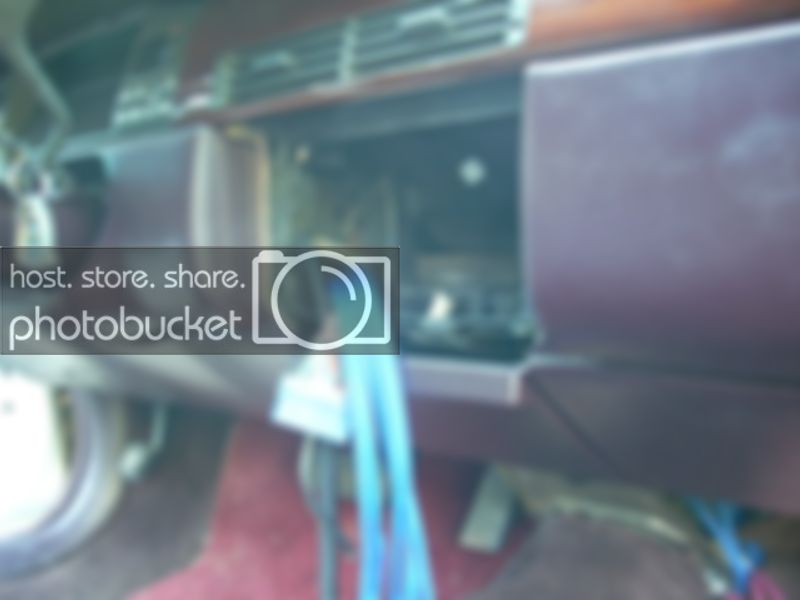

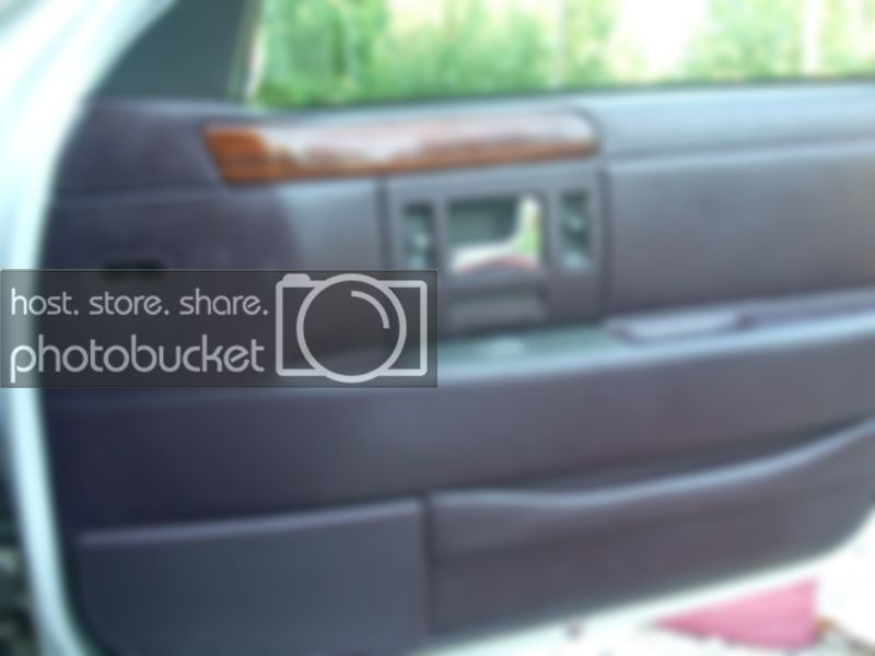

I have no intentions of competing with this setup, purely for my enjoyment and is being built for SQ.

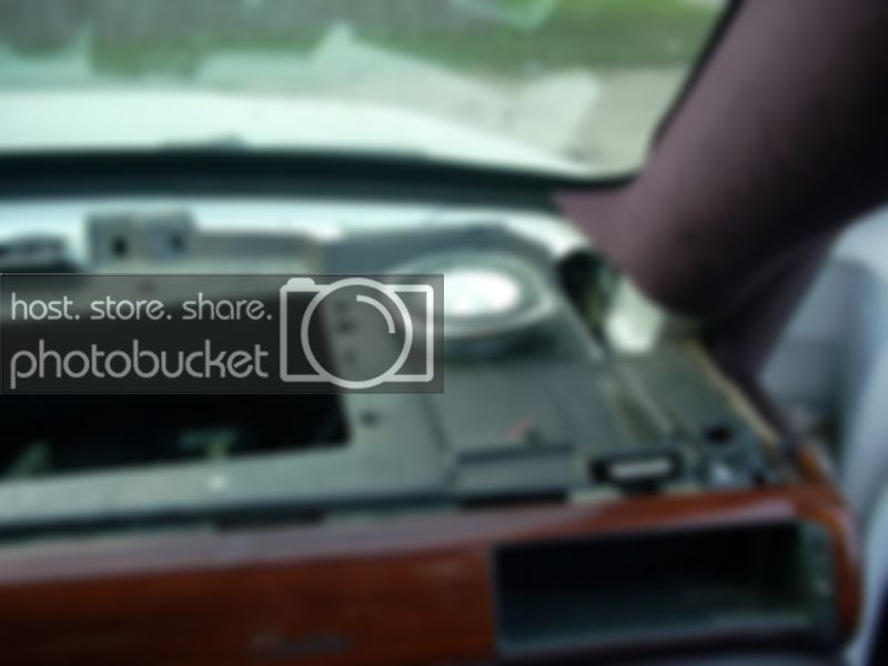

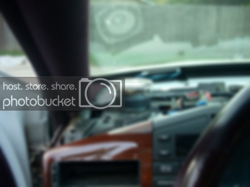

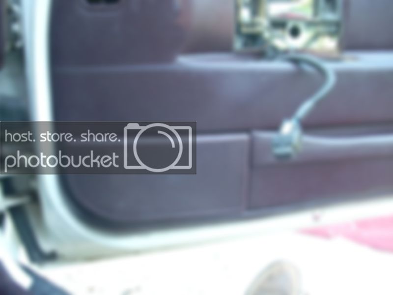

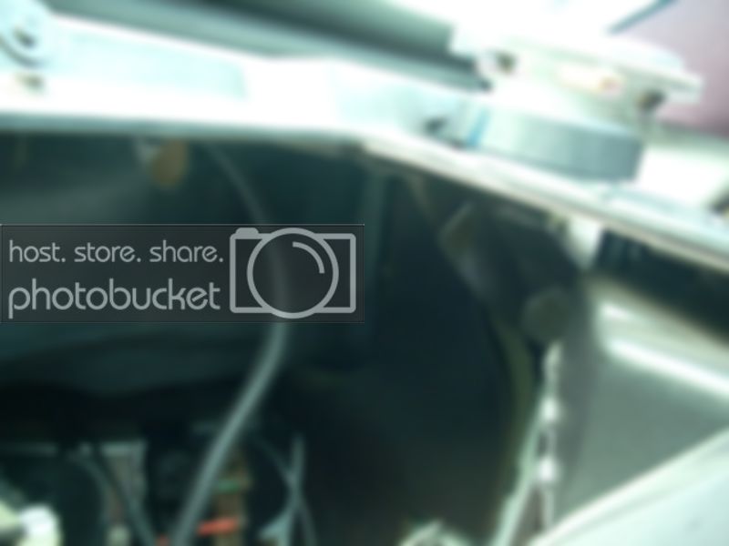

2-way active front stage, the Fostex FF85k's are running in the dash from ~250hz up, the MLI's are doing the rest of the work. Once the 12v PS gets in for the DCX unit all processing will be done by it, serial cable ran to the front for changing settings from the front seat on a laptop.
12" Mag will be in the rear deck whenever it gets in, its been ordered just waiting on shipment.

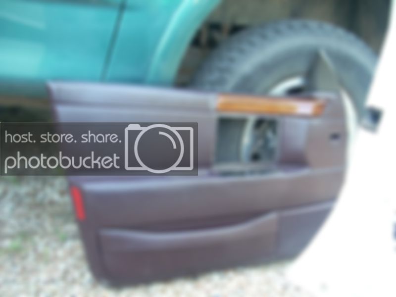

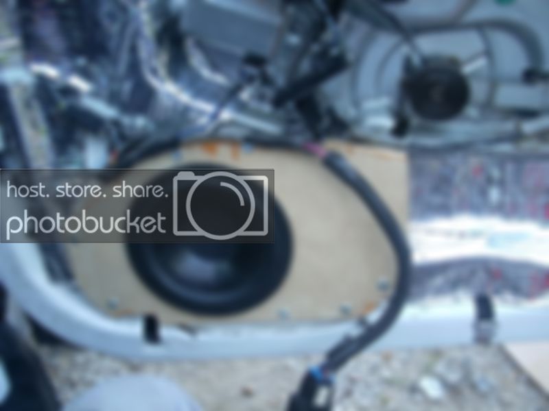

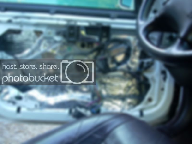

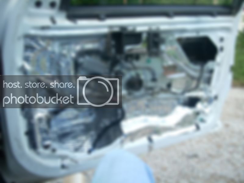

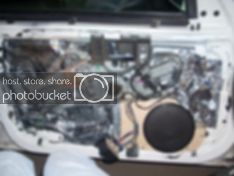

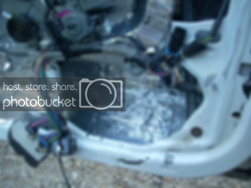

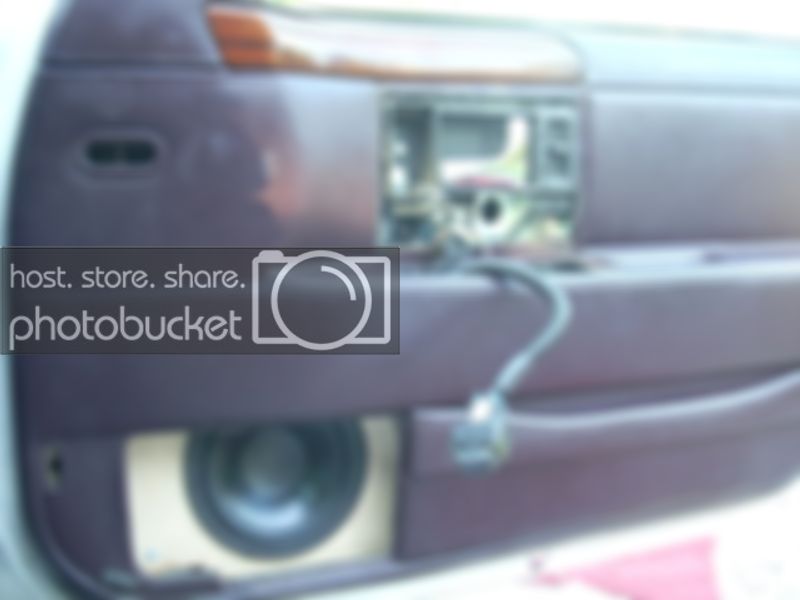

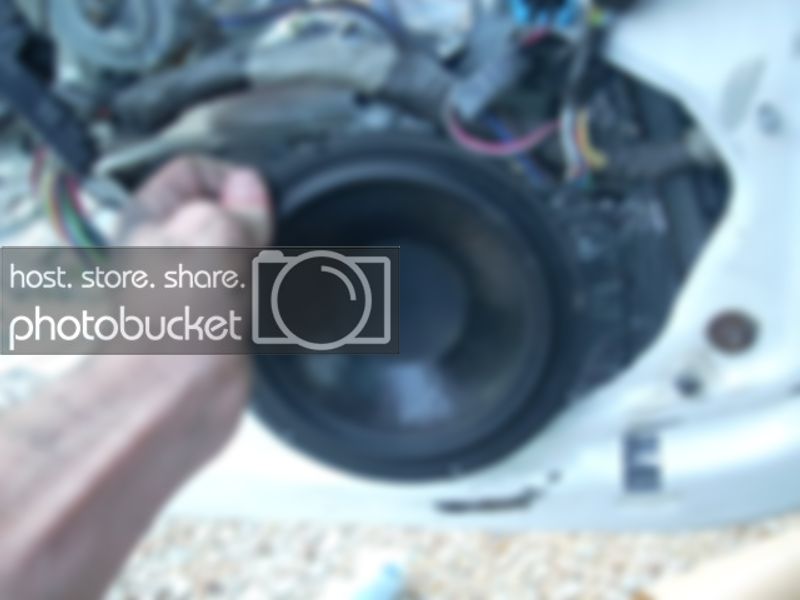

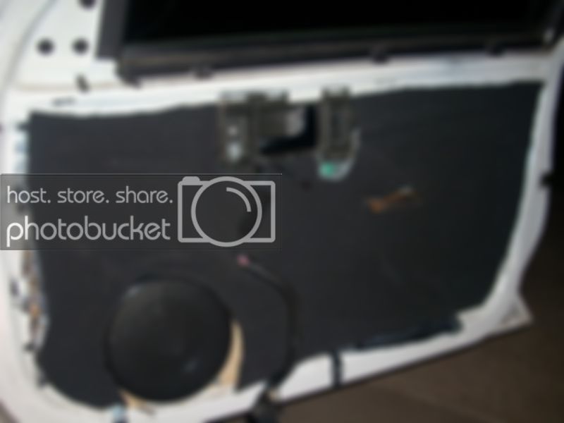

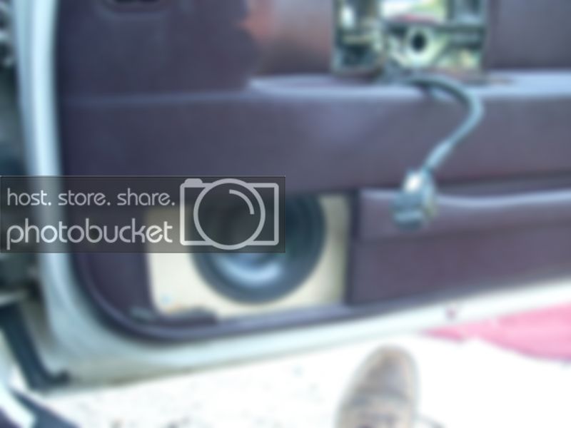

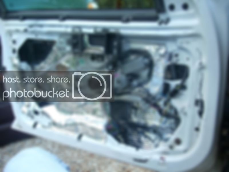

There is probably ~20-25ft^2 of deadening in the doors and they are sealed up as best that I can, layer of ensolite on top of the panels. The MLI's are in the factory placement in the doors.

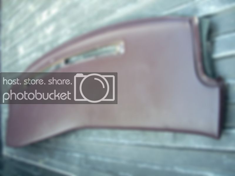

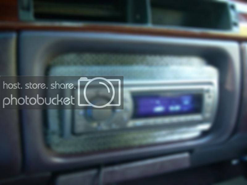

The HU is a temporary holder untill I can figure out how I want the final one to look, just something I whipped up in the shop in about 30 minutes.
On to the photos. More will be posted as more is done.
