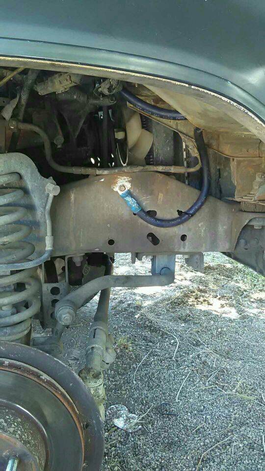

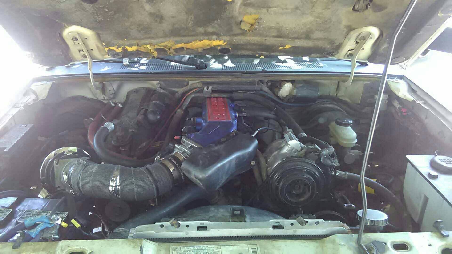

Think it was a bad ground, ran one of my 0gauge to the frame (I guess technically I had 2 on the engine, one on block and one on alt mount, redid my 4guage body ground and looks like voltage drop is gone atleast till amp starts clipping also cleaned up the wiring a little
Sent from my 5054N using Tapatalk
Still. If it was an amp ground. Id never put it there but as its a big 3 ground. No biggie.
Sent from my SGH-T999 using Tapatalk
Yeah it's big 3, once I have the inner fender well on it's actually covered, I have it taken off right now cause I gotta replace the exhaust manifold
