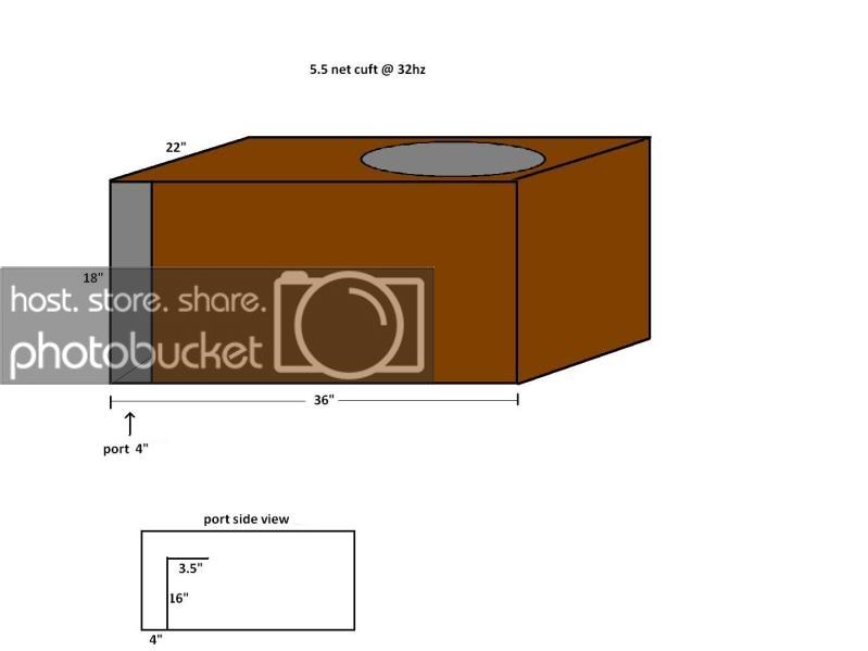

i need help on my 18" RD HW sub does anyone know what size of a box to build for this thing and i do want to tune to to 32 or 34 hz and also it will be going in a blazer so could someone please help me out

try this one Andrew
I don't see how that first port piece is going to be 16". Depending on how the pieces overlap(which you can't tell), you'll have three possibilities.
1) 15.75" if it's sandwiched between the front piece and other port wall.
2) 16.5" if it's overlapped by the front and overlapping the other port wall(or vice versa...overlapped by one of the two other walls).
3) 17.25" if it's overlapping both the front and other port wall.
