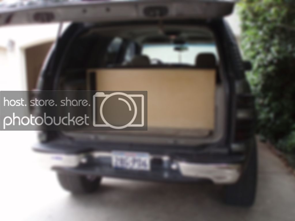

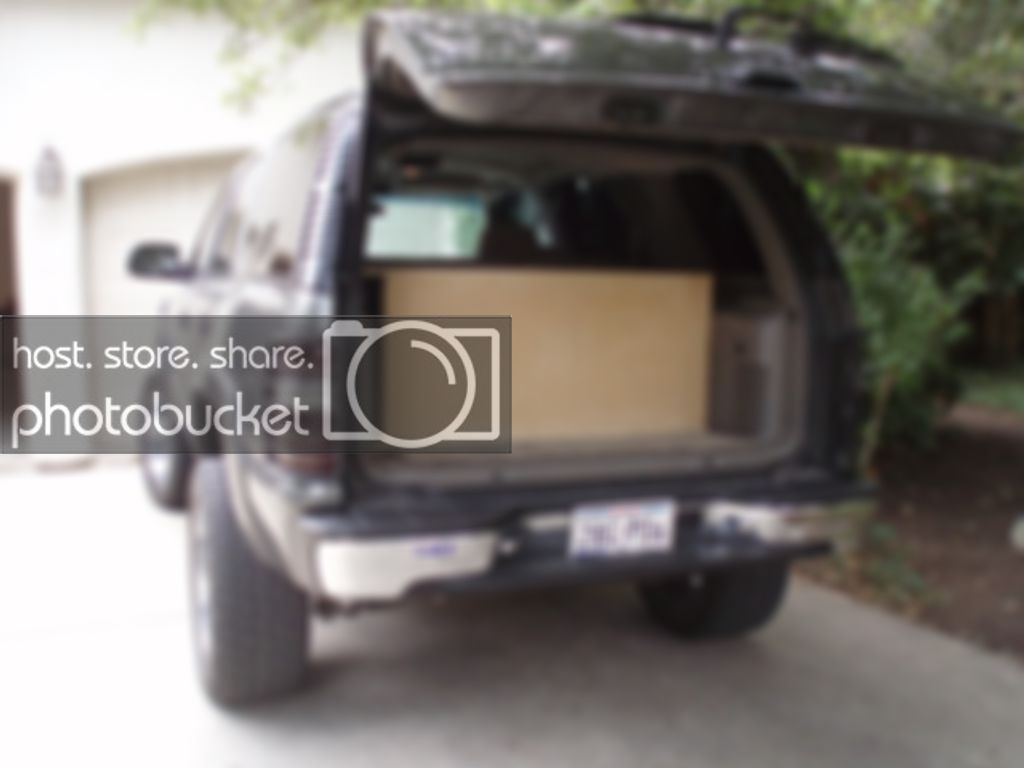

well so far all i have is the box about 75% complete. waiting on the sub and amp to come in. the sub should be in by tuesday and amp later this week. anyways the box is about 5.7 cubes at 35Hz. heres a pic of it in the hoe. thinking about doing a second layer on the front and back to help with bracing. anyways heres a couple pics
more to come later
Great choice of equipment. I am guessing a 148 assuming you have a good electrical system and that box doesn't flex.
Vids are a must. You're going to have some sexy flex.
Kevin
thanks for the comments guys,
definitely gonna throw some more mdf on this thing as well as a couple internal braces. also have a can of resin laying around and might as well use the last of it up on the inside as much as possible.

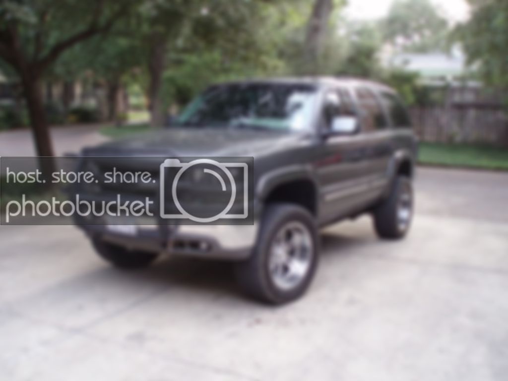

still needs some work, but heres a side shot of the truck. its a 3" body lift with keys on 20x10 gunner 6's and 305 55 r20 terra grapplers. some colormatching and headlights and stuff as well. seems like most guys into car audio like to go lower, but up high is where i like to be //content.invisioncic.com/y282845/emoticons/smile.gif.1ebc41e1811405b213edfc4622c41e27.gif
