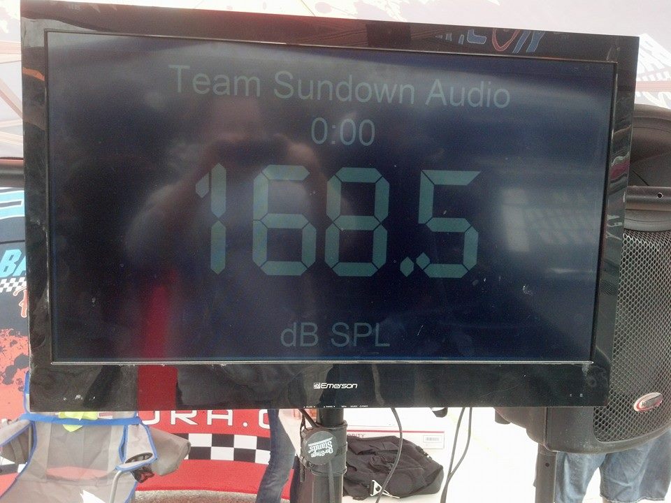

Currently 6x Z v.3 15" Dual-1 with stock spiders and NS v.2 coils (pulled from the Yard Sale... these are not optimized for the Terra) on 3x NS-1 v.2 amplifiers.
Photo is from the TDH show in Virginia this past weekend; certified 3x dB Drag Score.
