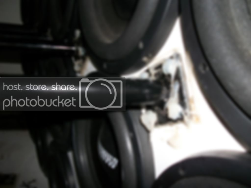

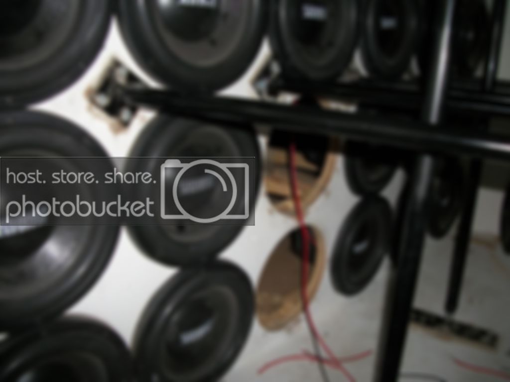

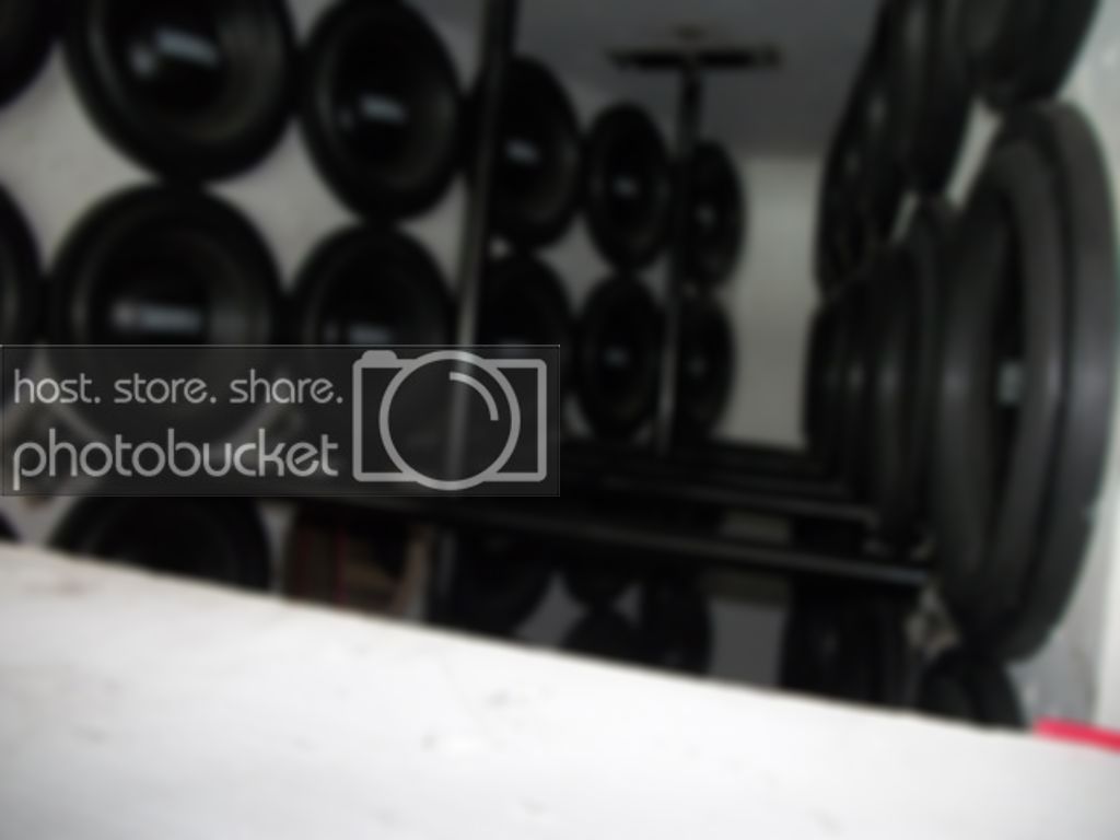

my upgraded bracing. last braces only had 1/8" flat stock mounting feet and they broke and bent so i stepped up to 1/4" thick. also running 1" 1/8"walled round tube steel vs square tube.
u can see in one of the pics in the sub hole how i had to fix one of the rear braces. looks ghetto but it has worked great.
put silicon around the heads of each bolt to prevent them from drawing out by vibrations in the future. yah it doesnt look pretty but i dont care as long as it works.
