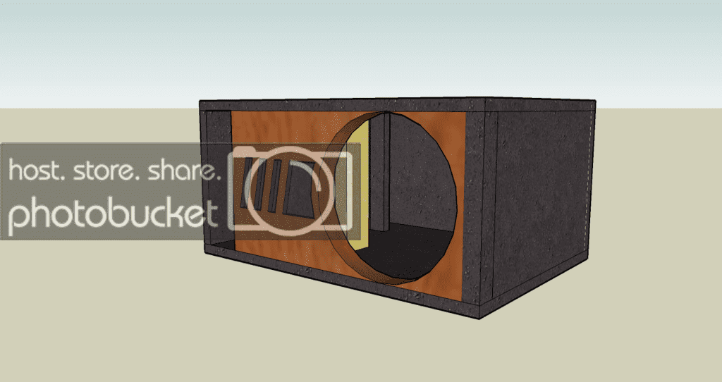

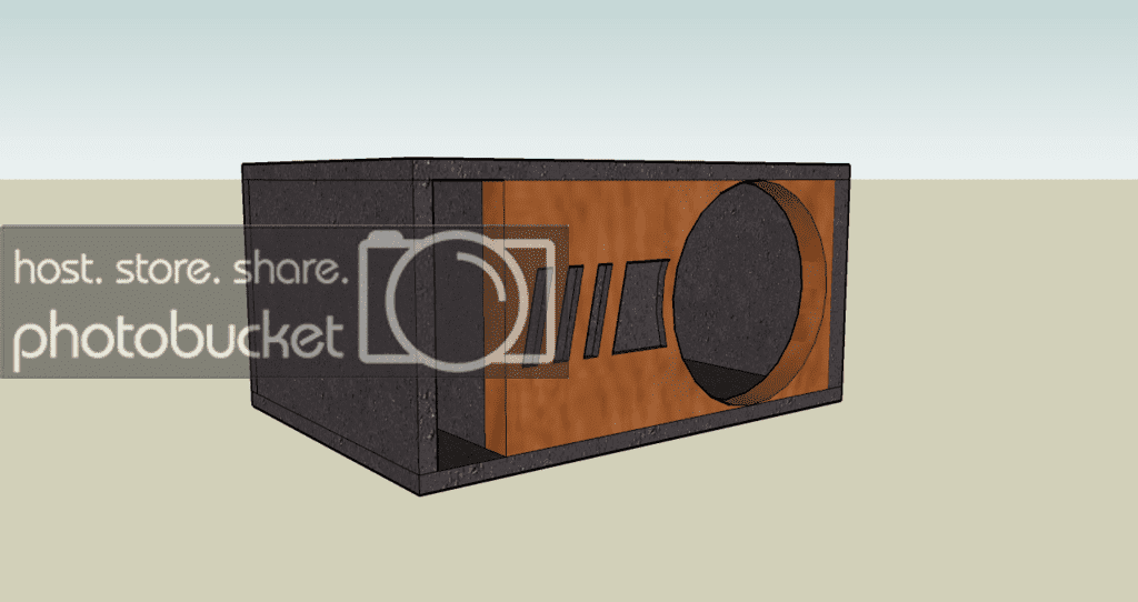

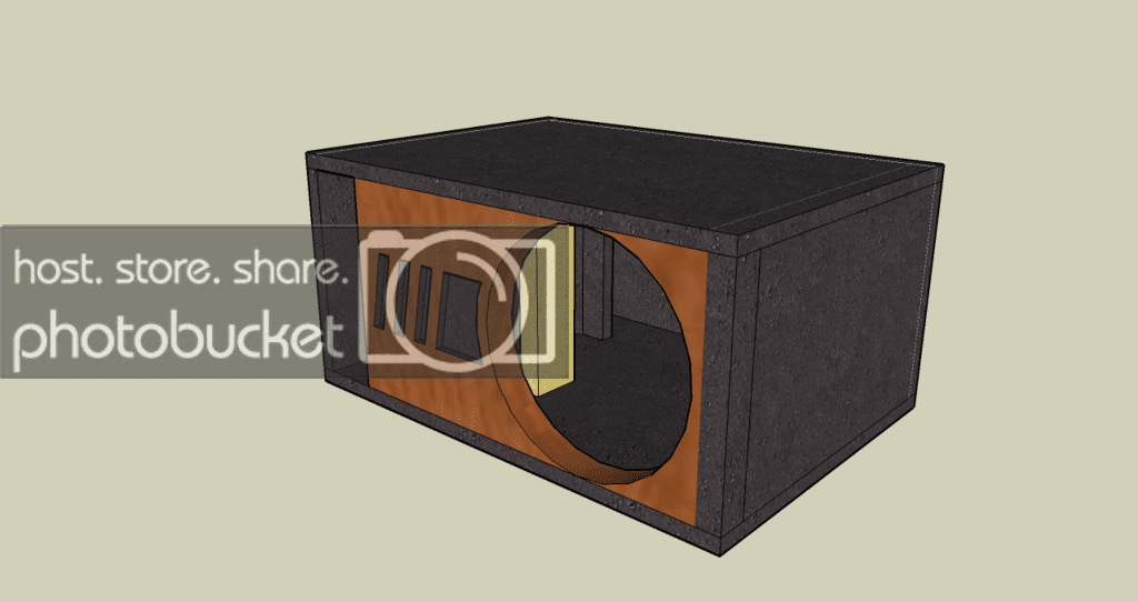

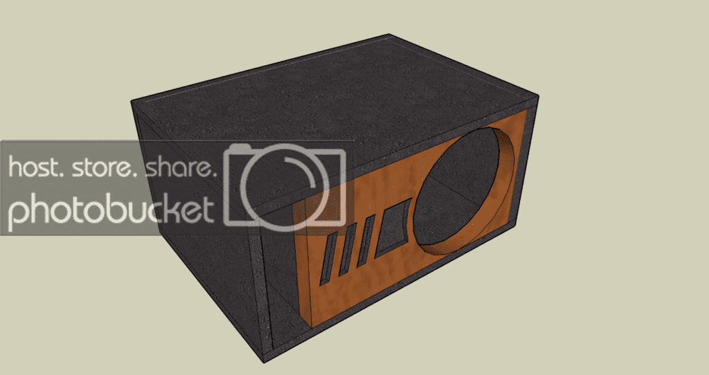

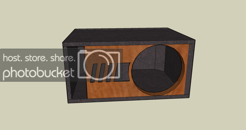

comes to be 3.56 cubes with all displacements minused tuned to 35hz with 56" of port area. the light wood colored brace is a 2x4.
wood thickness is 1" all around and a 2" baffle. the front is birch ply
32.5"x16"x23"
what do you guys think? im thinking about building it so any criticizm is appreciated. i may not have many posts, but that doesnt mean im a noob dont flame me guys.
what abouth the specs do you think they will perform well with a 5200?
i can not say as i have not followed up much on any of TC subs. I'm sure someone will chime in. //content.invisioncic.com/y282845/emoticons/smile.gif.1ebc41e1811405b213edfc4622c41e27.gif
even if it is alot alike, it doesnt have to look like that i could design something different. i just like the look of the black on birch...just designing something that looks good is going to take a while.
looks good. not sure about finding 1" mdf & baltic birch though as 3/4" is WAY more common unless you have a source...
two sheets of 1/2" mdf would work, i could also use mdf for the whole things and just put a stained birch veneer or something on the front.
