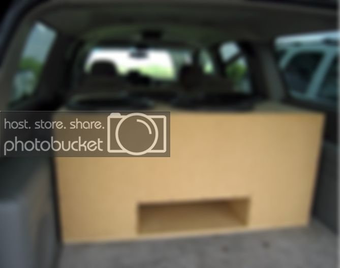

Here's the kids current enclosure and sub for reference.
Might still end up with 2 blown SE 12s that I'll end up sending to you to convert to 15s ect. ect.

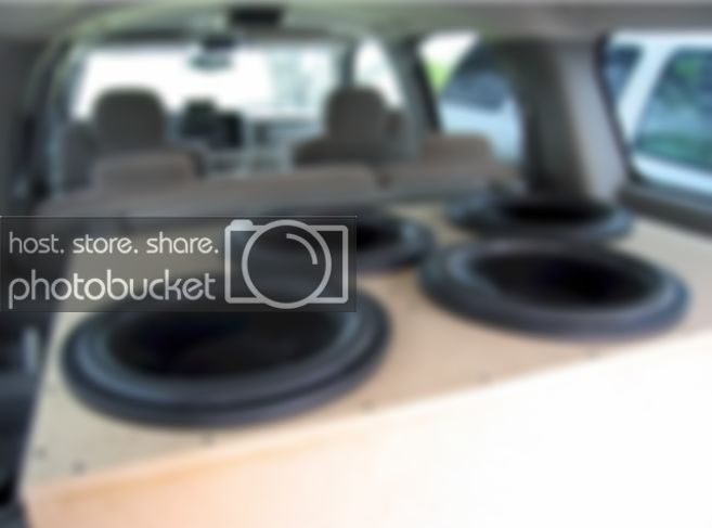

I will say that I ran (4) Avalanche 15's in my suburban on less than 1000 watts each. 15 cuft tuned to 32 Hz and a 25 Hz subsonic filter. Bottomed them on more than one occasion. . .
