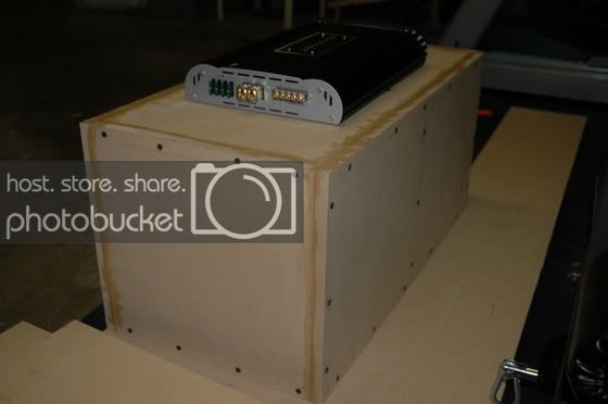

Those are some pics direct from eD. Heres the only pics I have of mine.
Its the only amp I have ever owned so I cant really give you any comparison, but I can tell you that it is an awesome amp. It has never gotten hot or had any problems whatsoever. It definitely sucks a lot of current though. I havent upgraded my big three or gotten a yellow top yet and my lights dim pretty bad when Im idling at night. BTW, Its in a jeep grand cherokee with pretty weak alt. Also, i am positive this thing is well over 1200w even with my weak electrical system. I ahve two 10" diamonds rated at 800w each in a medium sized seal enclosure and the NINe.1 will easily push them to their limits. I actually have to be careful on some songs because they bottom out.
I got extremely lucky when I purchased mine. I ordered it about 2 months ago when it was priced at $315 then on top of that I got a $65 dollar coupon for the nine.1 direct from eD just for ebing subscribed to their mailing list. For what I paid there is nothing that can even come close to this thing. Plus, the customer service is awesome and they give you a 3 yr warranty.
