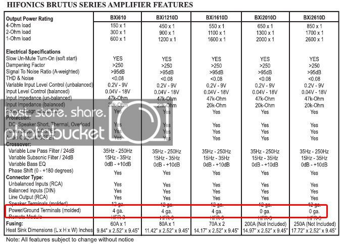

0Ga wire into a Hifonics Brutus?
Personally, I wouldn't do it. If you do, tape it up good so nothing metal rubs on it. What must people do is use a distro block to go from 1/0 to 4 AWG for their amps, but nothing says you can't do it for just 1 amp. It's a lot less likely to cause issues that way, and a distro to change your power and I'm assuming ground wire size in/out of your amp is only like 15 bucks new. 30 bucks total for piece of mind is a nice thing.
Depends on the model of Brutus you have. Some are 4 awg inputs and some are 1/0 awg. Use the wire size that matches your amp. If you have 1/0 ran to the back, that is fine. you may just need a distro block as mentioned above.
