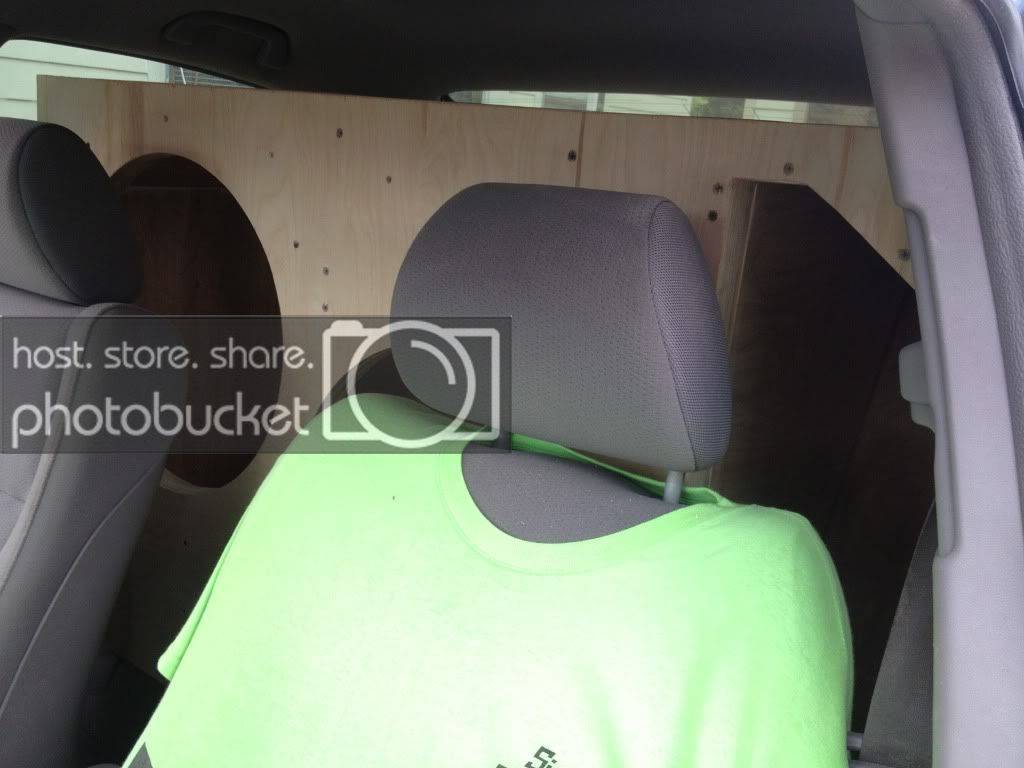

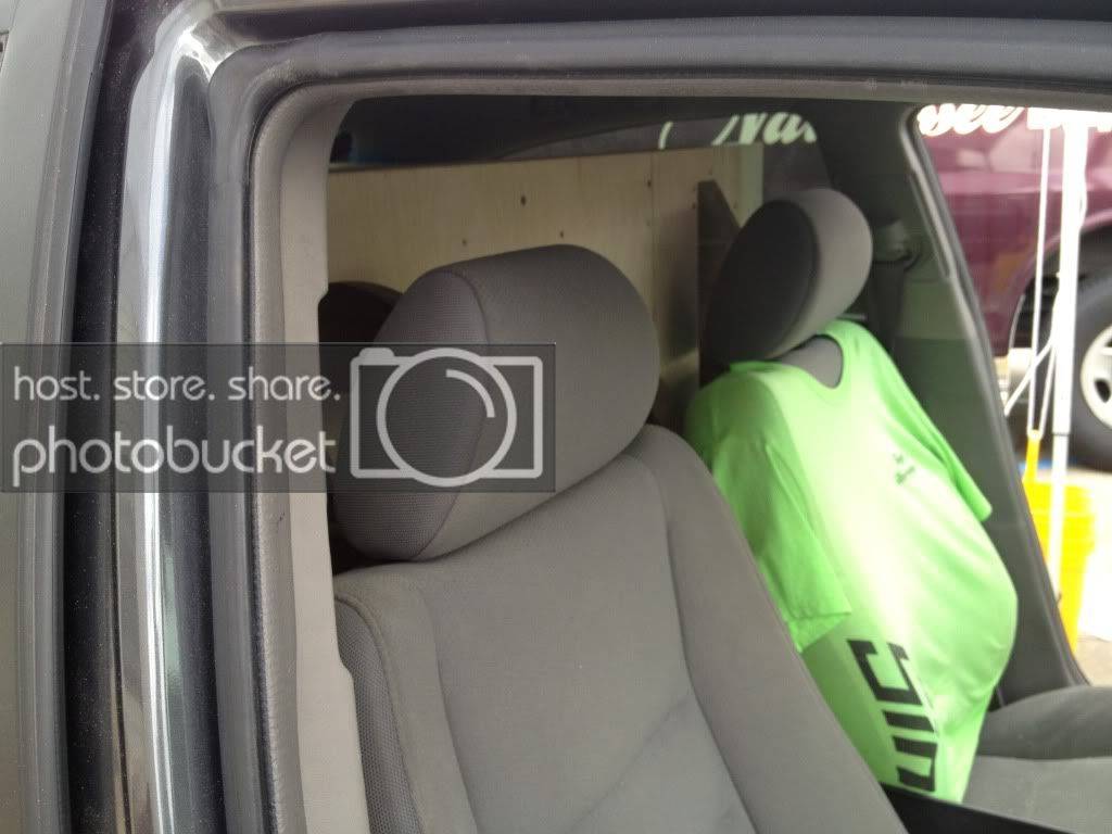

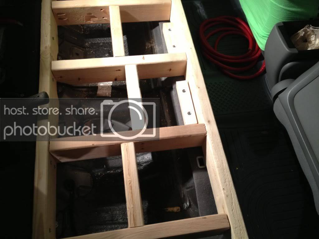

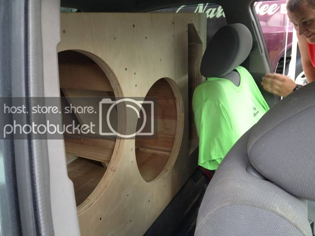

ssteele18

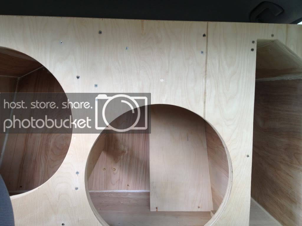

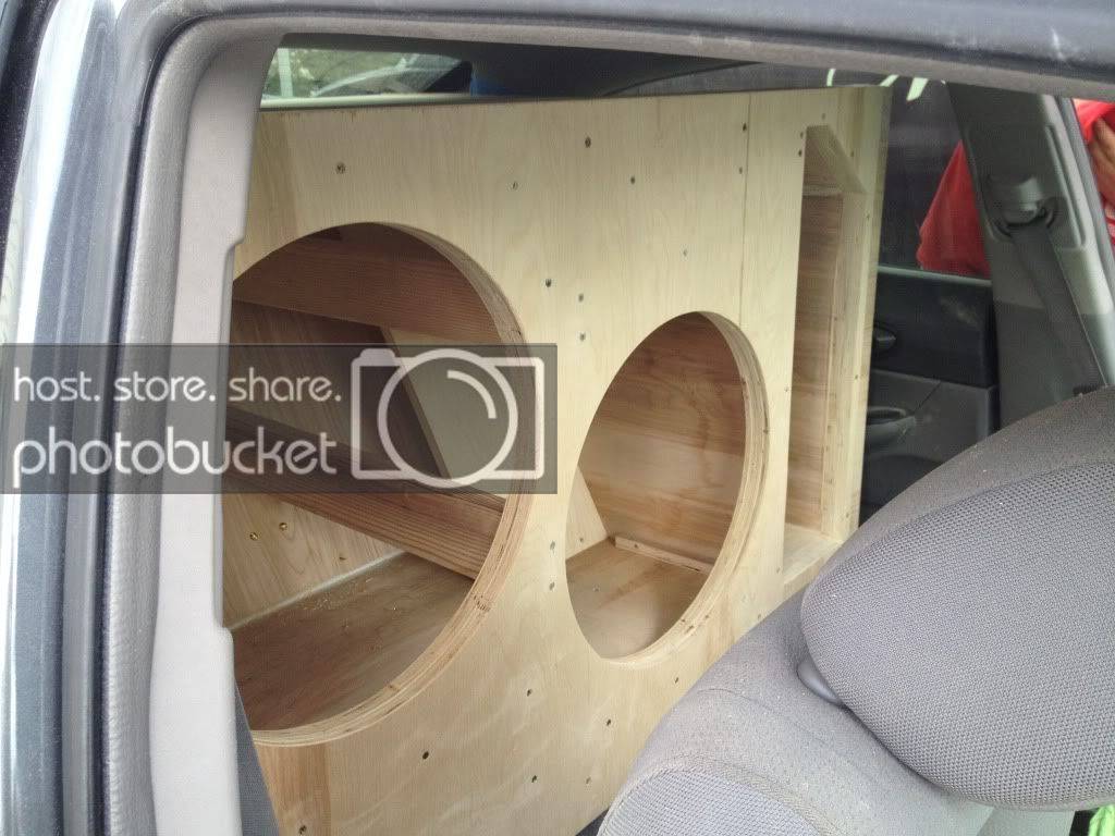

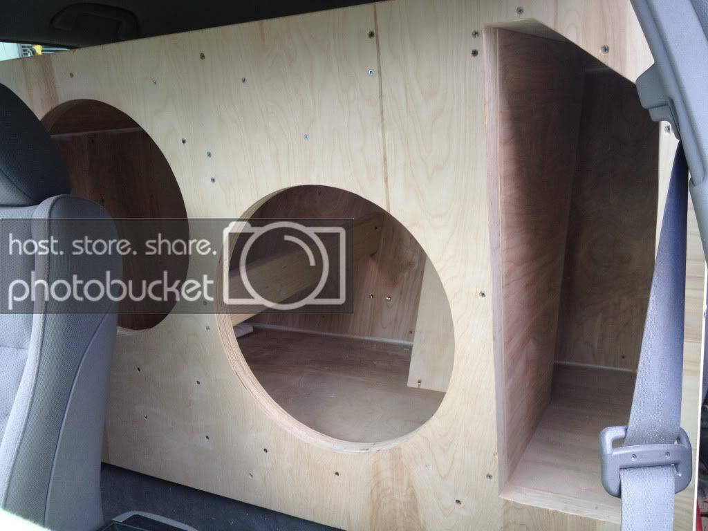

~12 cubes net @ 30hz..
Probably will be covered in the future but for now, staying plain birch. Eventually front baffle will seal with the roof.. He'll be putting in 2 MAF 18's by SPLaudio on an AQ2200..
---------- Post added at 11:41 PM ---------- Previous post was at 11:41 PM ----------
@09civic
attachment.php
attachment.php
