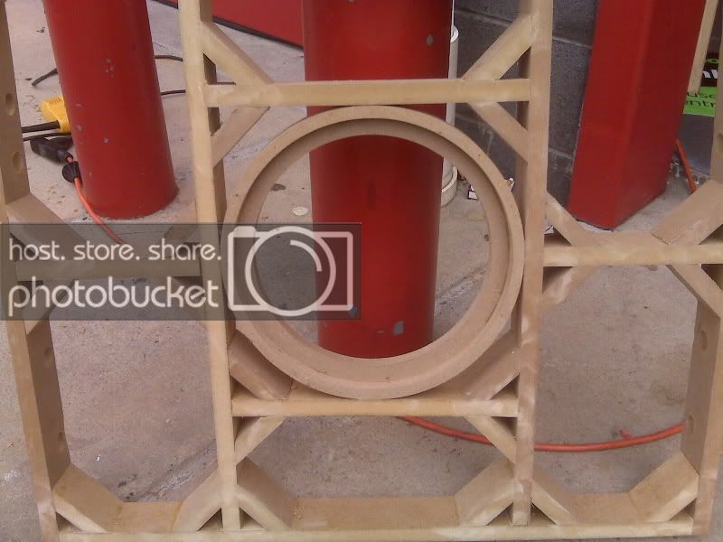

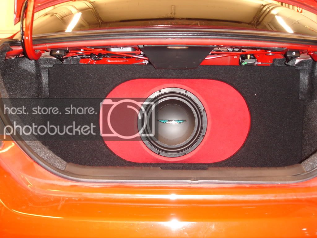

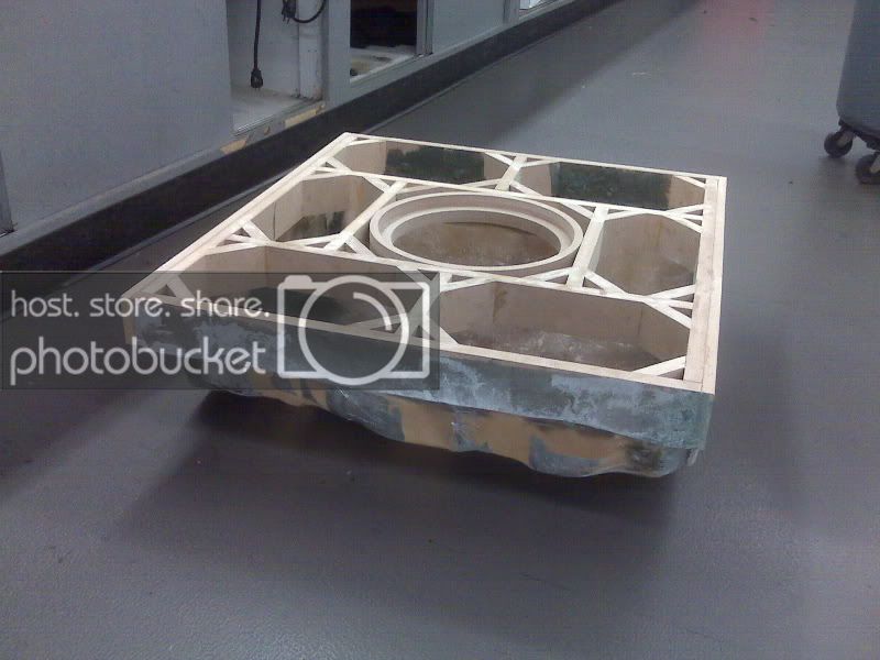

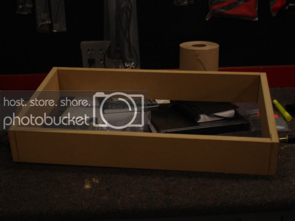

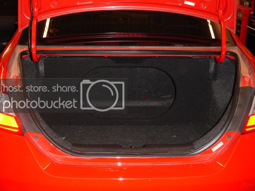

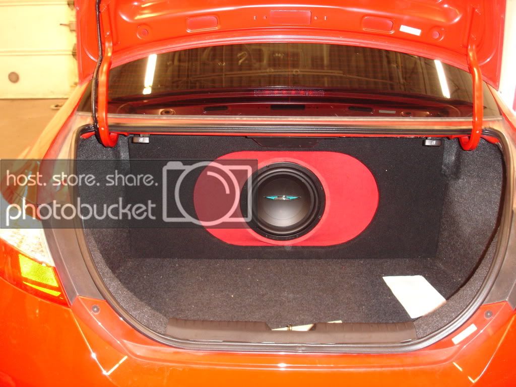

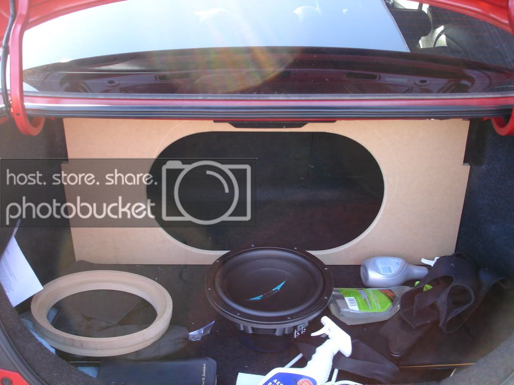

Ok I built this for one of my installers back in March of this year, and I figured that I would share the build.
Her you go

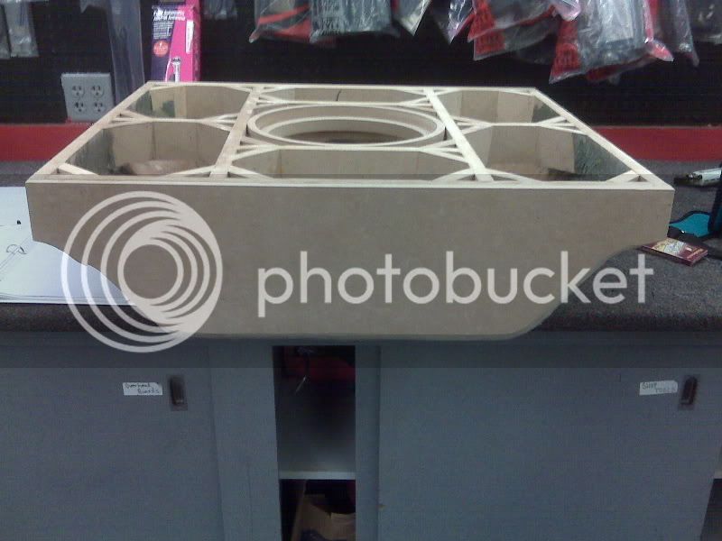

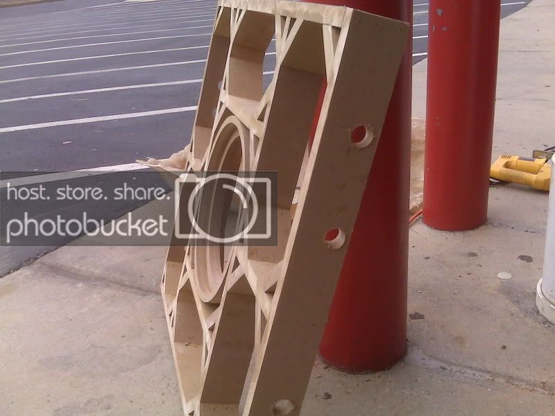

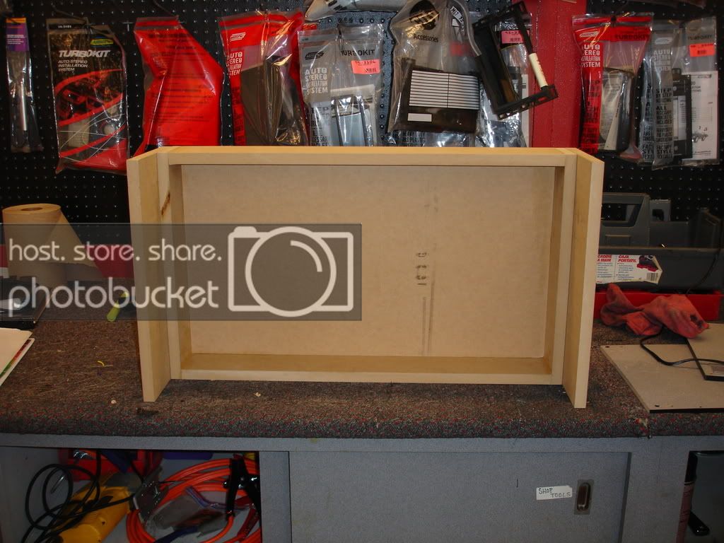

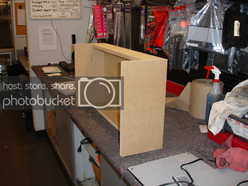

Ok to anwser A few questions first off how the front pice is secured.
This is a picture of the back of the box. The front baffle slips into the outer frame(The taller one) and I glued and brad nailed it together. It was a tight *** fit but that what we like.

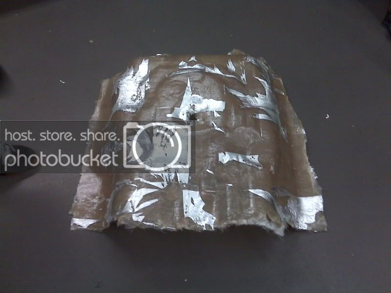

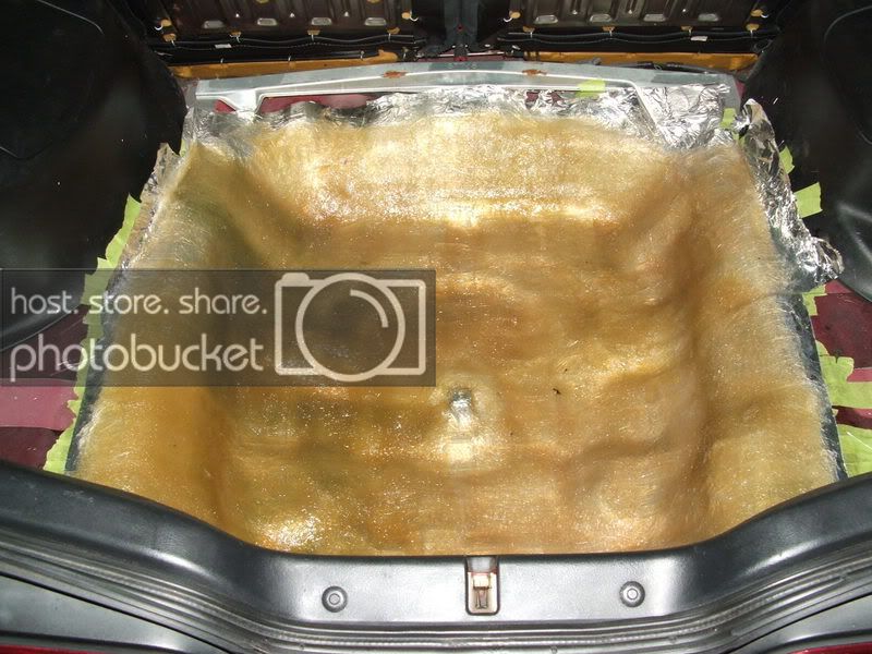

I worked at Circuit City and almost eveyone knew how to do basic box building but no fiberglass work, and yes he did help with the project.

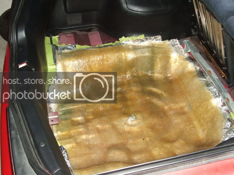

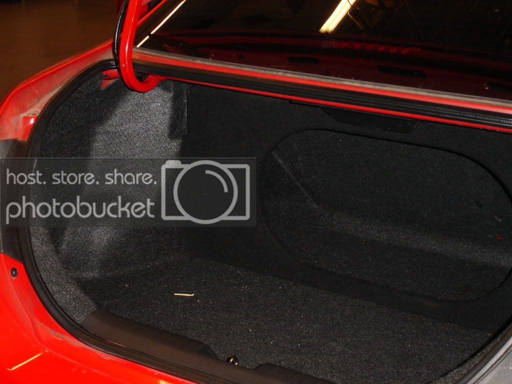

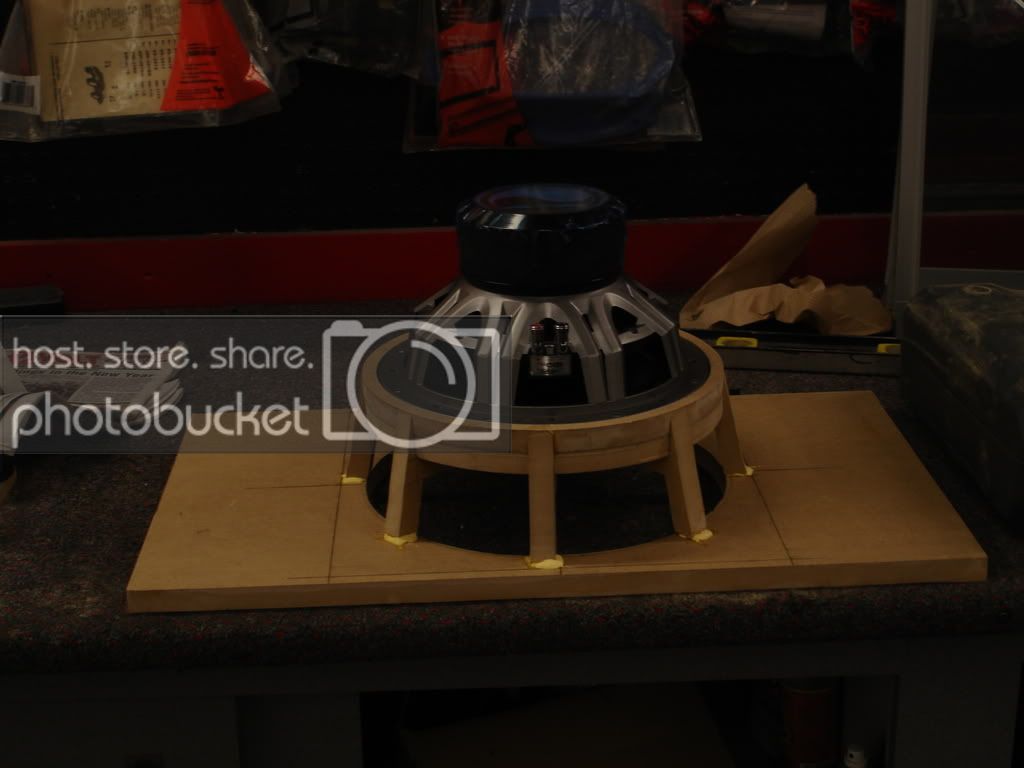

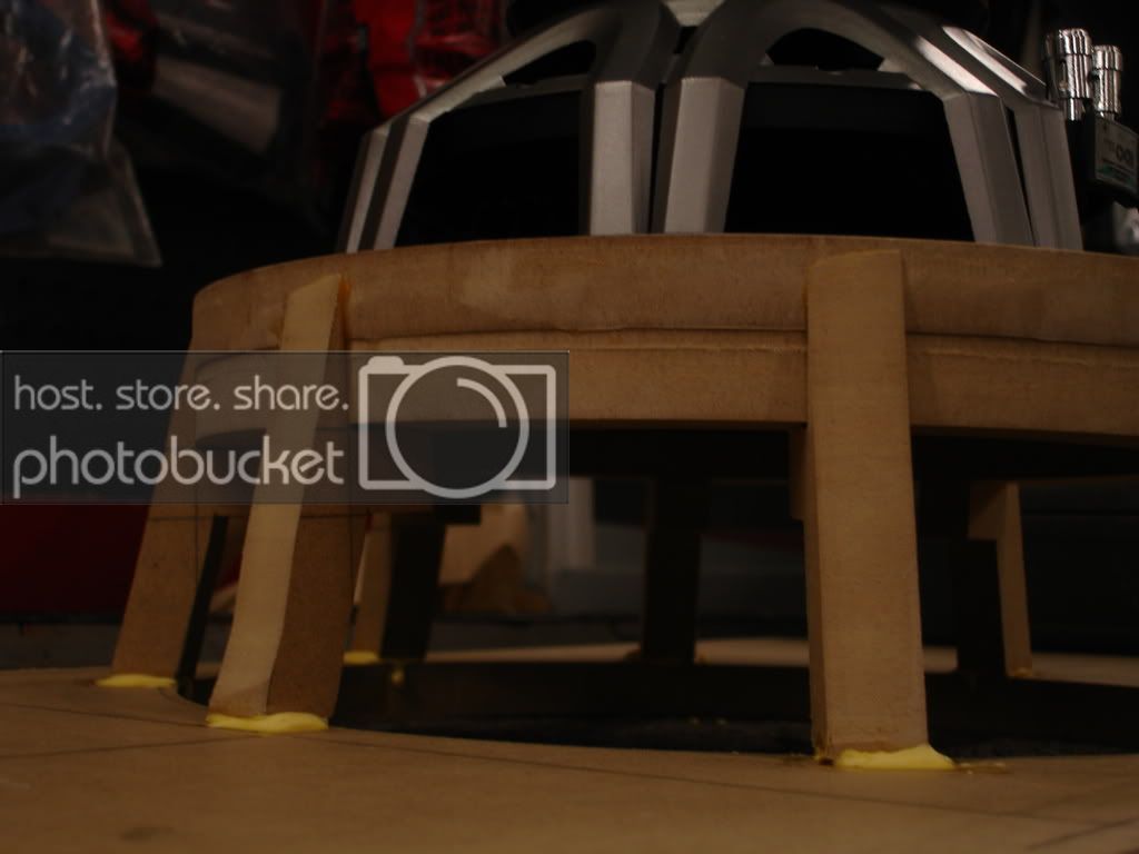

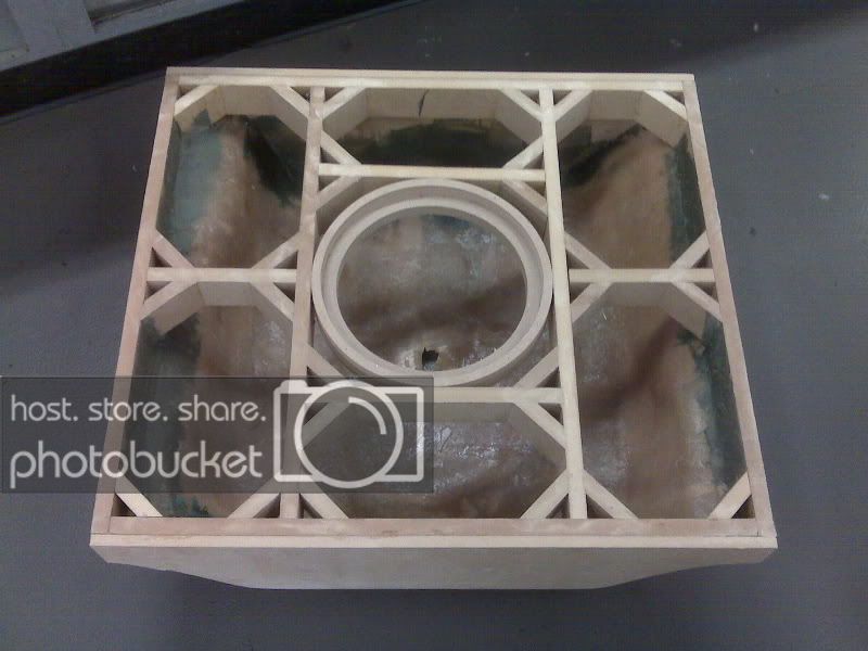

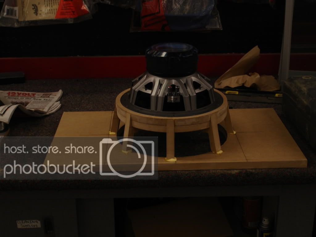

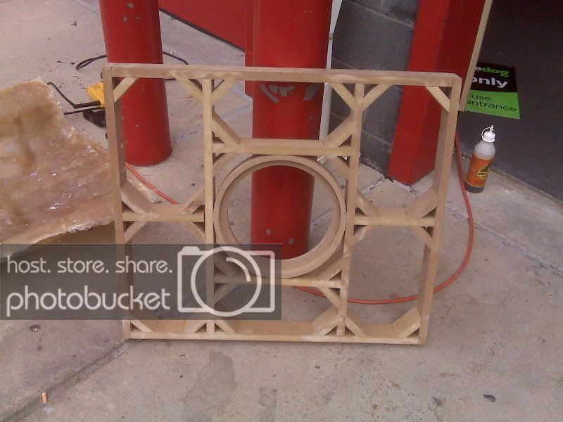

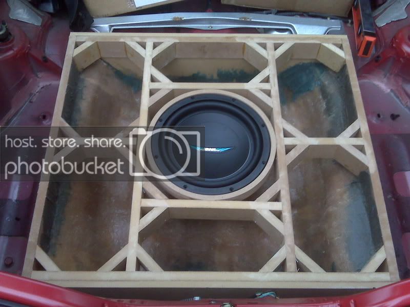

I am working a new build for is 99 Integra. We are using the same sub but doing a spare tire sub box with a false floor. Here are some pics.
