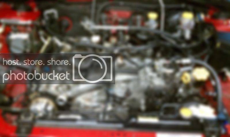

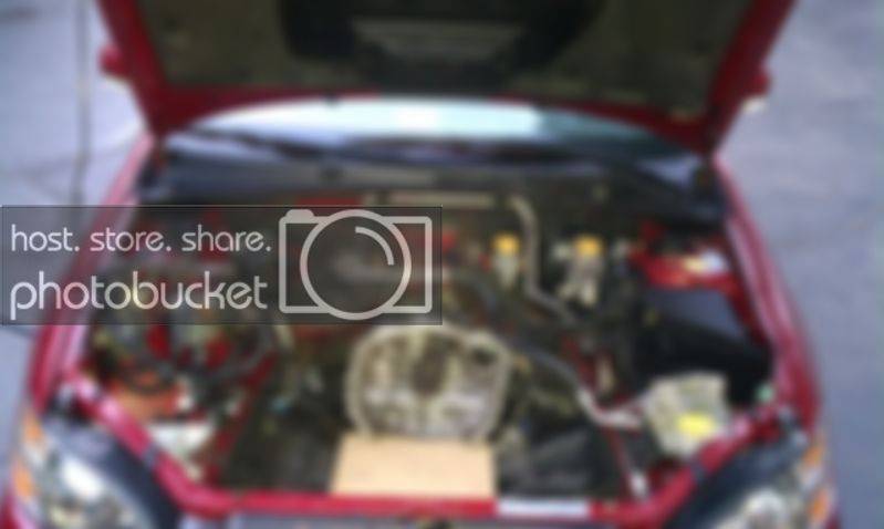

With thhe help of brum tonite we got the a good chunk of the hard part done, **** tubing is a pita. im hoping to have the motor out sometime this weekend or next week and have it looked at to see what all im going to have to replace or if i just basically have to start new. At the end of this im gona make a picture walkthrough of pulling our engines and putting them back in since i didnt find one in a quick search. Enough talk heres some pictures.

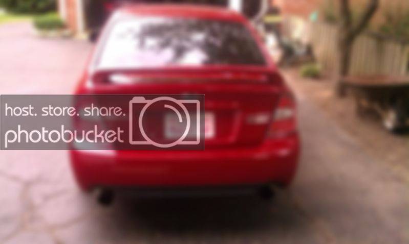

Only mods now is autospeed cat back.

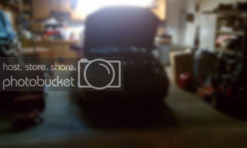

time to get this motor out
how we left it for tonite.

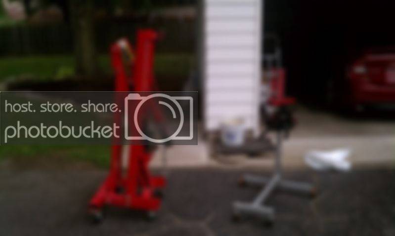

Picked these up today, now we can really get that thing out.
what have we here, or i guess what dont we have here.

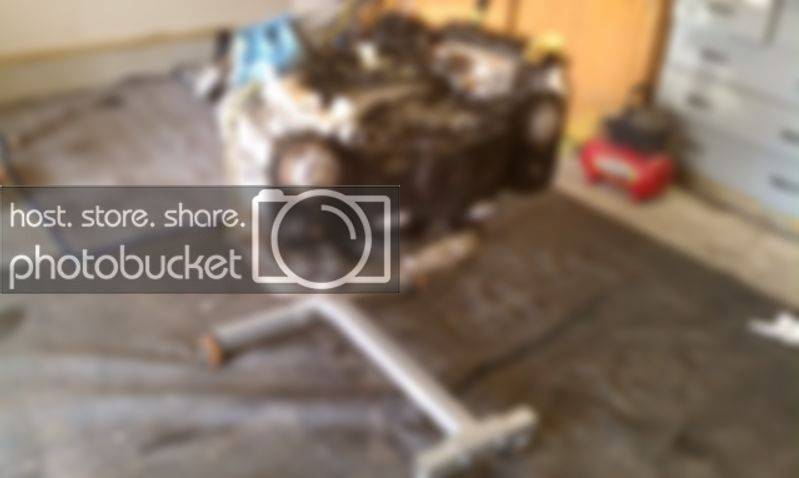

Got it on the engine stand and started tearing it down.

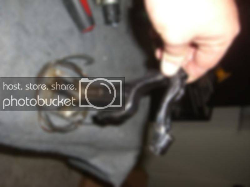

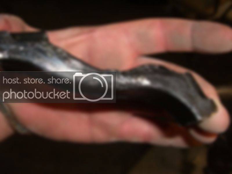

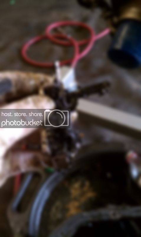

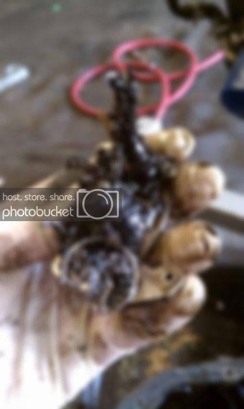

i will do everything that i can with the money i have, first is getting it running with good power, second is making it look pretty. Speaking of pretty, what a nice collection of metal i found in the oil pan. Yes that is a sheered bolt.

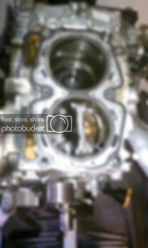

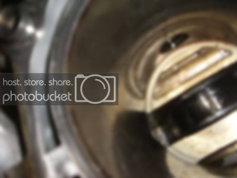

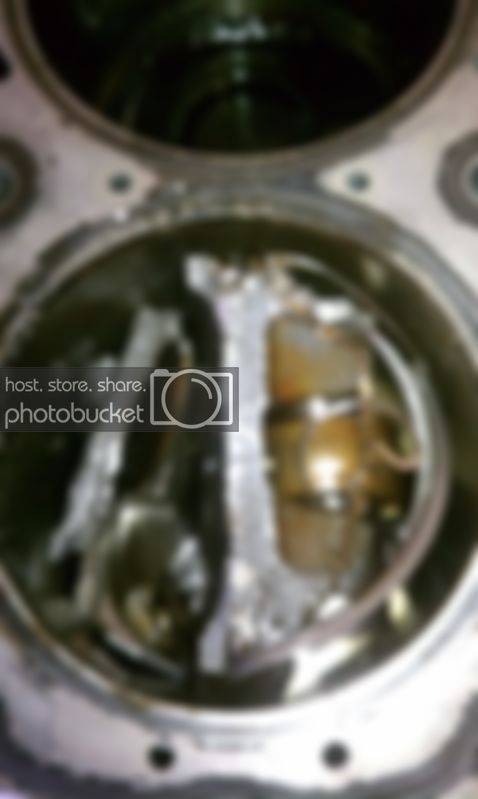

Well i still havent unwrapped the new shortblock cause i have no real reason to yet, however i did get one of the heads off the old block, i took off the one that was on the side the rod disconnected... look what i found upon removal, idk if or how ill be able to get all the shrapnel out to see how bad the cylinder walls are in this block.

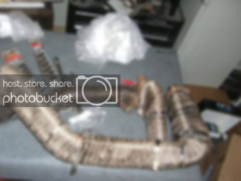

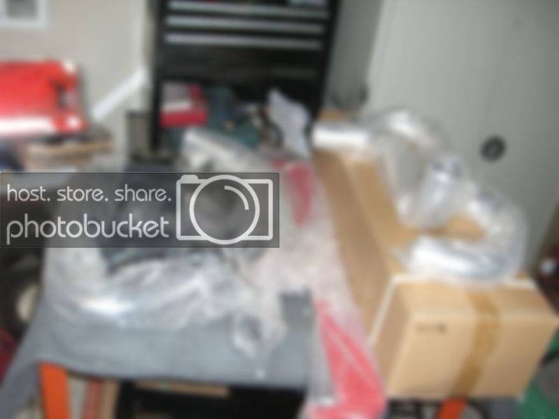

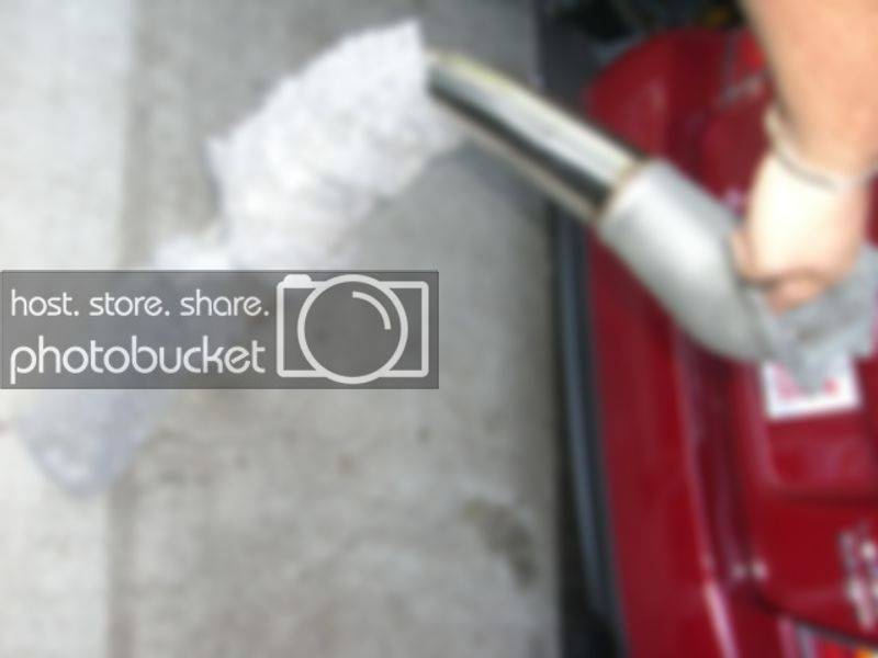

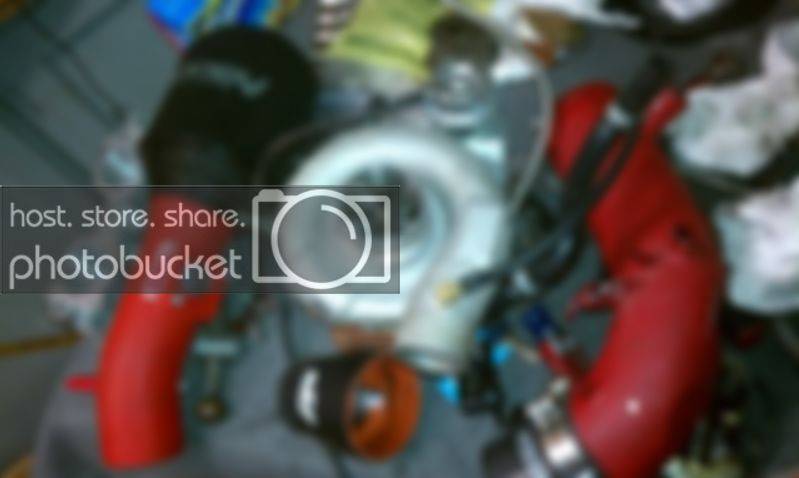

South Bend Stage 2 HD Clutch and 1100cc injectors sitting ontop of my new CNT catless DP.
This thing is a monster i was not prepared for it to be so big (thats what she said)
Heres the intercooler ready for install tomorrow..

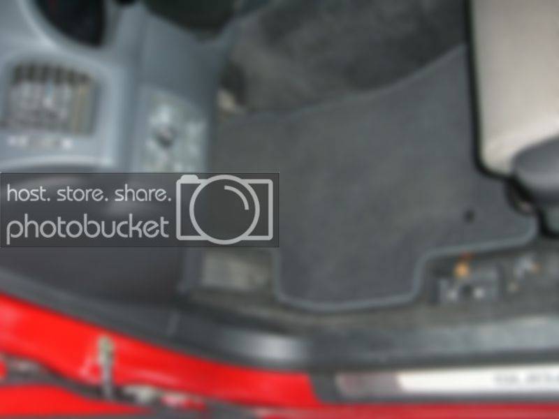

And very sadly this is the only thing ive put on the car since i bought it (oem floor mats since it had none upon purchase)

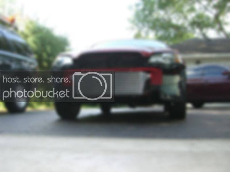

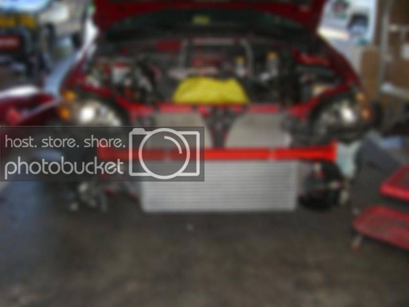

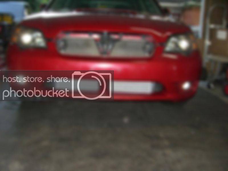

Today i also got my Fast Motorsports FMIC mounted, took a little massaging but its on and im very happy with the quality of it thus far.

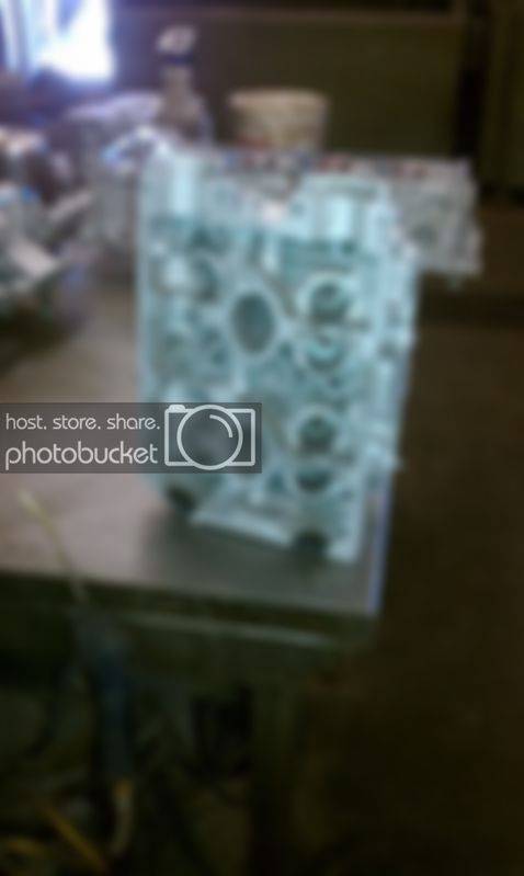

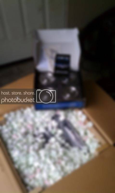

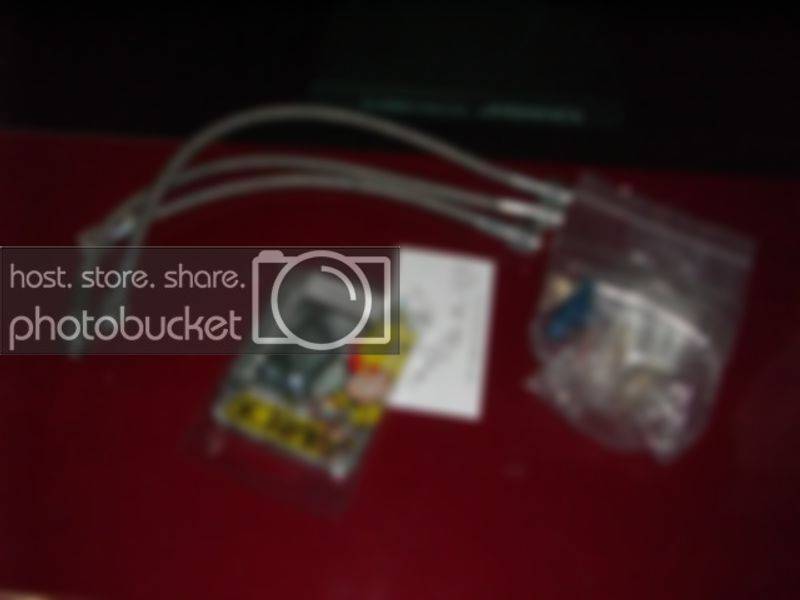

heres some pics of more things ive gotten in

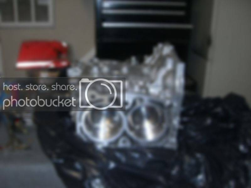

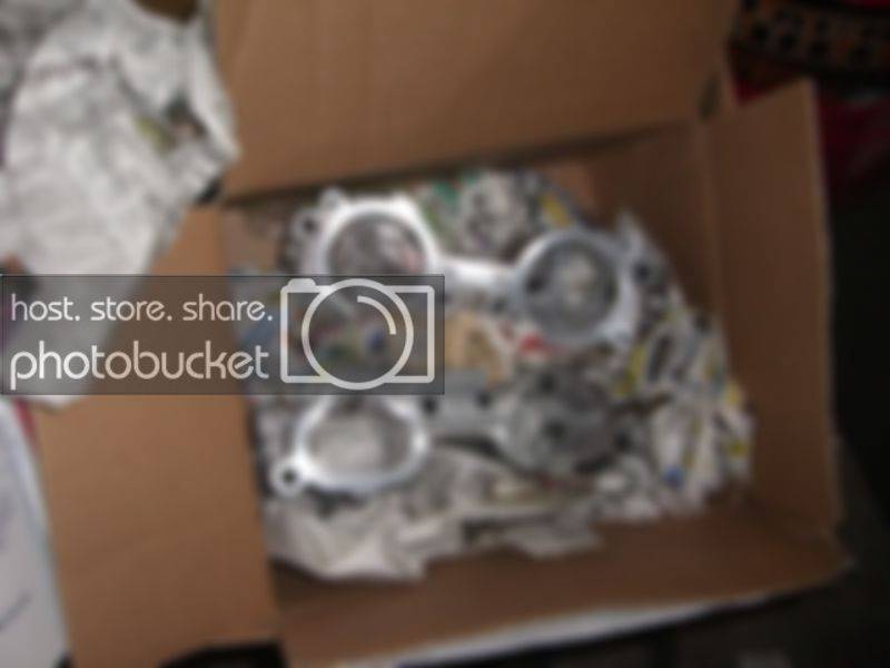

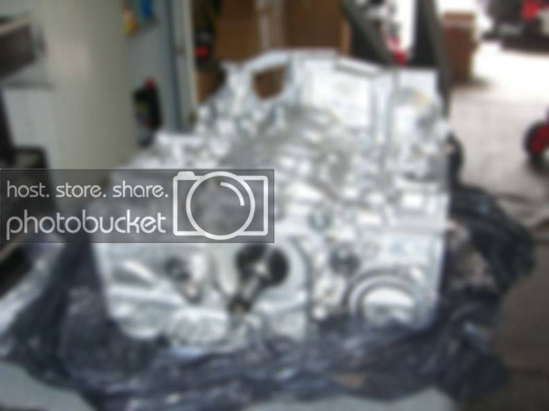

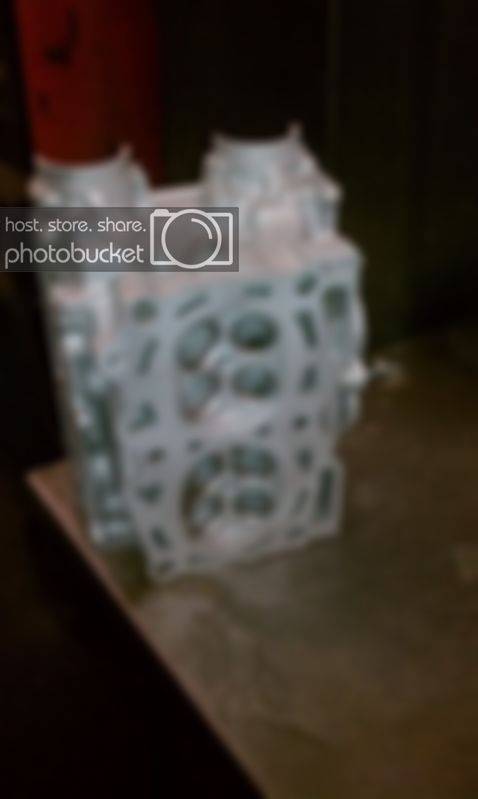

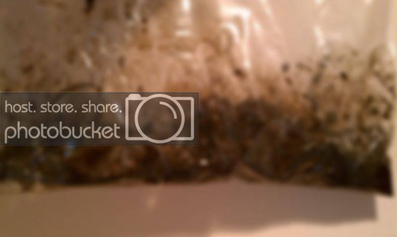

Got the Kartboy Short Shifter installed in like 20 mins which was nice. Also got the fuel pump ready to put back in once the proper o rings come. Did some trimming on the cubby mount to make it fit properly and got the old motor stripped the rest of the way so im ready to take everything to the machine shop once my freaking head studs come in. heres some pictures of the new short block, and the hilarious parts that came out of the old one.

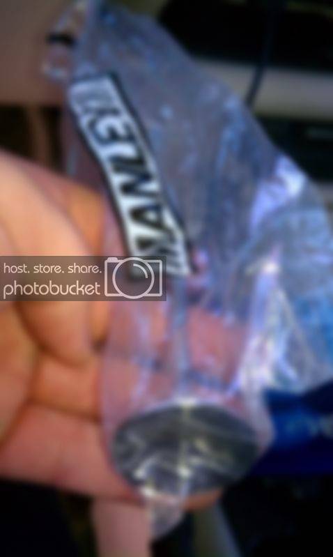

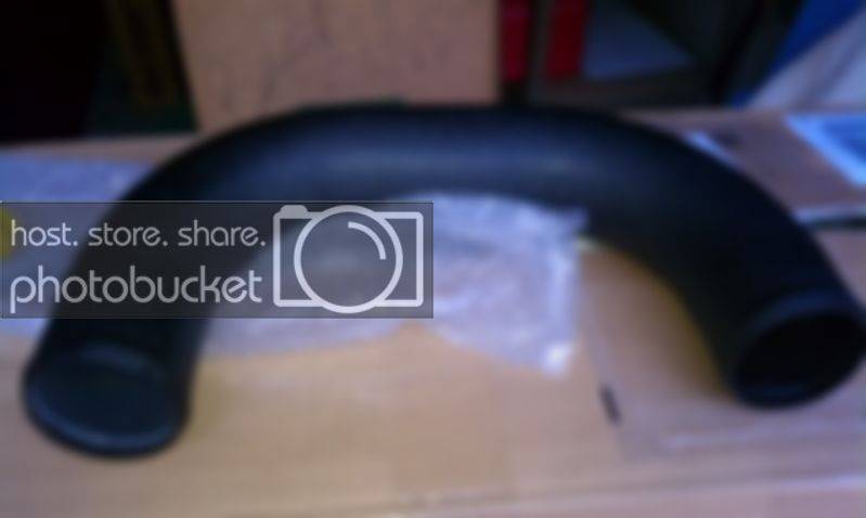

I made it to the machine shop today as i got in my new manley valves and crank pulley so i had to drop them off. Walked in just as they had finished glass blasting the heads, had 6 bent valves in them btw. I also got my FMIC piping back in which Josh and Import Image got done in wrinkle black for me, ive only taken one out so far but it looks awesome compared to the original chrome/polished finish. Enough blabbering

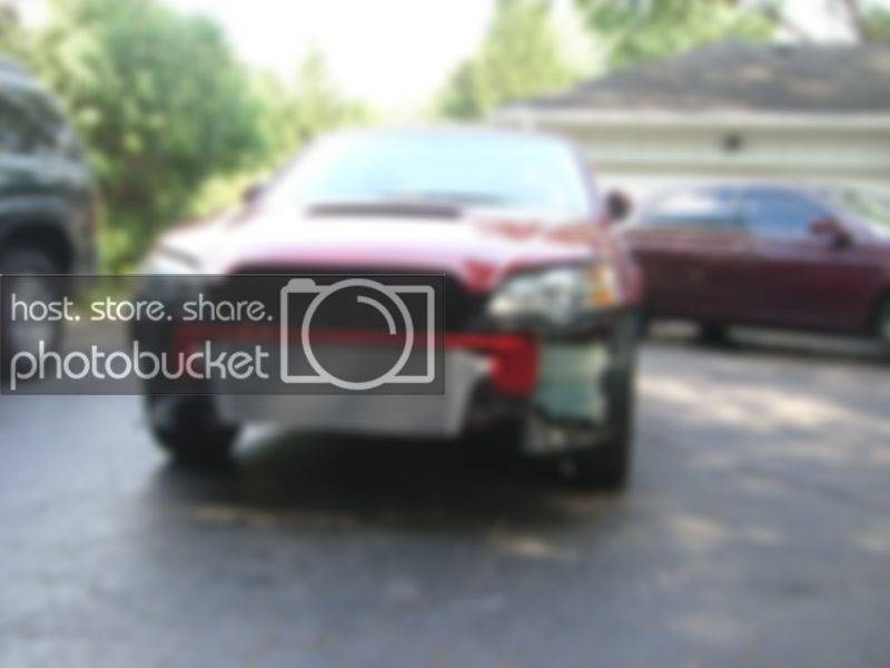

Ran the piping from the front mount into the engine bay and got the bumper trimmed to fit around the FMIC. Took about 10 tries of cut, fit, cut, fit, but it finally went on. I eventually plan on cutting out the lower center support of the bumper and glassing it so that its a nice big opening for the intercooler.

without knowing these cars that well, any idea what caused it? no/low oil? maybe someone ran it HARD!! then returned it to stock? anything in the bay seem like it wasn't stock or like it was modified at one point?
low oil, spun bearing, rod knock, kaboom. Thing must have been eating oil like crazy cause i checked it before i left and less than 700 fairly easy miles later it was off the dip stick. I know it had an aftermarket intake and down pipe but was put back to stock and had the clutch replaced already and the cars only at 58k. All things i never would have known about until i took the car apart.
Did you check for oil leaks before you bought it? checked where it was sitting etc? Cause if the dealer knew he coulda just kept filling it every so often but the pavement won't lie.. Sucks either way.. luckily seems you had enough finances in place to fix it and fix it better than it was
yea i dont think it was leaking oil... i checked under the car before purchase granted it could have been moved or what ever but i think i found the majority of the oil throughout the TMIC, up, dp, cats, etc etc
