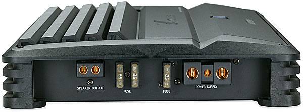

For my MRP-M850 I'll be running Kicker Hyperflex 0 AWG...The MRP-M850 says that the power/ground terminals accept wire up to 4 AWG. Could I strip my 0 AWG and then remove some threads to make it smaller at the end so it fits into the 4 AWG terminal?

highly recommend NO!! there are reducers you can buy, or if you plan to have another amp at any point, they go ahead and get a 1/0 to 4awg distro block
Why do you recommend no? All I have to do to make it 0 AWG again is cut off the half an inch or so that I made smaller and voila its 0 awg again...I just lose like half an inch of wire...
because having a 1/0 that close to the amp will be bulky and may get you too close to the other terminals
Seeing that my remote wire is 18 AWG I think it will work fine:
meh i did it with my lanzars not that big of a deal, jusst id use a distrobution block if you want (i have one i can sell to ya its kicker 0/1-2 4g)
