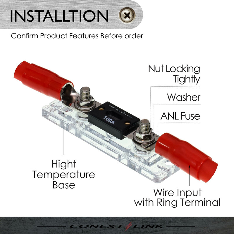

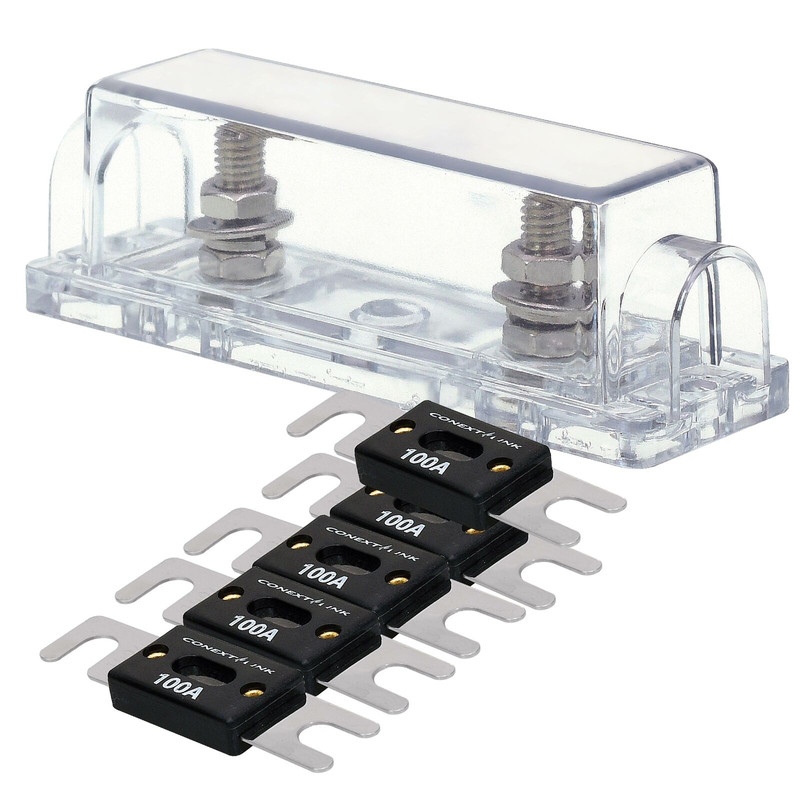

In the event you do buy a new fuse holder, this style below works well. This allows you to get solid contact to the fuse and it won't come loose. There are a few slightly different cover designs of this particular type, only feature I really highly recommend is that it uses ring terminals like the one shown / linked. They make them with set screws (probably like what you have), and while those work too, you can get a better connection crimping / bolting directly to the ring terminals, but you must be able to properly crimp the size ring terminals you need. Then of course secure it properly so it isn't bouncing around under the hood.
So you would buy the fuse holder, correct fuse size for your wire, and a pair of ring terminals.
Not necessarily this one specifically, I mainly chose to link it as it gives a good view. I'm sure it would work fine though, I have a similar pair in one of my cars for the past 6 years and no issues.
